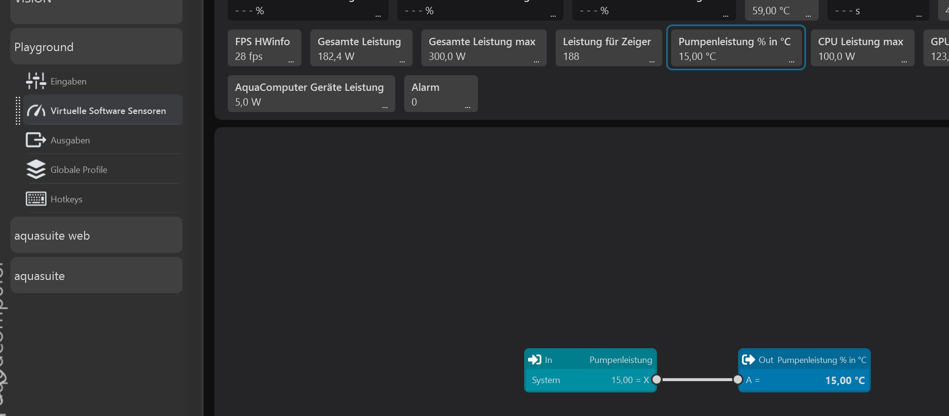

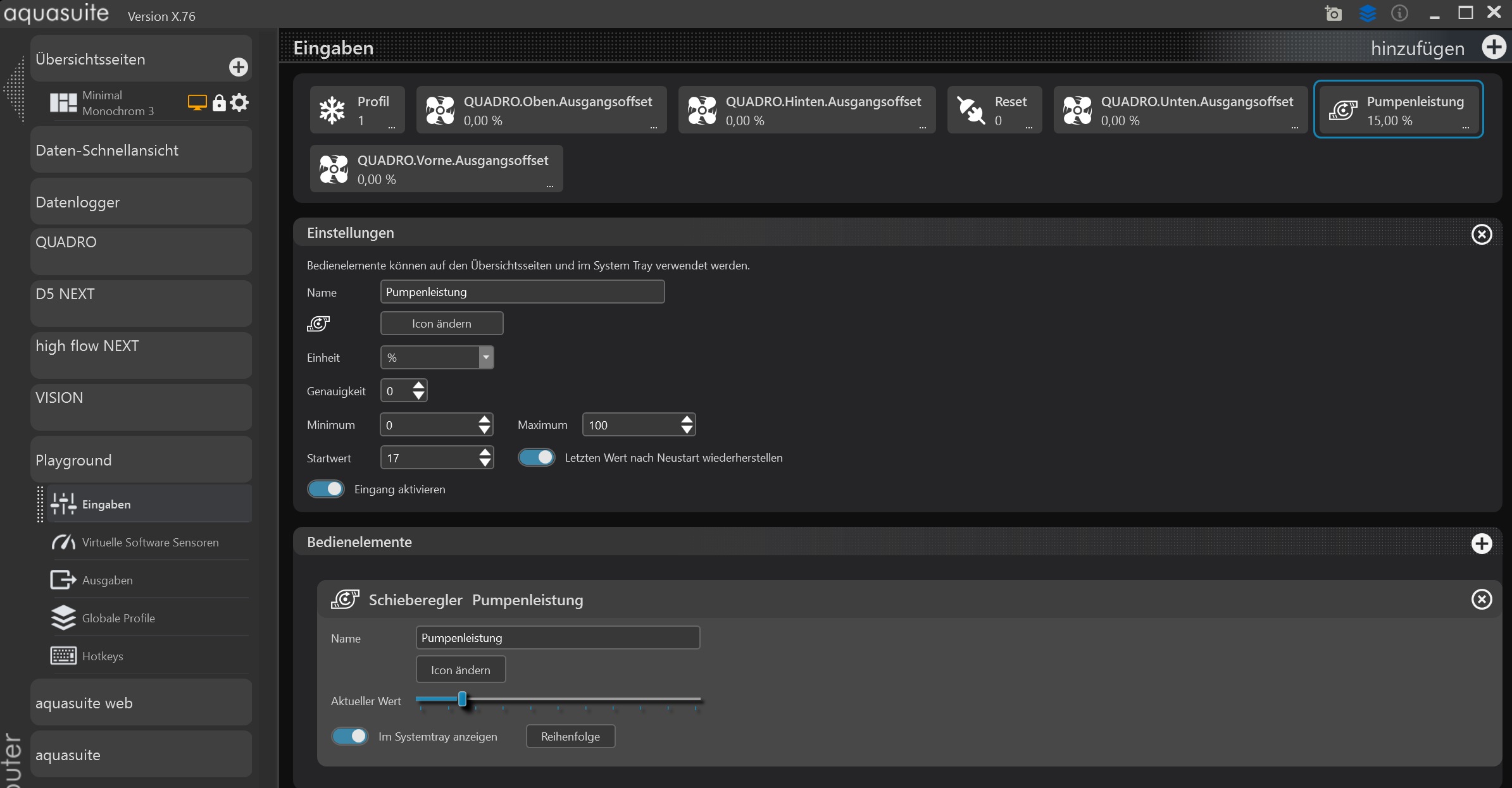

For devices other than the Quadro or Octo it is somewhat more complicated to use "inputs".
For example, I only have the option of setting the speed of the D5 Next via virt. software sensors.
- Add a new input (pump power [%])
- Convert the % into a 1:1 temperature using virt. software sensors
- integrate this virt. software sensor into the d5 Next via one free "soft. sensor"
- Use this temperature as a linear input for the speed of the D5 Next
For other things such as RGB, this should also work in the same or similar way if you can set a temperature to influence it
e.g. for the fan control, instead of using the 1:1 translation in the 2. step of converting the input [%] into a temperature, you can take the CPU temperature as the actual control variable and add the value via "inputs" as an offset.
[attach]10618[/attach]
[attach]10619[/attach]
[attach]10621[/attach]
[attach]10620[/attach]

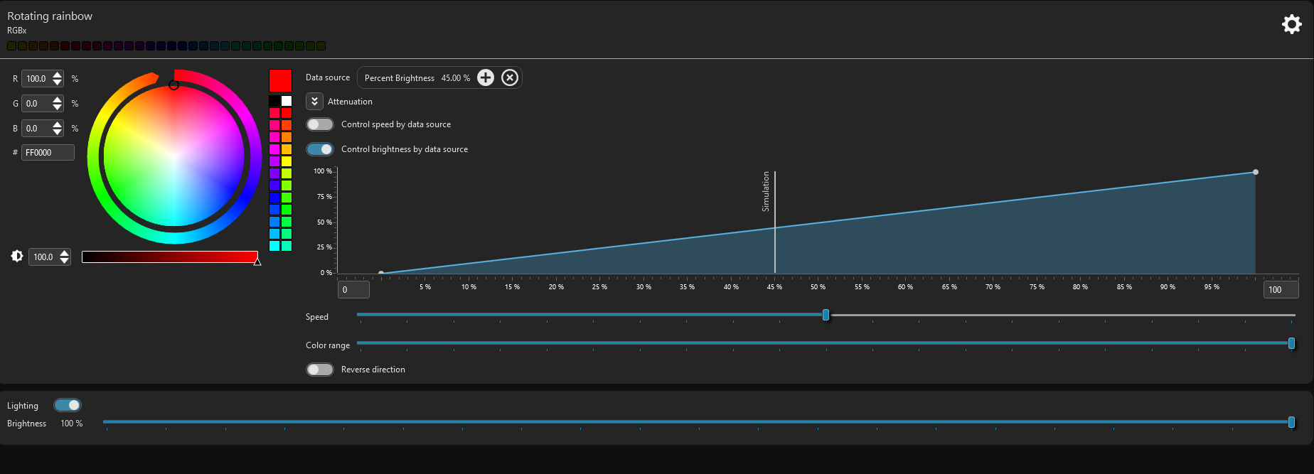

Thank you PvF, I was able to 'simulate' the inputs following your steps. Is there a way to submit a request to Aquacomputer to enhance this functionality?
For RGBx brightness, it's also driven by "Data Source" and therefore limited to the effect that I use. I remember seeing someone was able to configure a slider under "Brightness" but not sure if it was also limited the what effect that person was using.

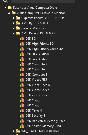

I am having issues losing data in aquasuite. Everything is updated. Latest version. Suggestions?? Thanks
https://i.imgur.com/cc4FJHx.png
Need a data trail to determine what is up:
  • are you pulling the temps with aquasuite's 'Hardware Monitor' or HWiNFO?
  • do you see the temps in 'Data quick view'?
  • what is the one labeled 'temperature' & what is the source?
Hopper64
Samstag, 27. Januar 2024, 17:58
I set it up to provide the data from the aquasuite service itself, not HWinfo. I am not seeing the temps in the data quick view. The one labelled temperature is the SSD temp. Looks like the aquasuite service is not polling those values. I am going to reenable them and reboot. Thanks.

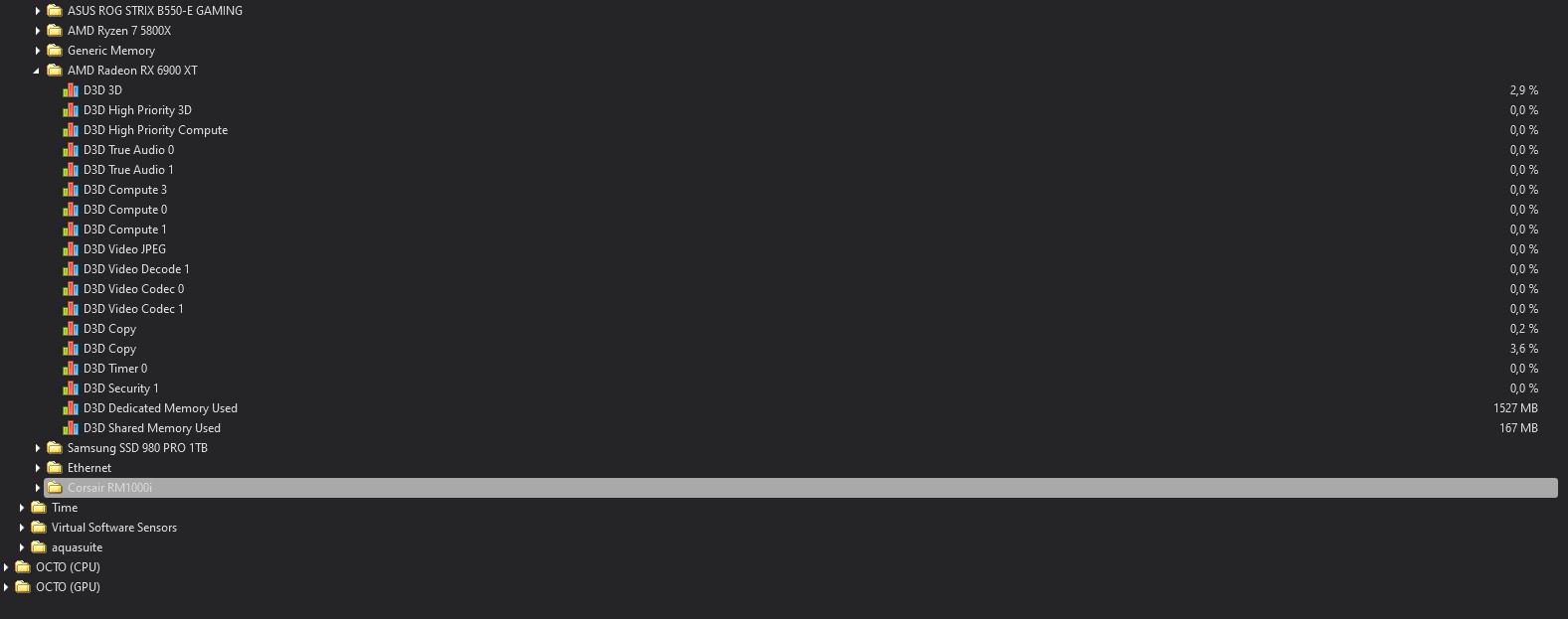

I am still missing all the temperature of my graphics card (6900xt) after the last update. Enabling/disabling gprahics card under hardware monitoring doesn't make a difference.
User "sBronco" had the same problem with his RX 6900 XT -> thread in german
He was able to solve the problem by reinstalling aqua suite
Montag, 29. Januar 2024, 08:52
If you stop the service once from the aquasuite after installing the new (GPU) drivers and then restart it, it also works.
This must be done directly from the aquasuite.

Thanks, stopping and restarting the service worked.

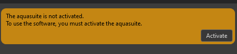

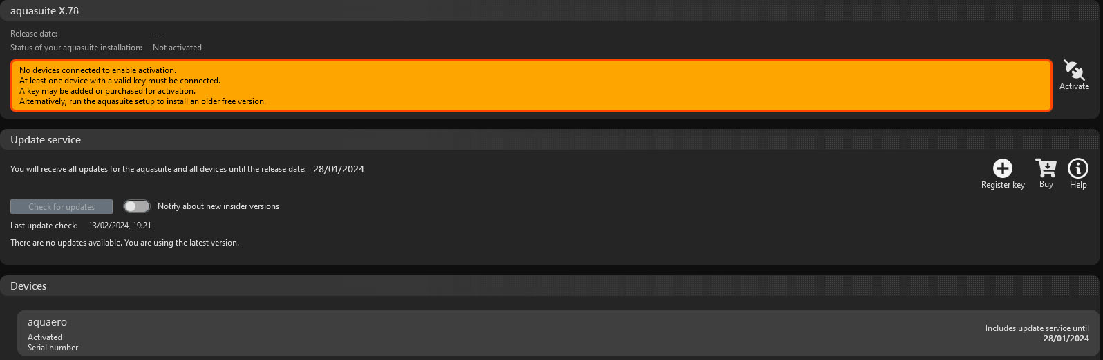

Hello,
Hmm, sadly after updating to X.78 looks like Aquasuite is unable to check activation.
Yes, I updated without reading the Balloon Tip on the update. (I remember that it mentionned activation or key).
By the way, I thought that the install already installed .NET Framework 8 but after rebooting the pc it looks like not. So It's now installed.
Clicking Activate doesn't do anything.
Trying to re-register the key doesn't work, because it's already activated.
Aquasuite Service is running.
Changelog doesn't mention anything about this issue.
What did I miss?
Thanks,
Ok, well, I tried to reinstall Aquasuite :
https://imgur.com/a/Q92Z3Ny
?( Does it means that spending money after install is mandatory?
Are you serously starting a pay per install scheme?

Dundys
Donnerstag, 15. Februar 2024, 01:45
It looks like your subscription is expired in January so you cannot update to X.78, but you should be able to reinstall to the latest prior to your expiration date which is X.77
