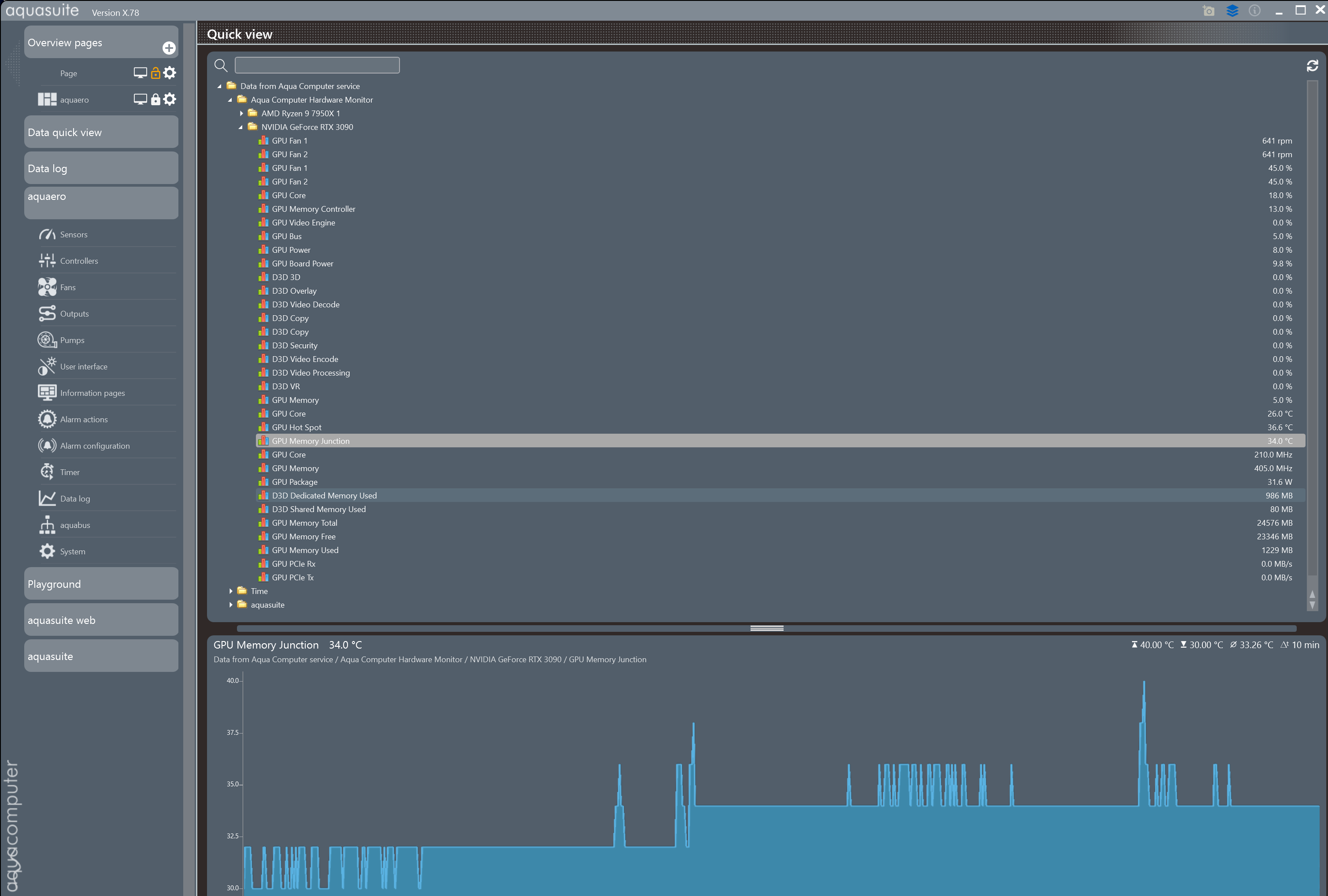

Hey, just want to confirm that I'll need AIDA or HWINFO if I want to monitor GPU Memory Junction Temperature for my 4090? It's not available from Aqua Computer service on my end.
Dundys
Dienstag, 5. März 2024, 07:33
You shouldn't need any of the above, you should have that reading within aquasuite
»Dundys« hat folgendes Bild angehängt:
mditsch
Dienstag, 5. März 2024, 08:40
it seems to be different for the NV4090:
Dundys
Mittwoch, 6. März 2024, 06:04
I thought It would be the same, obviously I was wrong ;)
Mittwoch, 6. März 2024, 21:32
I recommend using HWINFO for all system sensor polling. I have all hardware monitoring in AQS disabled and import all the system sensor data from HWINFO via the shared memory interface. IMO, this is the best way to do it. While AQS can monitor some hardware directly, it is not the primary purpose of the software. Monitoring sensors is the primary purpose of HWINFO, and it does it very well. It reports a lot more data than AQS, and it is updated much more often to keep up with new hardware (like the RTX 4090), drivers, and Windows updates. In 2023, AQS was updated 12 times, 10 of which included updates to hardware monitoring. AIDA64 was updated 4 times. HWINFO was updated 51 times, and every one of those updates added support for new hardware and/or other enhancements. Also, I trust that HWINFO always locks the sensor it is polling via a mutex or other appropriate locking mechanism. Some software does not lock the sensors which can result in polling collisions. Corsair iCue is a prime example. I think AQS also properly locks the sensors while polling but I am not 100% sure this is true in all cases.

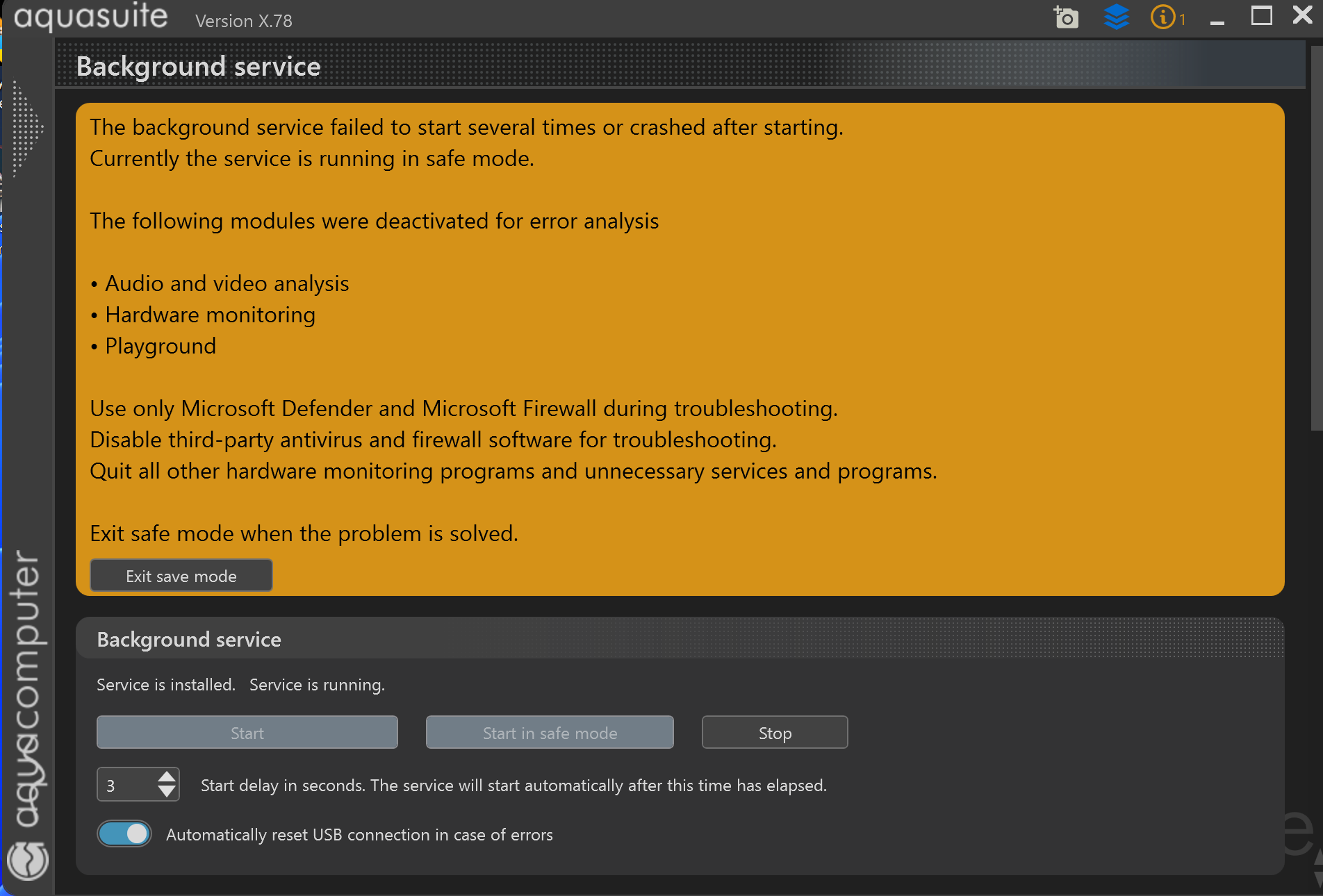

Mittwoch, 3. April 2024, 03:54
Hello. I get the message below when I open AQ Suite and click on the AQ6 tab.
"The background service failed to start several times.
The service is currently running in safe mode."
When I click on "change settings" I get the message below.
What is happening? I'd appreciate any help correcting the issue.
Thanks...Al
"Never be afraid to try something new. Remember, amateurs built the Ark, professionals built the Titanic"
Dundys
Donnerstag, 4. April 2024, 15:49
Your guess would be as good as anyone else why this happening. Aquasuite is the heart of aquacomputers hardware control, rich in functionality software, but you among ton of other users dealing with this issue absolutely the weakest link. "Aqua Computer Service" fails to start so often while on either PC boot-up or just stops out of nowhere. I have been using aquasuite for a long time and this is not uncommon, you need to learn to live with it or drop the software. I was looking at alternatives e.g FanControl, amazing fan control software as well, but not without it's own issues and also, it controls only fans so for now we wait to see whats next.
FYI.
Put it this way! If aquacomputer developer(s) can't permanently fix and stop that from keep on happening, then average Joe is out of luck.
Dieser Beitrag wurde bereits 3 mal editiert, zuletzt von »Dundys« (4. April 2024, 18:58)
