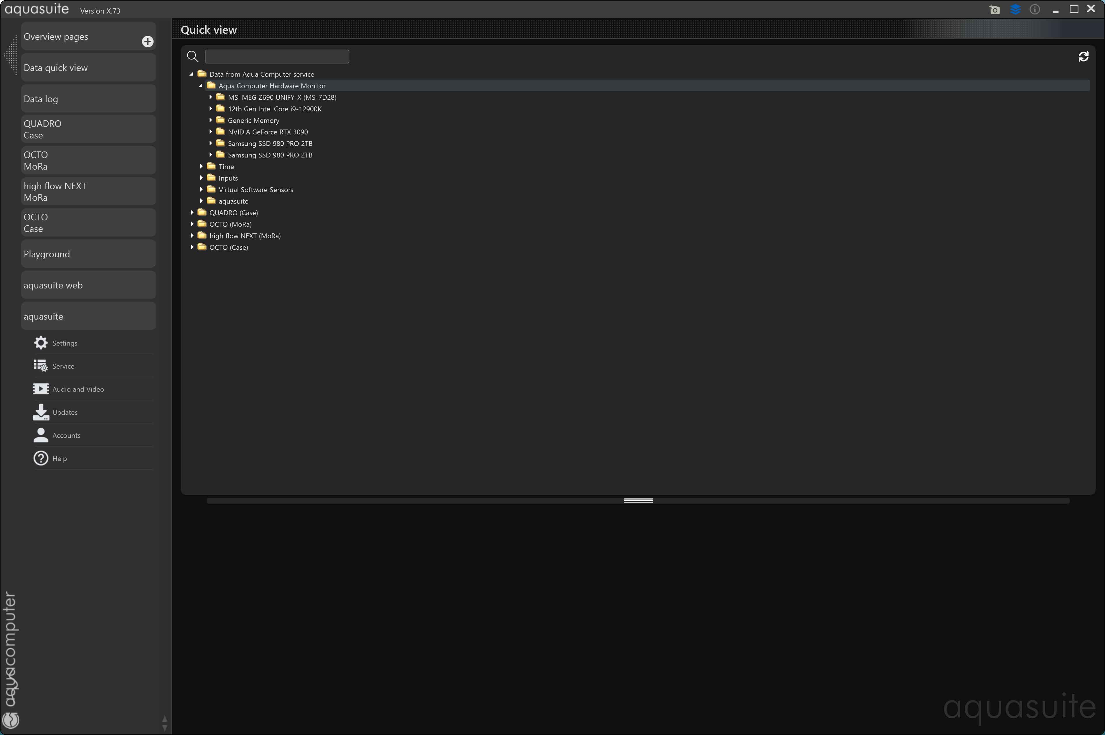

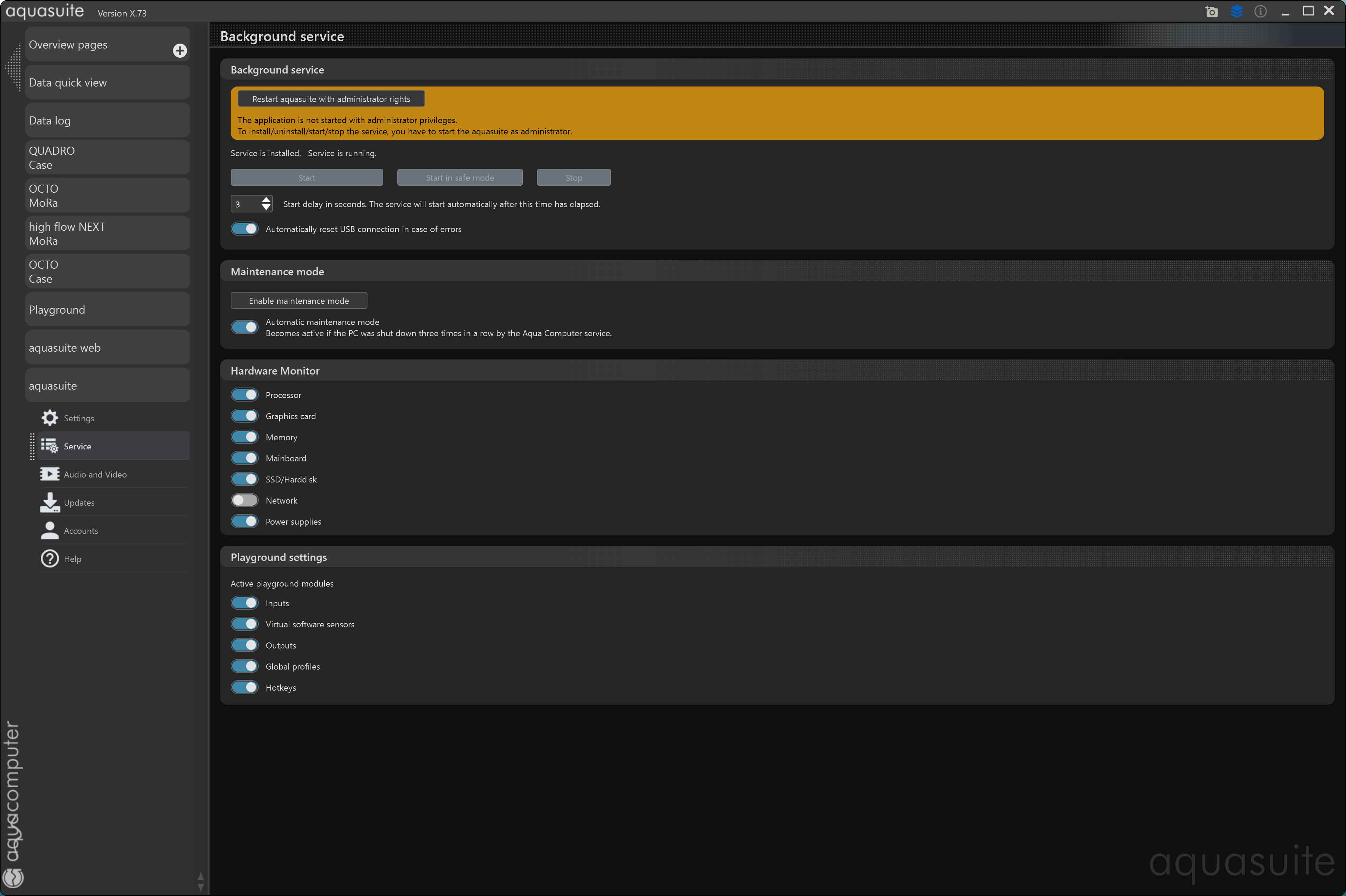

Noticed an update to hardware monitoring, not sure if it was related to PSUs, but my AX1600i is still not captured. I closed HWiNFO so there would be no conflicts.
Donnerstag, 31. August 2023, 03:10
[attach]10427[/attach] > [attach]10428[/attach]
Did AQS used to be able to monitor the AX 1600i and stopped, or has it never done it? I know SIV can import data from the AX 1600i and I think HWINFO can. If it does, you can just import the data from HWINFO if you are using the Shared Memory Support feature. I import everything from HWINFO and disabled all hardware monitoring in AQS.
I recently looked at Corsair PSUs. There are still a few that have USB ports, but not many, and they are older models. I think the AX 1600i is the only one rated for over 1KW that has a USB port. IMHO the AX 1600i is one of the best PSUs Corsair ever sold, but I am kind of surprised they are still in production. I forget who the OEM is – do you know?
I guess PSU stats reporting is not a high-demand feature, which confuses me. The PSU is a CRITICAL component of a computer. To me, monitoring the PSU is a must-have feature. Most brands don't have any kind of monitoring, which really limits the choices.I took a chance and bought a Thermaltake iRGB Plus 805W PSU last time around, solely because it has a USB port on it. Thermaltake’s software is atrocious but SIV and HWINFO can both monitor it. I would normally not pick Thermaltake for a PSU, but it works fine.

Donnerstag, 31. August 2023, 05:45
The devs recently added PSU monitoring, I'm just giving feedback Previous discussion
