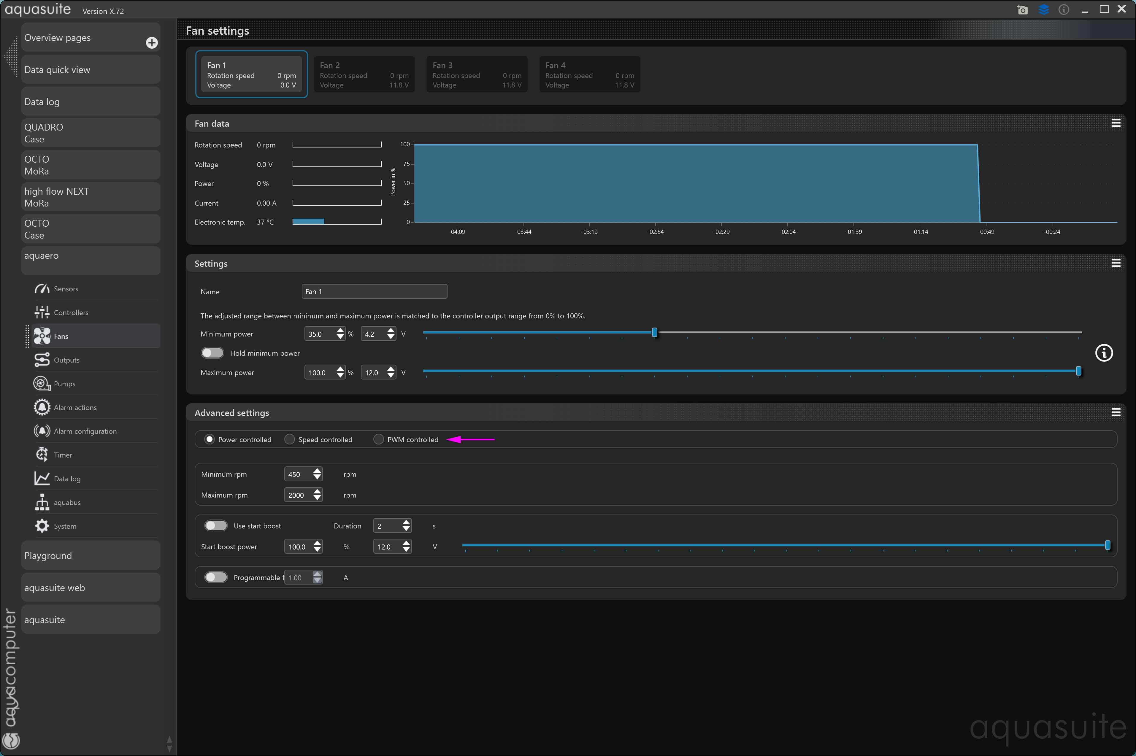

I installed X.72 tonight after a rebuild and a refresh. I'm trying to find where the ability to change from 4-pin fans to 3-pin pans have gone to. I used to be able to switch from power controlled and PWM controlled in the advanced system settings, but they've disappeared, so I don't know what to do. It would be good to get my 3-pin fans controlled again.
Montag, 21. August 2023, 03:42
Hey there.
Under the 'aquaero' click on the 'Fans' tab, select the fan port you want to setup, and drop down to 'Advanced settings'. [fan_control.jpg]
Edit: note to Devs, at the bottom of the advanced section 'Programmable fuse' is partially covered by the input box.
Dieser Beitrag wurde bereits 1 mal editiert, zuletzt von »InfoSeeker« (21. August 2023, 03:48)

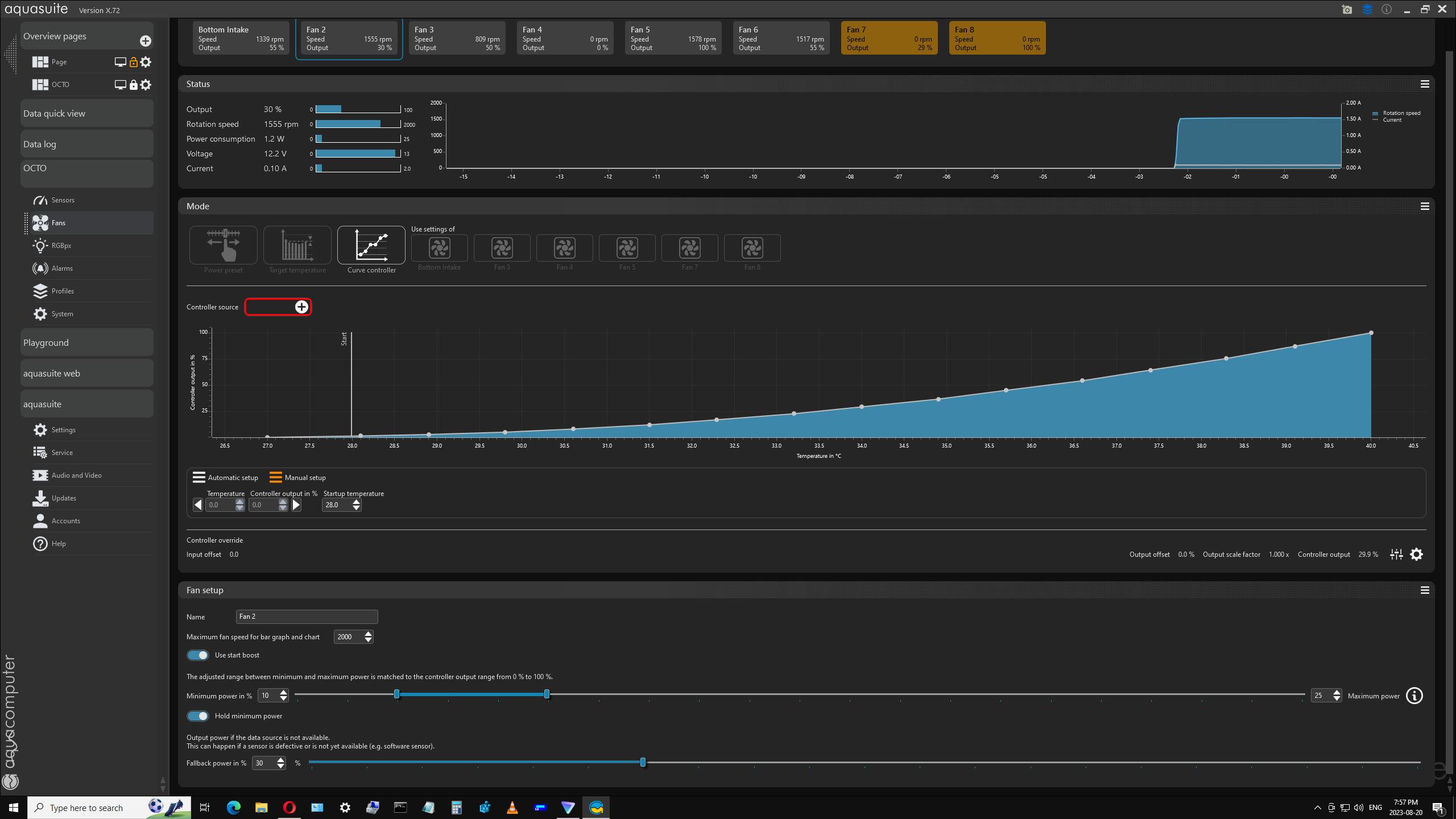

It used to be there under the OCTO tab, but it's now gone. All I see is "fan setup", and what I can change is what you see here.
I believe the octo and quadro have always been PWM only.
Remayz
Montag, 21. August 2023, 10:13
Octo can't control 3 pin fans, at all. they are purely PWM controllers. Only the Aquaero and Poweradjusts can do that.

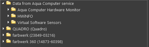

I noticed that after the installation of aquasuite72 I have frequent losses of data obtained from "aqua computer service". They disappear completely and then reappear after a while in an endless cycle.

Can you provide more specific information? What exactly do you mean by "data obtained from aqua computer service"? Is the data disappearing in Aquasuite or in some other program?
Asso
Donnerstag, 24. August 2023, 16:35

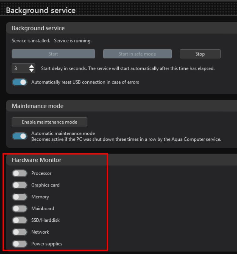

No more data from aqua computer service appears.
»Asso« hat folgende Bilder angehängt:
Donnerstag, 24. August 2023, 19:07
No more data from aqua computer service appears.[/size]
Data from Aqua Computer Service appears in both of your screenshots. In the second screenshot there is no Aquacomputer Hardware Monitor section under Data from Aqua Computer Service. Is this what you are referring to? If yes, you have to have at least one item enabled in the Hardware Monitor section of the Aquasuite Service tab. If none of the 7 items are enabled, the Aquacomputer Hardware Monitor section will not appear in the Select Data Source screen. On my system it take a few seconds after enabling a Hardware Monitor item for it to appear in the Data Source screen. If you do have at least 1 item enabled in the Hardware Monitor section of the Aquasuite Service tab, and the Aquacomputer Hardware Monitor section does not appear in the Data Source screen, then there is something wrong. It may take a few seconds for it to appear.
Around the X.50 days, they could. It was a selling feature they had on their website back then. It's a shame that it can't do that anymore; it was a really nice feature.
I got a few PWM fans to replace the voltage controlled ones, and now port 2 and port 4 don't report PWM speeds. They're the Arctic P12 fans. If I put my 3000rpm Noctua industrial fans and NHD15 stock fans on those ports, it reports it just fine. If I put the P12s on any other port, it reports it just fine. Port 6 has a P12 on it and it reports the RPM as normal. I can still control the fans just fine, though. It would just be nice to see the RPM number there.
Sonntag, 27. August 2023, 19:49
The ability to control fans by voltage requires a physical voltage controller, which has never been part of the octo or quadro.
Regardless the aquasuite version, it will not have the ability to control that which is not there.
