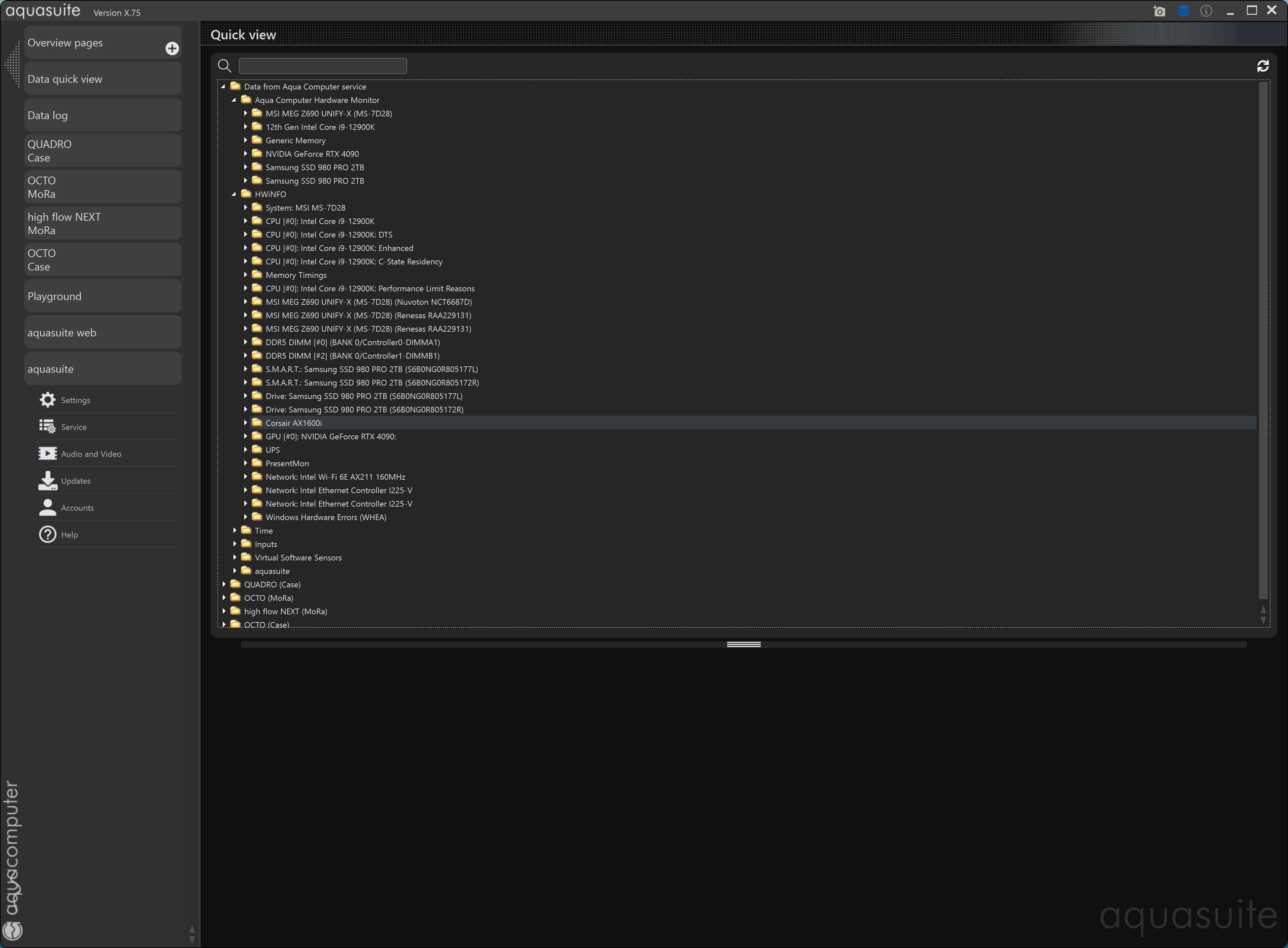

Do not know what was addressed with Hardware Monitor for x.75... but AX1600i not detected (harware_monitor.jpg)

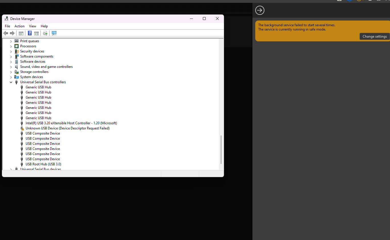

Dienstag, 19. September 2023, 07:20
Anyone knows how to fix this?
Came with X75.
If I disable the "Unknown USB Device" and enable it again it works for some time (sometimes minutes, sometimes hours)
Thanks
»hexxcode« hat folgendes Bild angehängt:
Dienstag, 19. September 2023, 09:43
Came with X75.
I'm sure it was before, this has nothing to do with aquasuite, just Windows.
Update your chipset drivers and maybe your bios.
