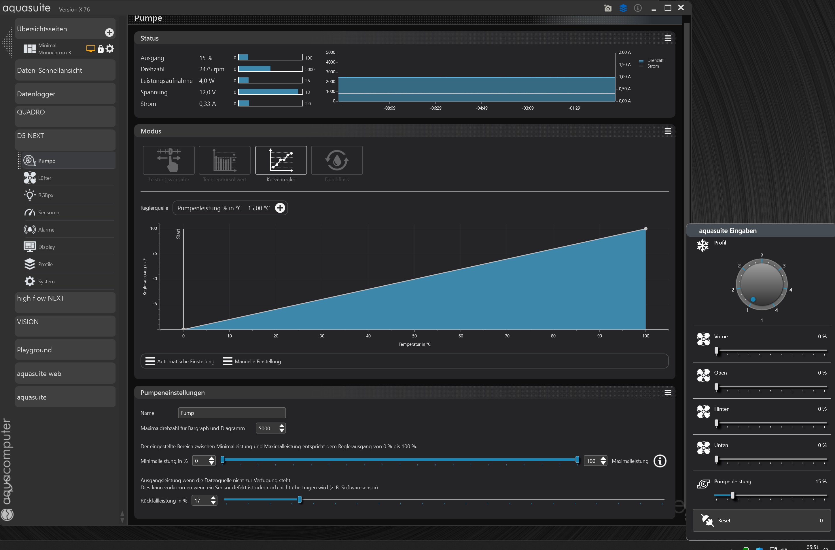

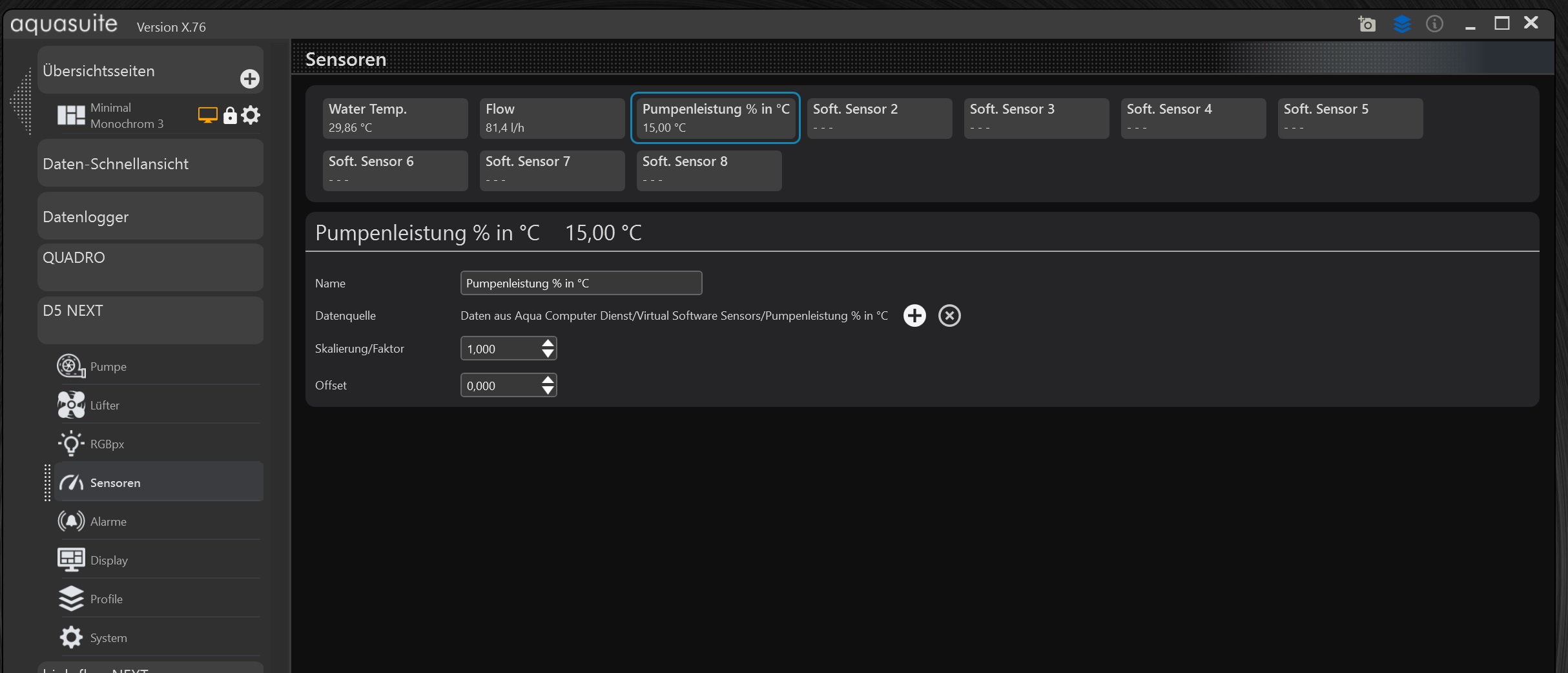

For devices other than the Quadro or Octo it is somewhat more complicated to use "inputs".
For example, I only have the option of setting the speed of the D5 Next via virt. software sensors.
- Add a new input (pump power [%])
- Convert the % into a 1:1 temperature using virt. software sensors
- integrate this virt. software sensor into the d5 Next via one free "soft. sensor"
- Use this temperature as a linear input for the speed of the D5 Next
For other things such as RGB, this should also work in the same or similar way if you can set a temperature to influence it
e.g. for the fan control, instead of using the 1:1 translation in the 2. step of converting the input [%] into a temperature, you can take the CPU temperature as the actual control variable and add the value via "inputs" as an offset.
Dieser Beitrag wurde bereits 2 mal editiert, zuletzt von »PvF« (8. Januar 2024, 06:41)
[attach]10621[/attach]
[attach]10620[/attach]
