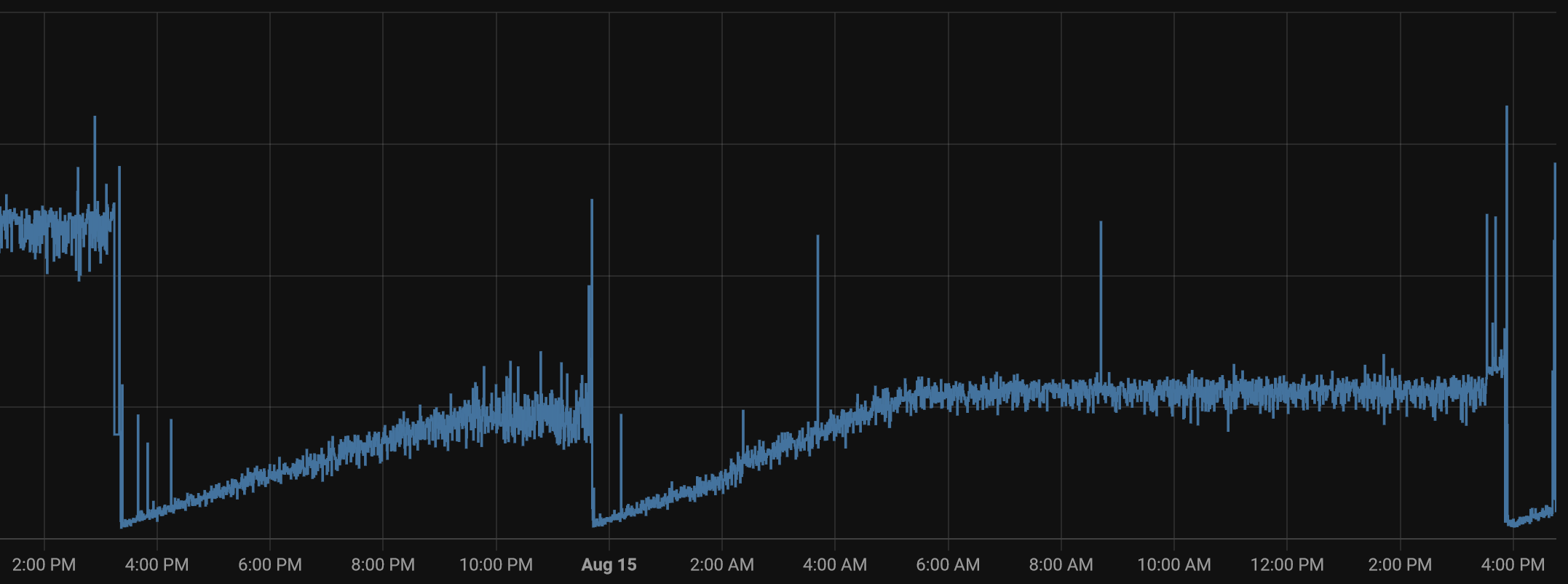

I've been running X71 for a few hours, but sadly the high CPU usage in Aqua Computer Service is still there.
I have MQTT setup to capture some statistics, and I can see the high CPU usage issue over there as well. As you can see in the attachment, the CPU usage remains very low in X69 (the spike at the end is unrelated). But CPU usage in X70 ACS slowly rises over time, from around 2W up to 22W, forcing the CPU to run at higher power state. It is even higher when Aquasuite is left running for a long time. It has been only two hours with X71, but I'm also seeing the same issue.
In the last two reboots, I haven't even logged in to Windows. I'm seeing this behavior with two of my machines with Aquasuite running, one with QUADRO, and another one with Aquaero 6 LT.

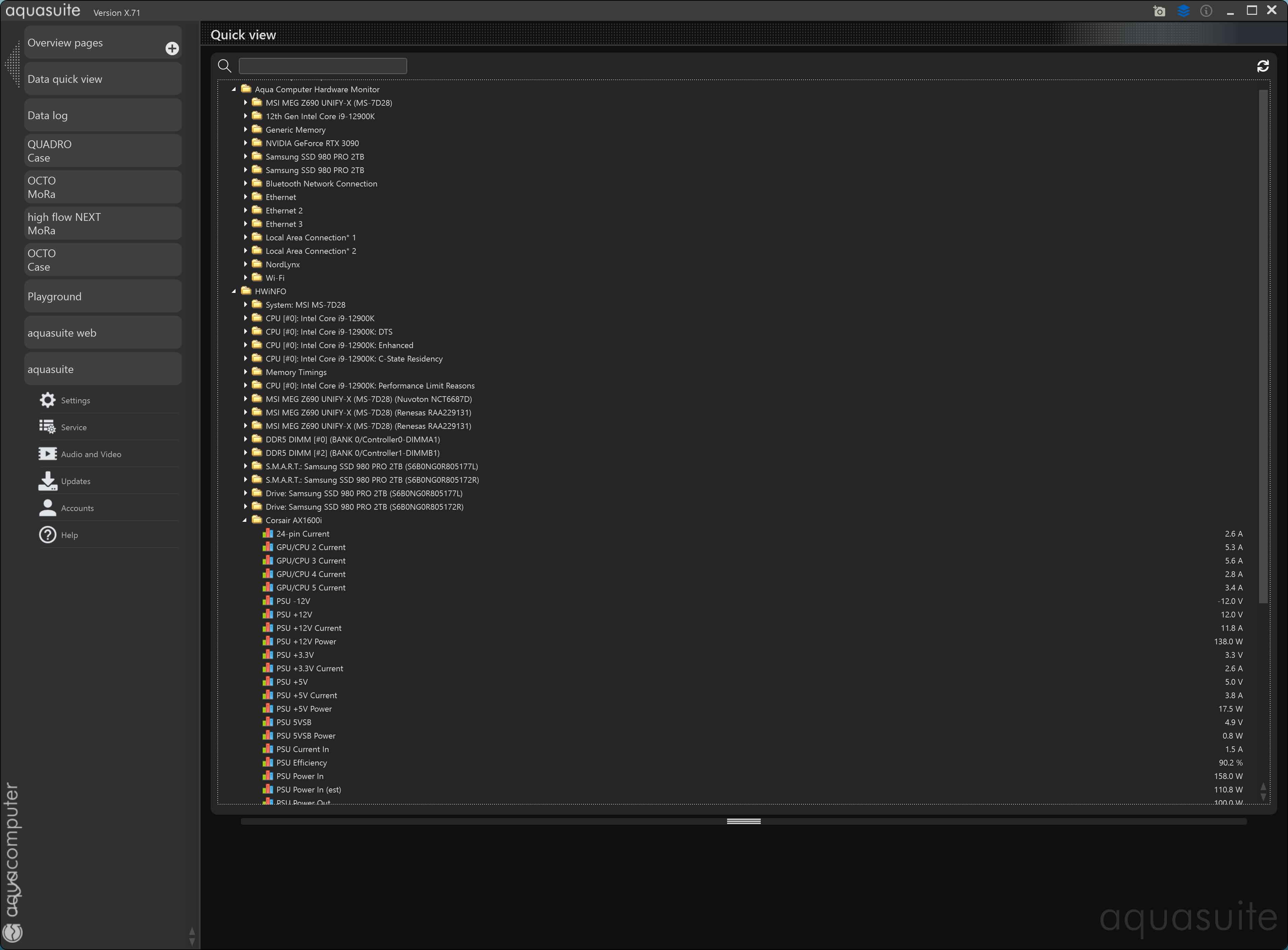

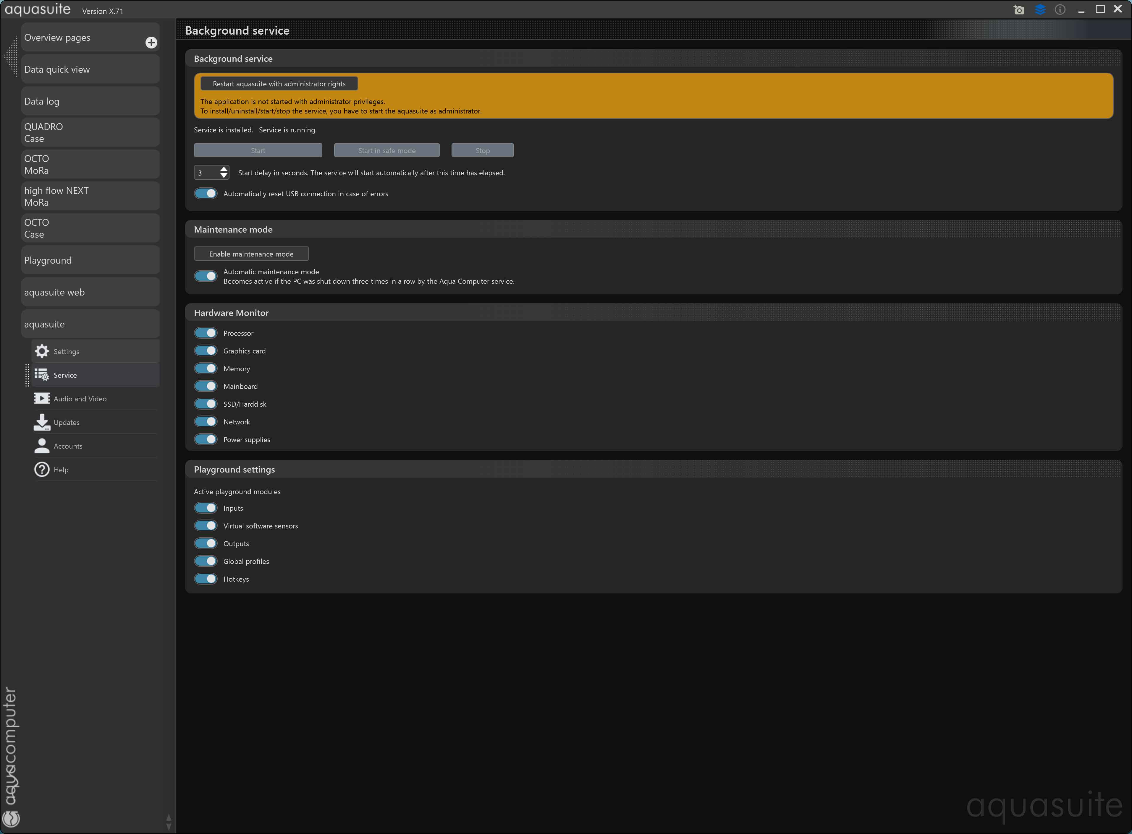

Montag, 14. August 2023, 22:13
My system's PSU is a Corsair AX1600i.
Aquacomputer Hardware Monitor does not appear to sense it, but HWiNFO does.
If HWINFO can monitor the PSU, you can import the data into AQS via HWINFO's Shared Memory Support. This feature works great but it does have a 12-hour limit unless you buy a HWINFO license, which I feel is well worth it. I have a Thermaltake iRGB Plus PSU that I bought mainly because it has a USB port on it. Thermaltake's software is complete trash but HWINFO and SIV can monitor it. Since HWINFO can monitor it, I can import that data into AQS.
I prefer to disable all Hardware Monitoring in AQS and import sensor data from HWINFO because it's sole purpose is to monitor sensors and it is very good at it. HWINFO is updated often to keep up with ever changing hardware. It has been updated 31 times this year compared to 6 times for AQS. Nothing against AQS. It's just that monitoring sensors is not the primary focus of the program. AQS is best at cooling loop component control. HWINFO is best at monitoring sensors. Since the Shared Memory Interface makes it easy to import everything that HWINFO monitors into AQS, I take advantage of this by using each program for what it is best at doing.
Agreed, if you look at the 2nd attachment (PSU_absent) you will see the PSU under the the HWiNFO tab. The feedback is informational for the Devs.
Dienstag, 15. August 2023, 02:34
Ah I did not catch that. Sorry if I was telling you something that you already know.

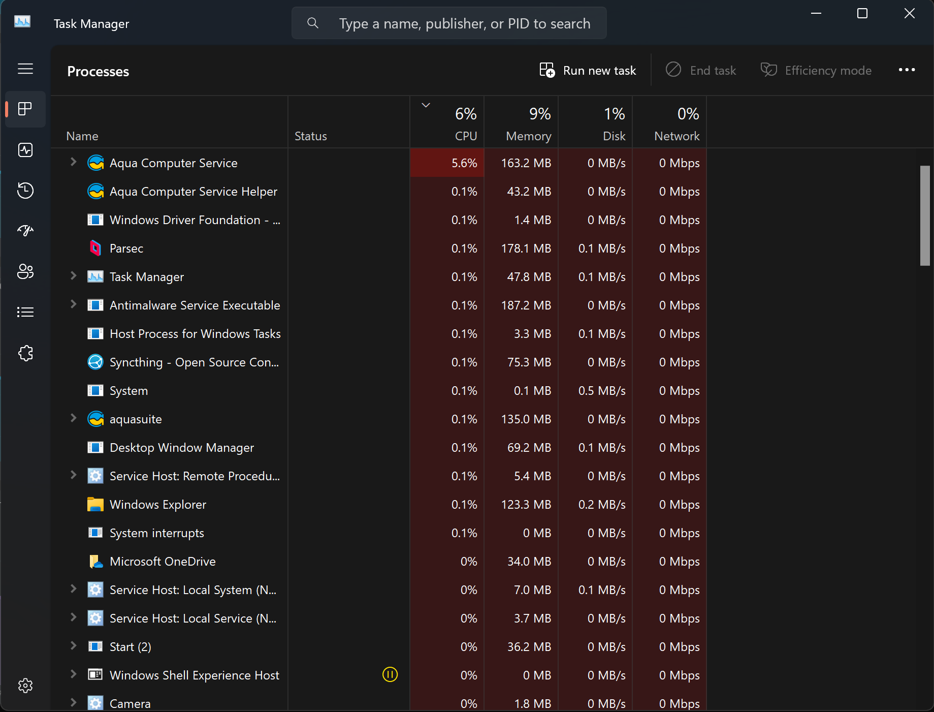

X71 seems to have fixed the issue with Aquasuite UI, but I can still see the high CPU usage on Aqua Computer Service.
The dip at before Aug 15 was when I installed X71. The power usage went from 2W to approximately 20W similar to X70 (the previous dip). Though, Aquasuite UI no longer causes CPU usage spike like on the leftmost.
On a 13900K machine, this constantly uses around 5.6% of the CPU time, or almost 1 and a half core, at around 6 hours mark onward.
On a VM (Xeon w9-3495X with 1 CPU assigned; configure to throttle to ~0.5 core, or 800MHz~1.5GHz depending on boost condition) the number reads 60% constantly. Up from around ~5% after boot. This is after 6 hours.
