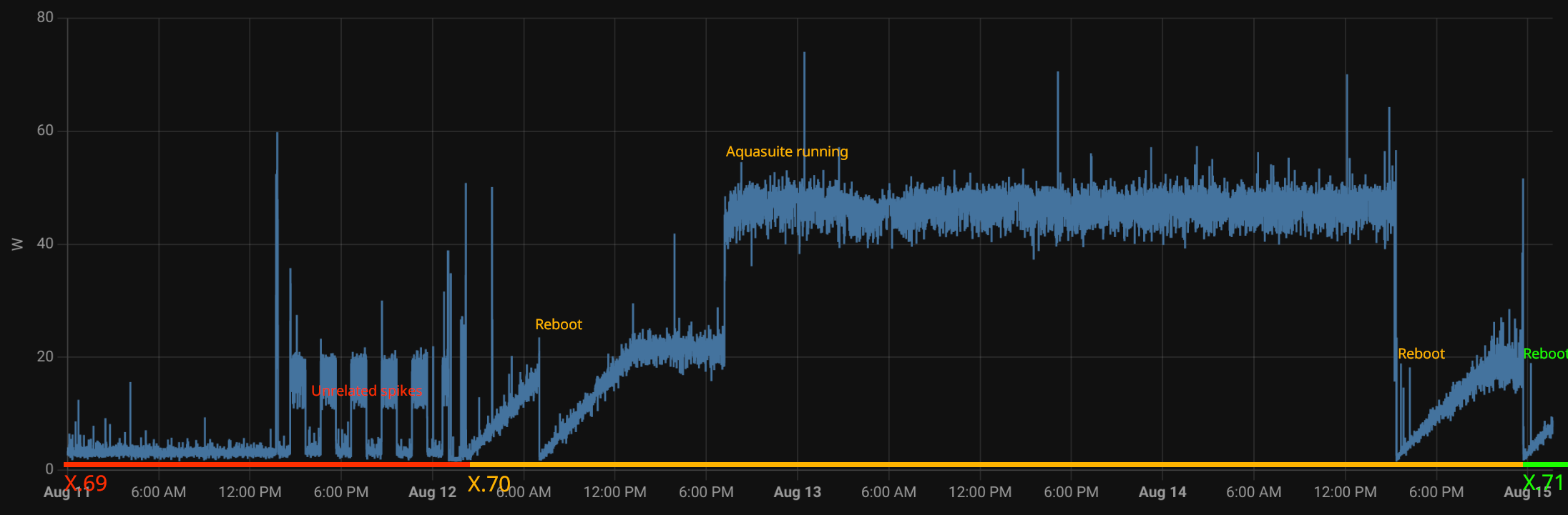

I've been running X71 for a few hours, but sadly the high CPU usage in Aqua Computer Service is still there.
I have MQTT setup to capture some statistics, and I can see the high CPU usage issue over there as well. As you can see in the attachment, the CPU usage remains very low in X69 (the spike at the end is unrelated). But CPU usage in X70 ACS slowly rises over time, from around 2W up to 22W, forcing the CPU to run at higher power state. It is even higher when Aquasuite is left running for a long time. It has been only two hours with X71, but I'm also seeing the same issue.
In the last two reboots, I haven't even logged in to Windows. I'm seeing this behavior with two of my machines with Aquasuite running, one with QUADRO, and another one with Aquaero 6 LT.
This post has been edited 1 times, last edit by "sirn" (Aug 14th 2023, 7:15pm)

X71 seems to have fixed the issue with Aquasuite UI, but I can still see the high CPU usage on Aqua Computer Service.
The dip at before Aug 15 was when I installed X71. The power usage went from 2W to approximately 20W similar to X70 (the previous dip). Though, Aquasuite UI no longer causes CPU usage spike like on the leftmost.
On a 13900K machine, this constantly uses around 5.6% of the CPU time, or almost 1 and a half core, at around 6 hours mark onward.
On a VM (Xeon w9-3495X with 1 CPU assigned; configure to throttle to ~0.5 core, or 800MHz~1.5GHz depending on boost condition) the number reads 60% constantly. Up from around ~5% after boot. This is after 6 hours.
