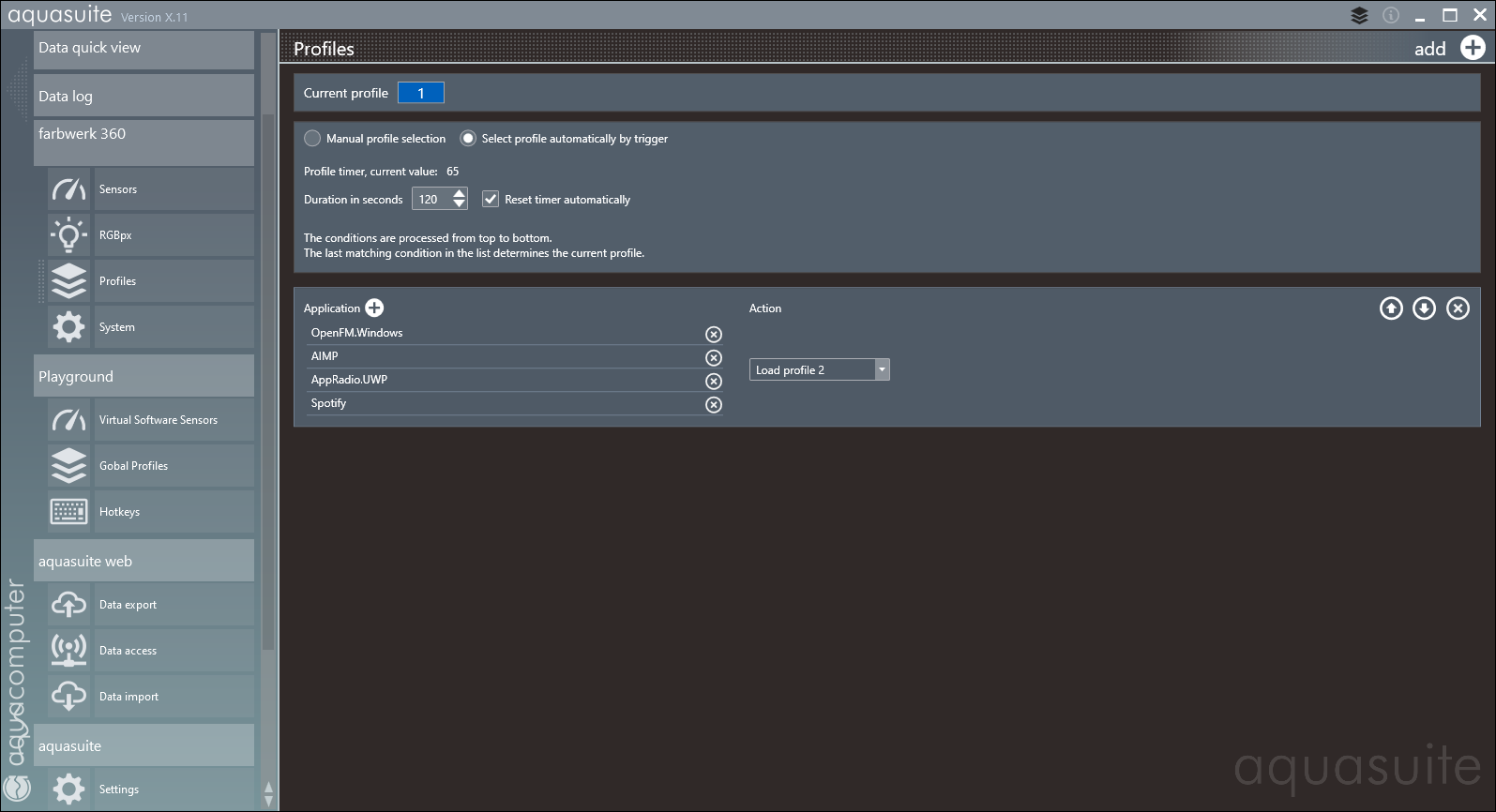

To the profiles. I've set it up as on attached screenshots below.
This is how it was setup on X.4 and everything with profiles worked automatically. Profiles here switches from 1 to 2 whenever I open/close any of these applications. When switch to manual mode, I can manually choose a profile to load, so this part is working.
And this is how it looks with the new X.11 profile extra functionality. I've never seen it changes automatically. It's always on Profile 1 and never switches between profiles. No action on manually changing it to profile 2. Nothing happens.
you select ist to AUTO: you have to define rules, otherwise set ist manual to profile 1, 2,...
don_dolarson
jeudi 16 janvier 2020, 16:54
Alright, I think I got it. The old profile page needs to be set to manual in order the new one to work, isn't it?
mditsch
jeudi 16 janvier 2020, 17:04
as an example my setup. it's in german but i think it will help

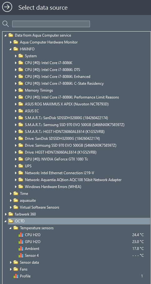

paskowitz
HWinfo cannot detect Octo or any AC device
vendredi 24 janvier 2020, 17:42
SW:Aquasuite x.11. HWinfo v6.20-4030.
HW: Octo, Farbwerk 360, 3x Splitty9s, Hubby7 (latest FW)
Steps taken: Fresh install of HWinfo
Bit of an odd situation. Aquasuite can detect HWinfo... but HWinfo cannot read any sensor data from Aquasuite. So, if I want to add a data source in AS, I can add from HWinfo... but if I open HWinfo, I cannot see any data from any Aquacomputer device. Sensors on the Octo can obviously be read by AS.
When I had my Aquaero 6XT as my controller (same version of AS and HWinfo) I did not have this problem. So, IDK, maybe this is something related to the hardware? Any help would be greatly appreciated. :thumbup:
