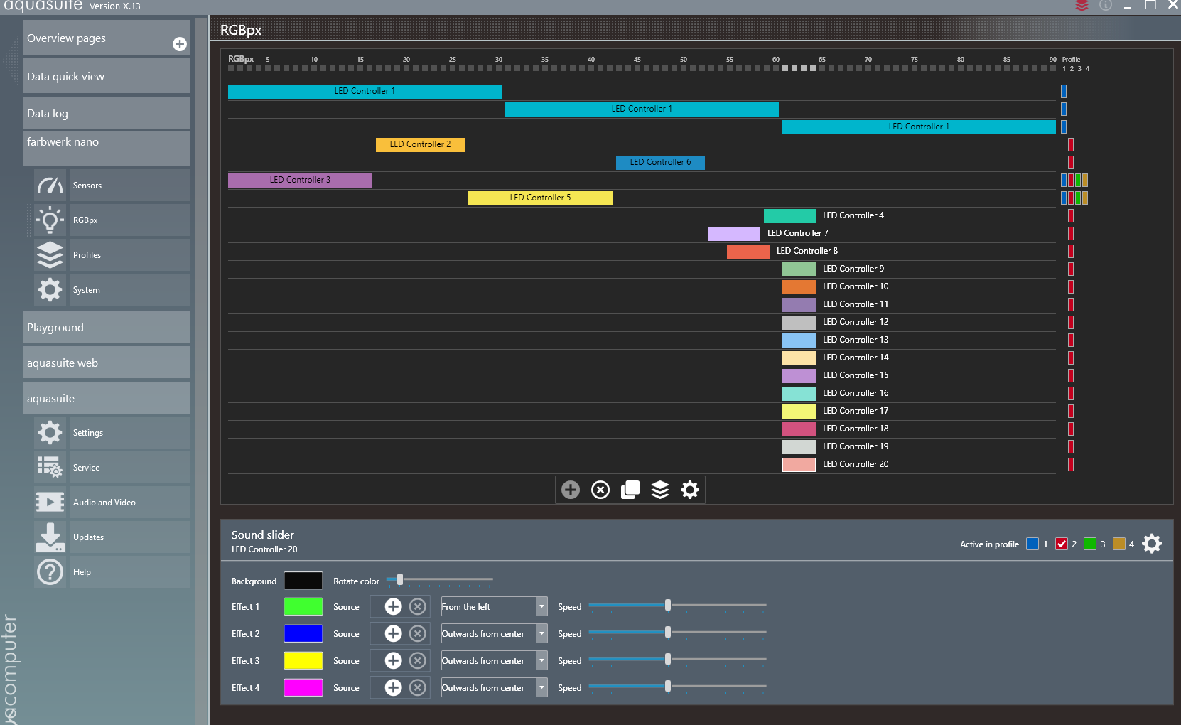

Can you tell me. Why RGBpx has only 20 led controller lines for leds? I have farbwerk nano. Is it limit for my device? If i buy farbwerk 360 will i get more lines for rgbpx(not for separate rgb out put)? If i use multiassign i have more lines but it just a copy of previous controller and if you change it, it changes previous block from which i copy it. Is it possible what in future will be more cotrollers? f.e.F on nano i have 90 leds support so will be it possible to have 90 lines for each led (90 led contollers)?
[img]https://forum.aquacomputer.de/index.php?page=Attachment&attachmentID=7271&h=453a1dfc5f7f6f55d5edec59b2cc09116bb38b16[/img]

May I ask why you stack so many controllers on the same leds? What's the reason and what do you there?
I'm not using all this controllers. Its just example how many controllers you can have. And for me its not enought). :rolleyes:
