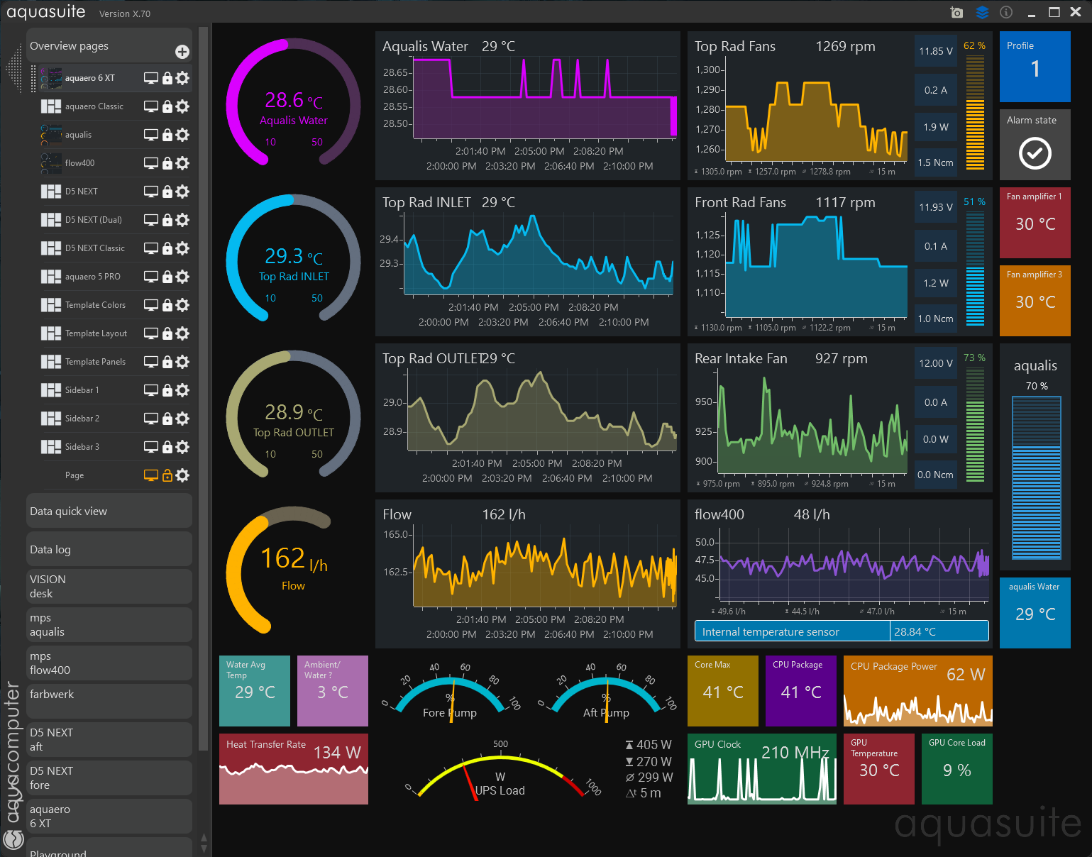

B3L13V3R
X.70 - Desktop Overlay on Windows 11 Preventing Background from Showing
dimanche 13 août 2023, 20:06
Hey guys! I love where the software is going.
When I use my desktop overlays, they work but blanked out both screens' backgrounds to a grey (see screenshots). It also hides the taskbar. Strange. It was working as it should for a few hours but at a random time, my desktop turned grey, and the taskbar disappeared.
B3L13V3R a envoyé les images :
Ce message a été modifié 1 fois. Dernière modification effectuée par "B3L13V3R" (13 août 2023, 20:14)

dimanche 13 août 2023, 20:16
X70 shouldn't have been released and now you stock with it, until they fix the issues which are quite few, but apparently to "some" " none existent" :whistling: :)
