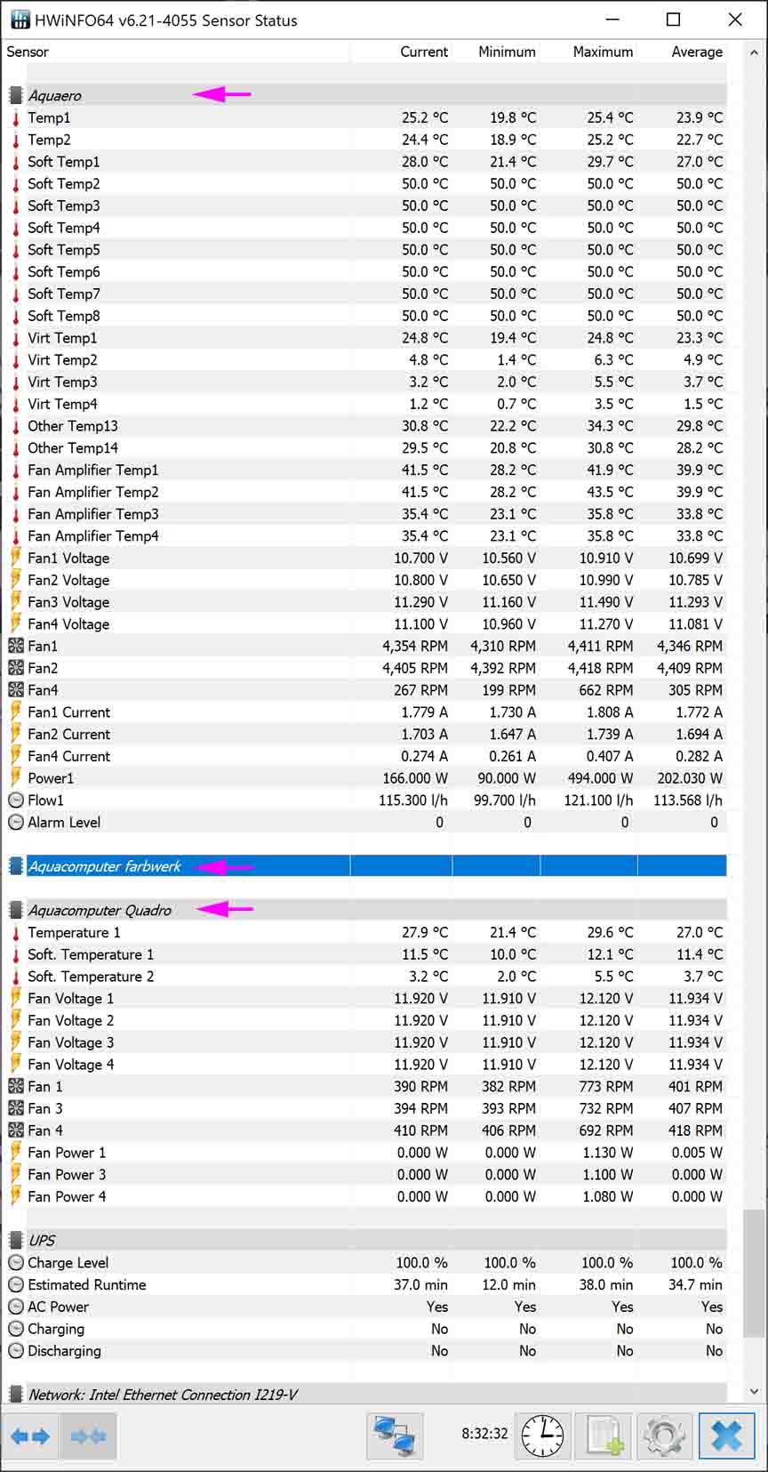

SW:Aquasuite x.11. HWinfo v6.20-4030.
HW: Octo, Farbwerk 360, 3x Splitty9s, Hubby7 (latest FW)
Steps taken: Fresh install of HWinfo
Bit of an odd situation. Aquasuite can detect HWinfo... but HWinfo cannot read any sensor data from Aquasuite. So, if I want to add a data source in AS, I can add from HWinfo... but if I open HWinfo, I cannot see any data from any Aquacomputer device. Sensors on the Octo can obviously be read by AS.
When I had my Aquaero 6XT as my controller (same version of AS and HWinfo) I did not have this problem. So, IDK, maybe this is something related to the hardware? Any help would be greatly appreciated. :thumbup:

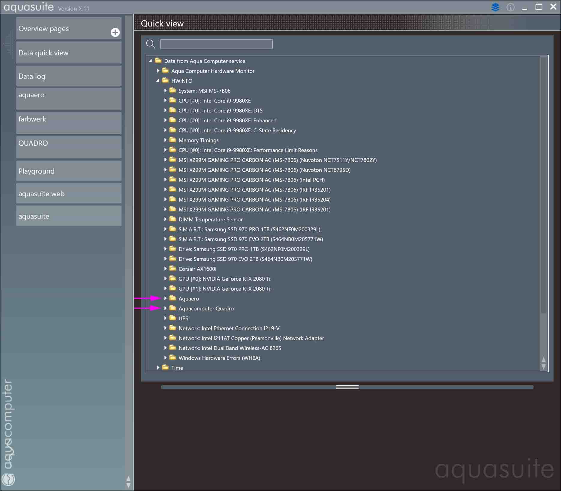

If the devices do not list in the HWiNFO Sensor Panel or they have no sensor values, they will not list in the aquasuite HWiNFO Computer Service list.
I have an aquaero, farbwerk & quadro, all 3 list in the HWiNFO Sensor Panel, but only the aquaero and quadro list under HWiNFO in the aquasuite computer service section.
I have only a software sensor on the farbwerk, no hard temperature sensors, so HWiNFO shows no sensor data and aquasuite does not list the farbwerk under HWInfo.
[attach]7181[/attach]
[attach]7182[/attach]
If you have no temp sensors on your farbwerk 360, you will not see it in the aquasuite under HWiNFO.
As to the octo, if you have it populated with fans and sensors, it may be that Martin has not yet implemented the device.
You may need contact him at the HWiNFO Forum.
I actually just fixed the issue. Updating to the beta version v6.21-4055 of HWinfo made the Octo sensors visible. So for anyone with that issue, give that a try. :thumbup:

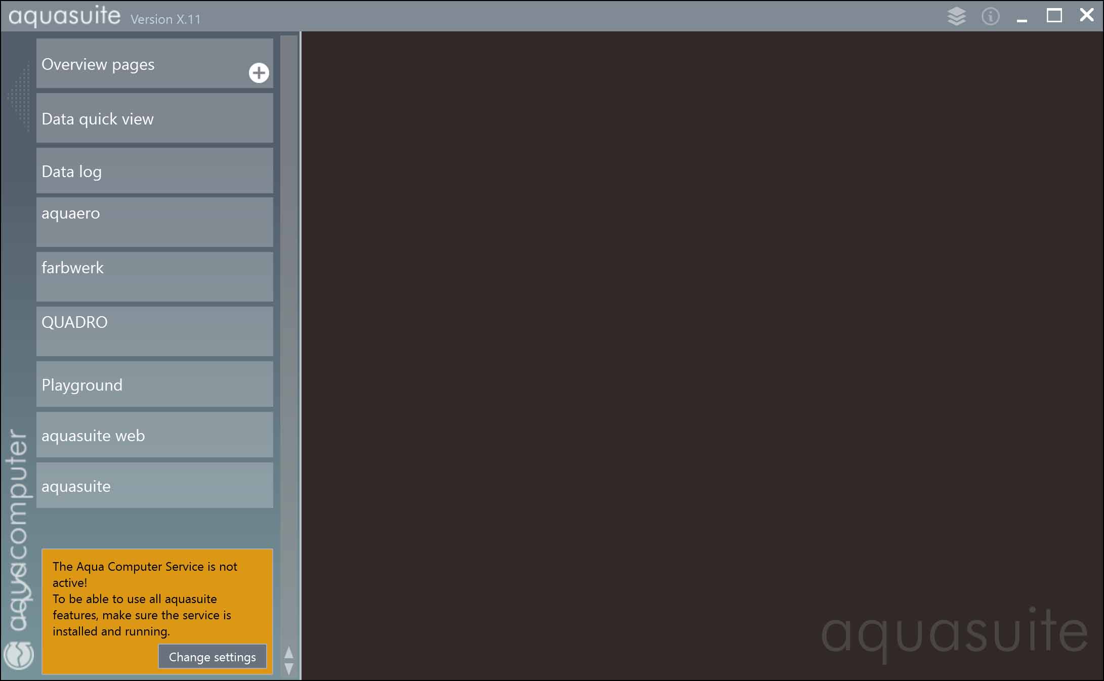

Occasionally when I start my system in the morning the aquasuite opens with the Aqua Computer Service not started.
I do not know why, but I do not stop the service, ever.
If I had to estimate a frequency... maybe once every few months. Not something to jump up & down about, just an FYI.
[attach]7205[/attach]
Same here I have reported 2-3 weeks ago.

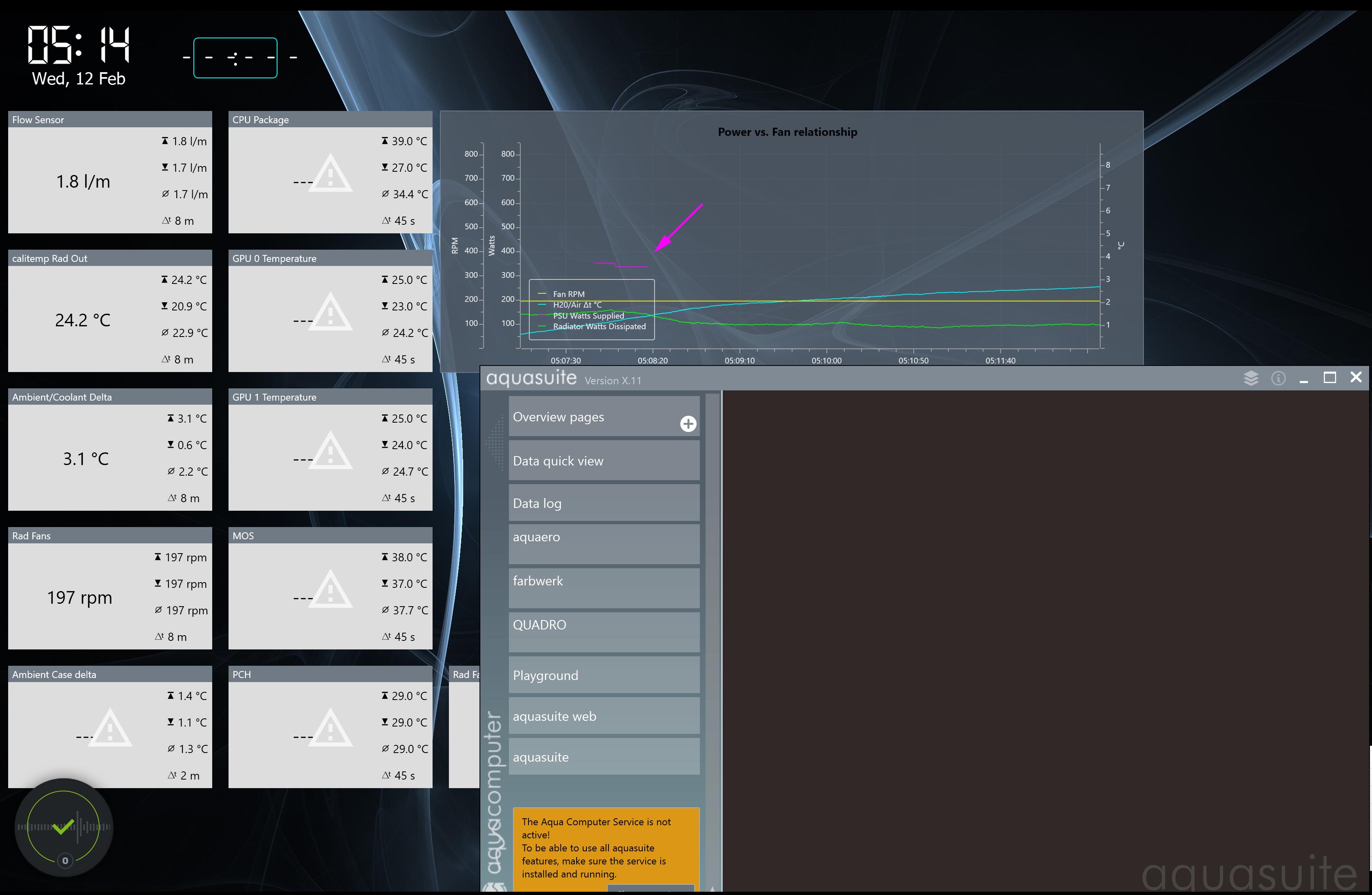

It appears the Service starts OK, but terminates shortly after the aquasuite starts.
In the snapshot below you can see an initial plotting of the PSU Watts Supplied, which is taken from HWiNFO.
Mittwoch, 12. Februar 2020, 14:58
Try to change the start delay in service settings. try it with 10 seconds.
Mittwoch, 12. Februar 2020, 15:20
Done
