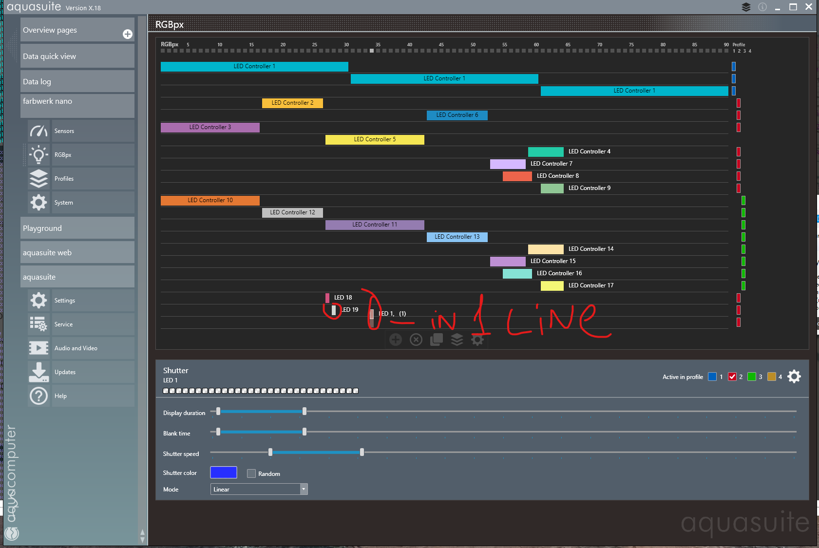

Hello. I've just tested insider vesrion x18 with new RGBpx effects. But i have a question. Will it be possible in near future make possible like divide leds in one line.
F.e. now you can apply only 1 effect on one line. And to add new affect need to use another line. But the maximum number of lines are 20. If you copy not multiassign.
F.e. on the other hand thermaltake now have their new software for creating effects and they going in 1 line. One by one. Is this possible to make in aquasuite?
Maybe this is bad example.
Zagdima has attached the following image:

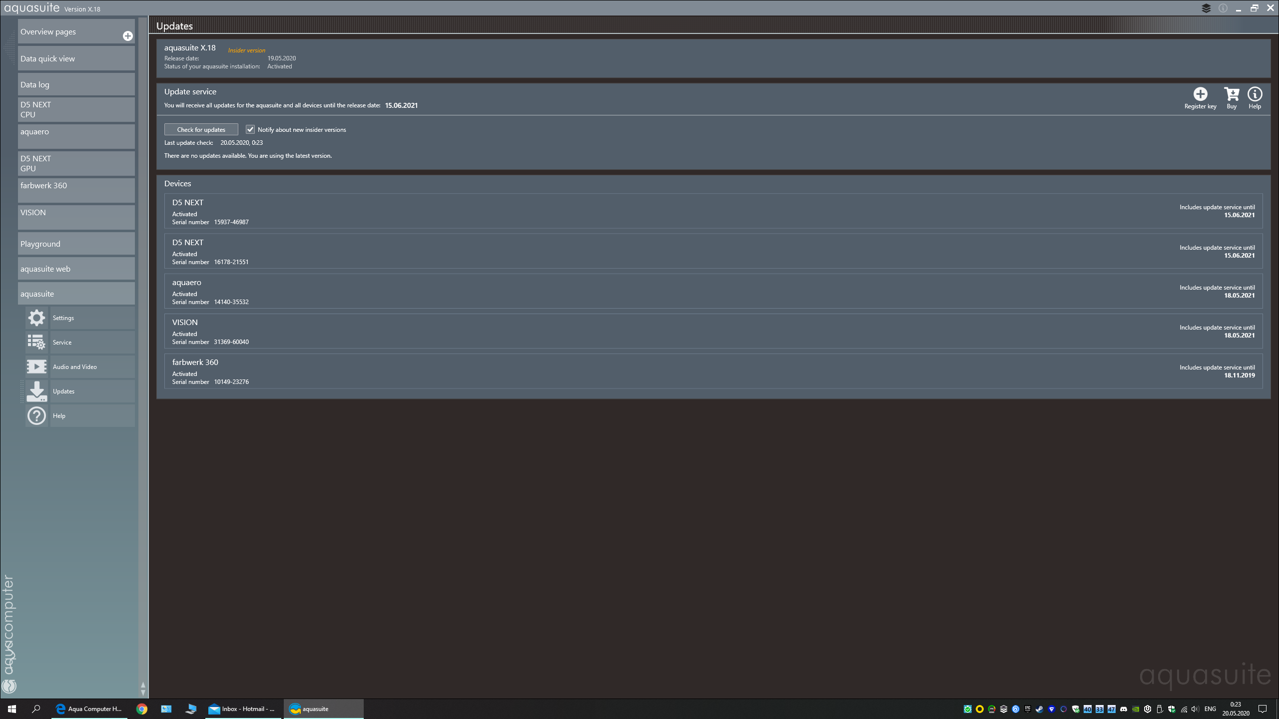

After installing x18 (insider), the aquasuite license has stopped to working normally (let's say). I have one usb high flow (license valid until 2021) and one aquaero 5 lt (I bought it in 2016 second hand).
Connection: I put on the 5lt the usb high flow with the 4-pin aquabus connector. With the x17 aquasuite i have no issues. After installing the x18, I need to connect the USB and the 4-pin aquabus connector to find a valid license for aquasuite x18, and to find all the devices (1 piece) connected to 5lt.
Or I messed up something...
(Sorry, my english is: Google translate...)
RE: Houston, we have a problem...
Tuesday, May 19th 2020, 6:48pm
I would just point out a problem.
This is correct. You need to have a device with an active license connected via USB for the update.
This post has been edited 1 times, last edit by "wpuser" (May 19th 2020, 6:57pm)
deckwood
RE: RE: Houston, we have a problem...
Tuesday, May 19th 2020, 7:18pm
Okay, I understand.
But wouldn’t it be easier for the software (aquasuite x18) to look for a licensed device instead of having to have fun connecting the usb every time you upgrade? Or aquasuite can't do that? And then can the usb connection be disconnected after the upgrade? Because currently usb high flow gets power from 2 places. 1 usb and a 4 pin aquabus.
Luckily, after setting up the 4 pin aquabus connection, I left the usb cable inside the machine.

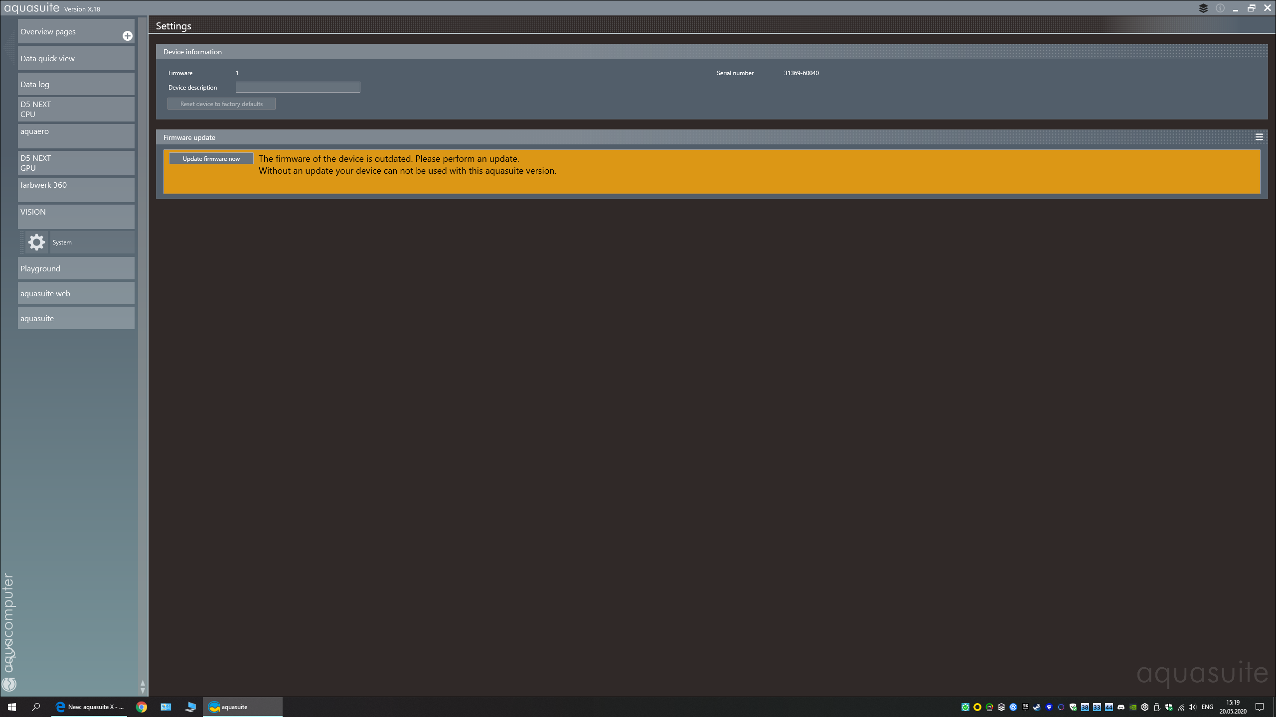

20.05 I started the automatic aquasuite update. Cuplex Kryos Next Vario not updated. During the update the digital display indication disappeared. Other devices are normally updated. What I did:
1. power off system restart
2. changed usb connection
3. reinstalled aquasuite (clean installation)
But it didn’t help
Update for Vext Vario does not occur. Now I don’t have Next Vario update and digital indication.
Thank You
Eurooplane has attached the following image:
Wednesday, May 20th 2020, 1:16pm
Did you remove the power cord to disable any standby voltage?
Eurooplane
Wednesday, May 20th 2020, 1:39pm
Yes, of course. Didn't help.
I can not up to date and no digital indication
Eurooplane has attached the following images:
Eurooplane has attached the following file:
  • IMG_E7760.JPG (864.81 kB - 5,104 times downloaded - Last download: Today, 1:55am)
This post has been edited 2 times, last edit by "Eurooplane" (May 20th 2020, 1:46pm)
Wednesday, May 20th 2020, 4:17pm
Can you try the update of the VISION at another PC?
Eurooplane
Wednesday, May 20th 2020, 5:39pm
I tried and could to update. Thank You for advice. Very interesting what the problem it was? If next time I can not to update? :D
Wednesday, May 20th 2020, 6:31pm
Looks like an issue with your USB connection (driver / chipset etc). Please tell us about your Mainboard and wich connectors you have tried.
