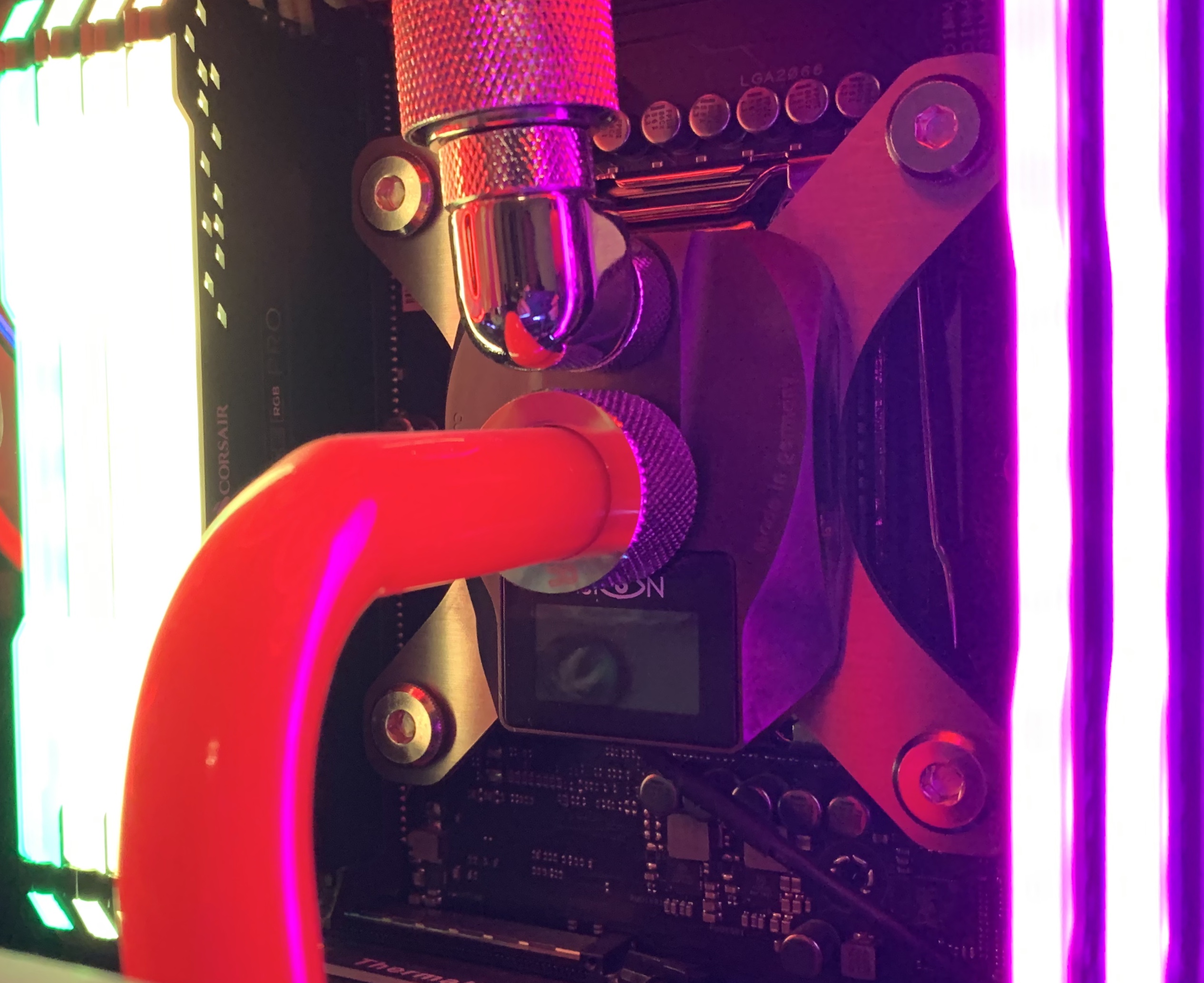

problem with plex kryos NEXT VARIO with VISION 2011/2011-3/2066, PVD/nickel after Aquasuite X18 update
mercredi 20 mai 2020, 12:31
20.05 I started the automatic aquasuite update. Cuplex Kryos Next Vario not updated. During the update the digital display indication disappeared. Other devices are normally updated. What I did:
1. power off system restart
2. changed usb connection
3. reinstalled aquasuite (clean installation)
But it didn’t help
Update for Vext Vario does not occur. Now I don’t have Next Vario update and digital indication.
Thank You

mercredi 20 mai 2020, 13:16
Did you remove the power cord to disable any standby voltage?
Eurooplane
mercredi 20 mai 2020, 13:39
Yes, of course. Didn't help.

I can not up to date and no digital indication

mercredi 20 mai 2020, 16:17
Can you try the update of the VISION at another PC?
Eurooplane
mercredi 20 mai 2020, 17:39
I tried and could to update. Thank You for advice. Very interesting what the problem it was? If next time I can not to update? :D
mercredi 20 mai 2020, 18:31
Looks like an issue with your USB connection (driver / chipset etc). Please tell us about your Mainboard and wich connectors you have tried.

jeudi 21 mai 2020, 11:36
Mainboard is a Asus ROG Rampage VI Extreme Omega and I use HUBBY7 internal USB 2.0 Hub for connection. Also I have two D5 Next, Aquaero 6 XT, Farbwerk 360 and 3 RGBPX Splitti4 in my system. This problem is a first time and only with VISION :?:
