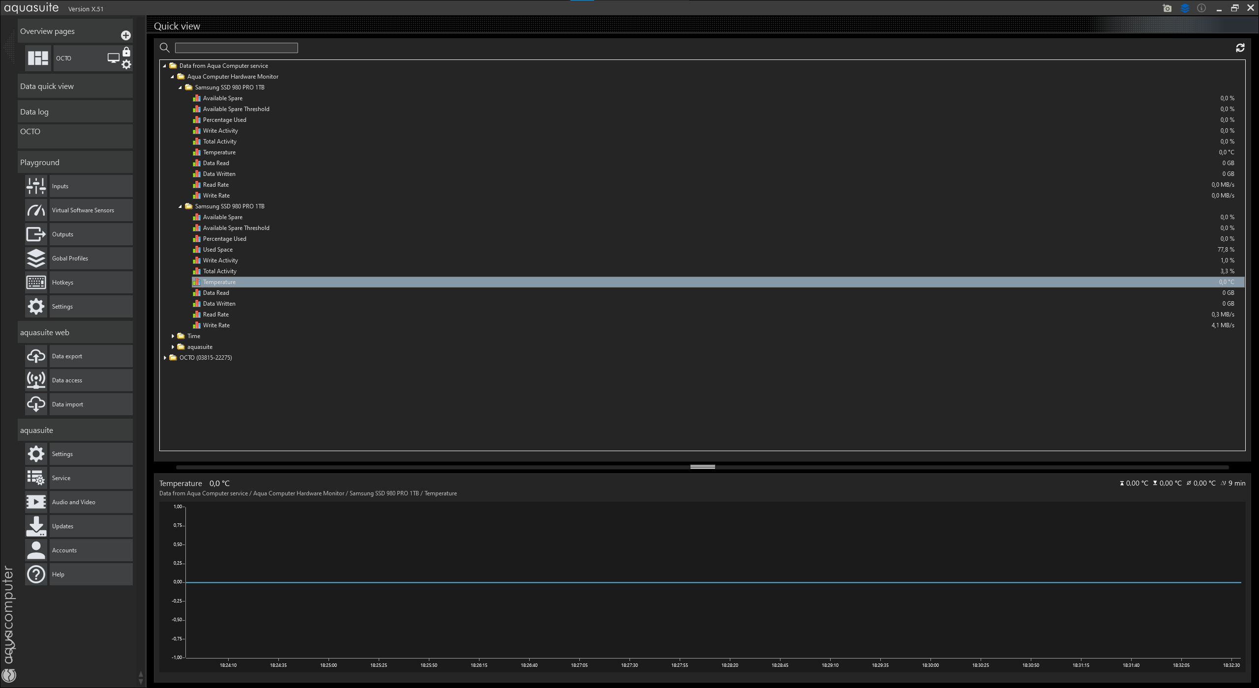

CPU: i7 11700k
MOBO: Z590 Torpedo
OS: Win 10 64bit 21H1
AQS license on OCTO
980 PRO in PCIe #1 slot (PCIe 4.0 speed)
980 PRO in PCIe #2 slot (PCIe 3.0 speed)
both disks shows at 0.0*C
and ofc I do have SSD/Harddisk option selected.
I tried to unselect all except SSD in AQS, still nothing.
The aquasuite picks up my Samsung SSD 980 Pro ([attach]9311[/attach])

You may want to contact support directly.
As I said X.49 was perfectly fine.

CPU: i7 11700k
MOBO: Z590 Torpedo
AQS license on OCTO
CPU: i9-9980XE
MOBO: MSI X299 Gaming Pro Carbon AC
OS: Win 11 64bit 21H2

Works fine for me, but x51 is my first install.
CPU: i7 11700k
MOBO: Z590 Torpedo
AQS license on OCTO
CPU: i9-9980XE
So it seems like Z590 southbridge is the only problem in new x.51 AQS?
