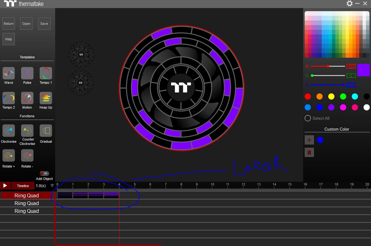

Zagdima
Dienstag, 19. Mai 2020, 17:13
Hello. I've just tested insider vesrion x18 with new RGBpx effects. But i have a question. Will it be possible in near future make possible like divide leds in one line.
F.e. now you can apply only 1 effect on one line. And to add new affect need to use another line. But the maximum number of lines are 20. If you copy not multiassign.
F.e. on the other hand thermaltake now have their new software for creating effects and they going in 1 line. One by one. Is this possible to make in aquasuite?
Maybe this is bad example.
»Zagdima« hat folgendes Bild angehängt:

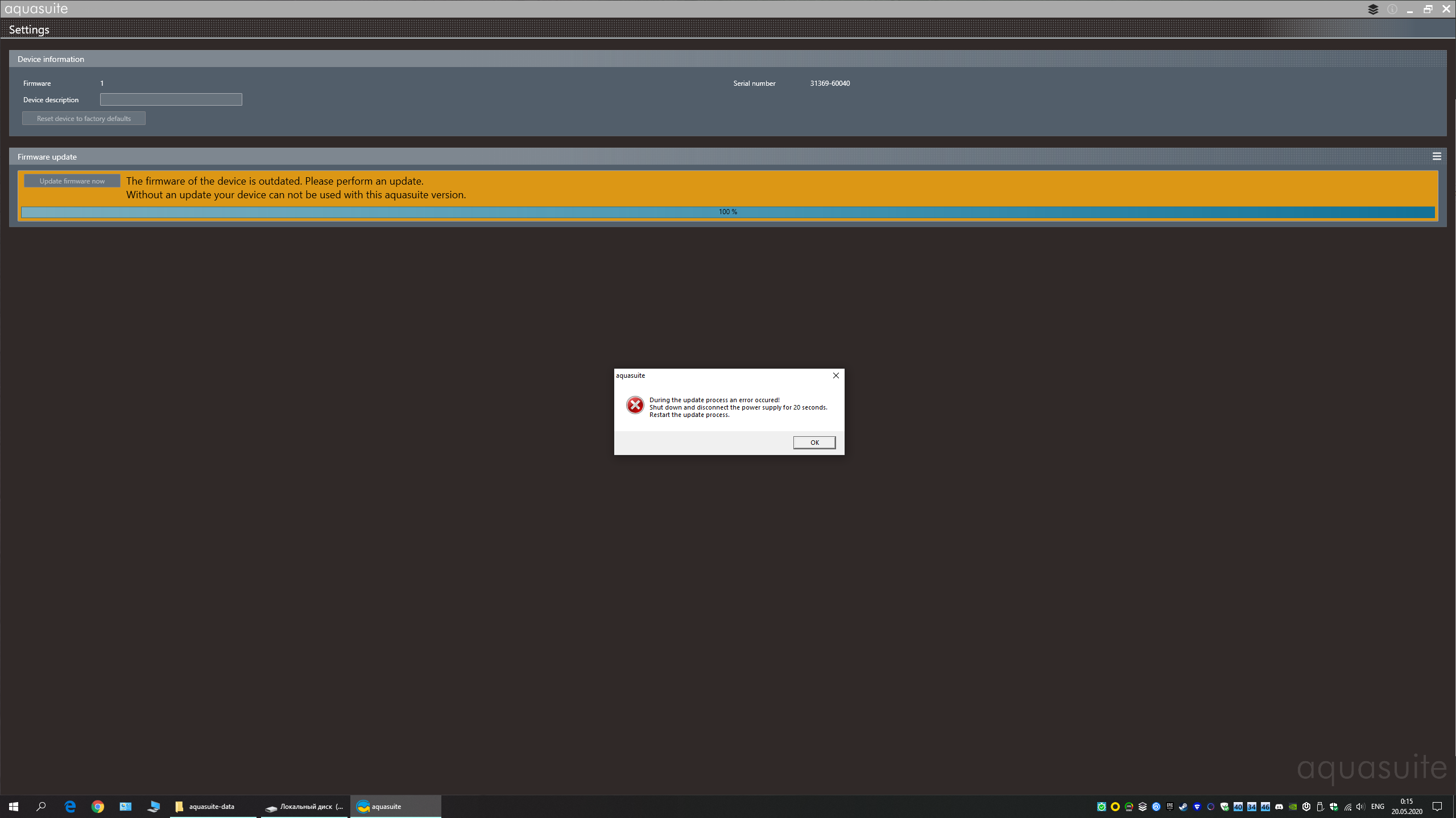

Eurooplane
problem with plex kryos NEXT VARIO with VISION 2011/2011-3/2066, PVD/nickel after Aquasuite X18 update
Mittwoch, 20. Mai 2020, 12:31
20.05 I started the automatic aquasuite update. Cuplex Kryos Next Vario not updated. During the update the digital display indication disappeared. Other devices are normally updated. What I did:
1. power off system restart
2. changed usb connection
3. reinstalled aquasuite (clean installation)
But it didn’t help
Update for Vext Vario does not occur. Now I don’t have Next Vario update and digital indication.
Thank You

Mittwoch, 20. Mai 2020, 13:16
Did you remove the power cord to disable any standby voltage?
Eurooplane
Mittwoch, 20. Mai 2020, 13:39
Yes, of course. Didn't help.
I can not up to date and no digital indication

Mittwoch, 20. Mai 2020, 16:17
Can you try the update of the VISION at another PC?
Eurooplane
Mittwoch, 20. Mai 2020, 17:39
I tried and could to update. Thank You for advice. Very interesting what the problem it was? If next time I can not to update? :D
Mittwoch, 20. Mai 2020, 18:31
Looks like an issue with your USB connection (driver / chipset etc). Please tell us about your Mainboard and wich connectors you have tried.
Eurooplane
Donnerstag, 21. Mai 2020, 11:36
Mainboard is a Asus ROG Rampage VI Extreme Omega and I use HUBBY7 internal USB 2.0 Hub for connection. Also I have two D5 Next, Aquaero 6 XT, Farbwerk 360 and 3 RGBPX Splitti4 in my system. This problem is a first time and only with VISION :?:
