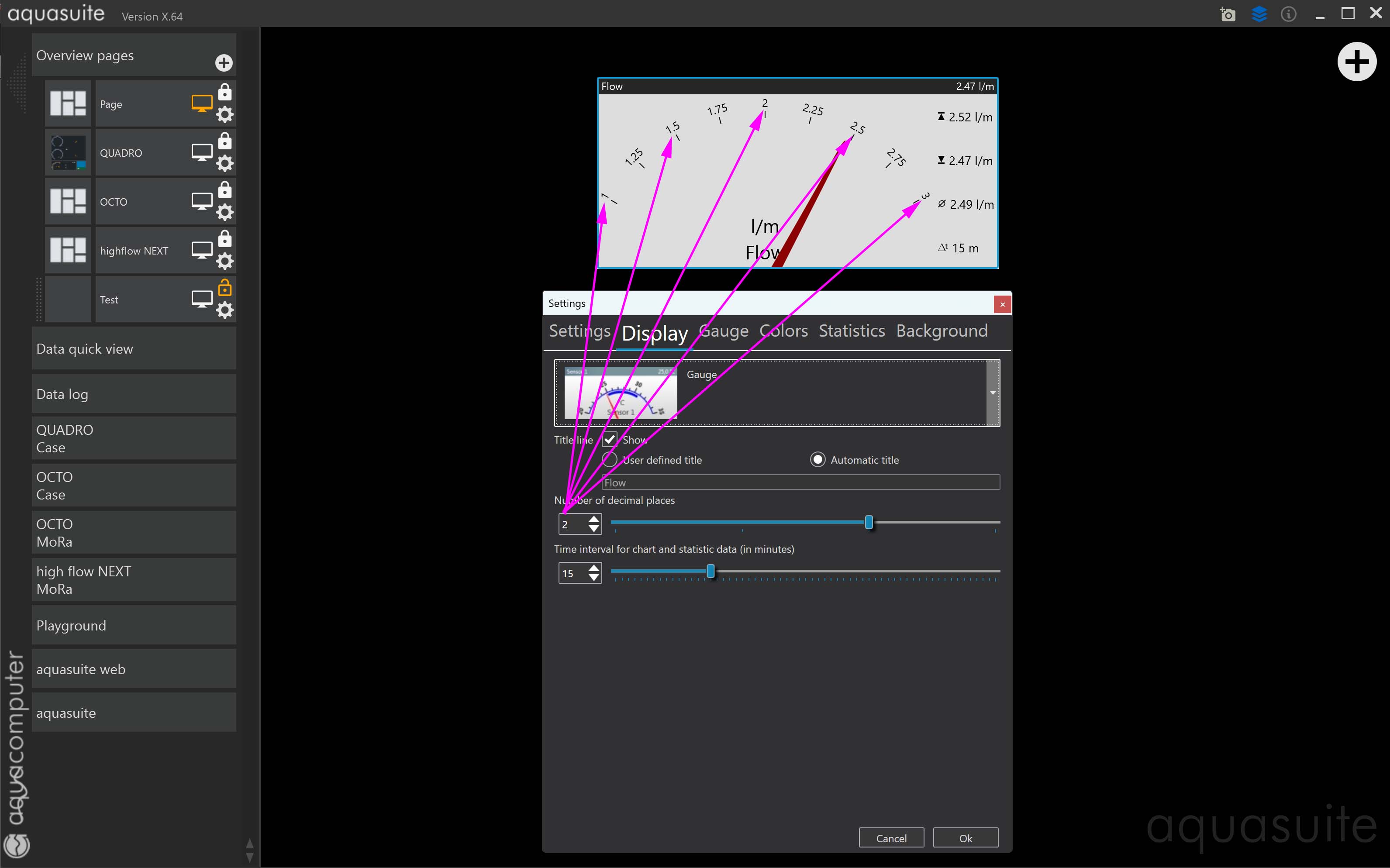

Freitag, 16. Dezember 2022, 04:39
The gauge display does not appear to comply with decimal specification (gauge_decimals.jpg)
Freitag, 16. Dezember 2022, 07:18
this is correct, it displays max 2 decimal places when needed
