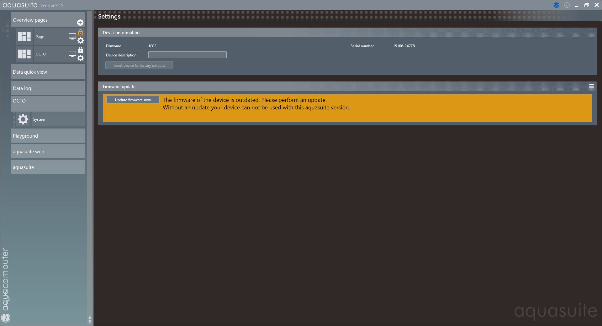

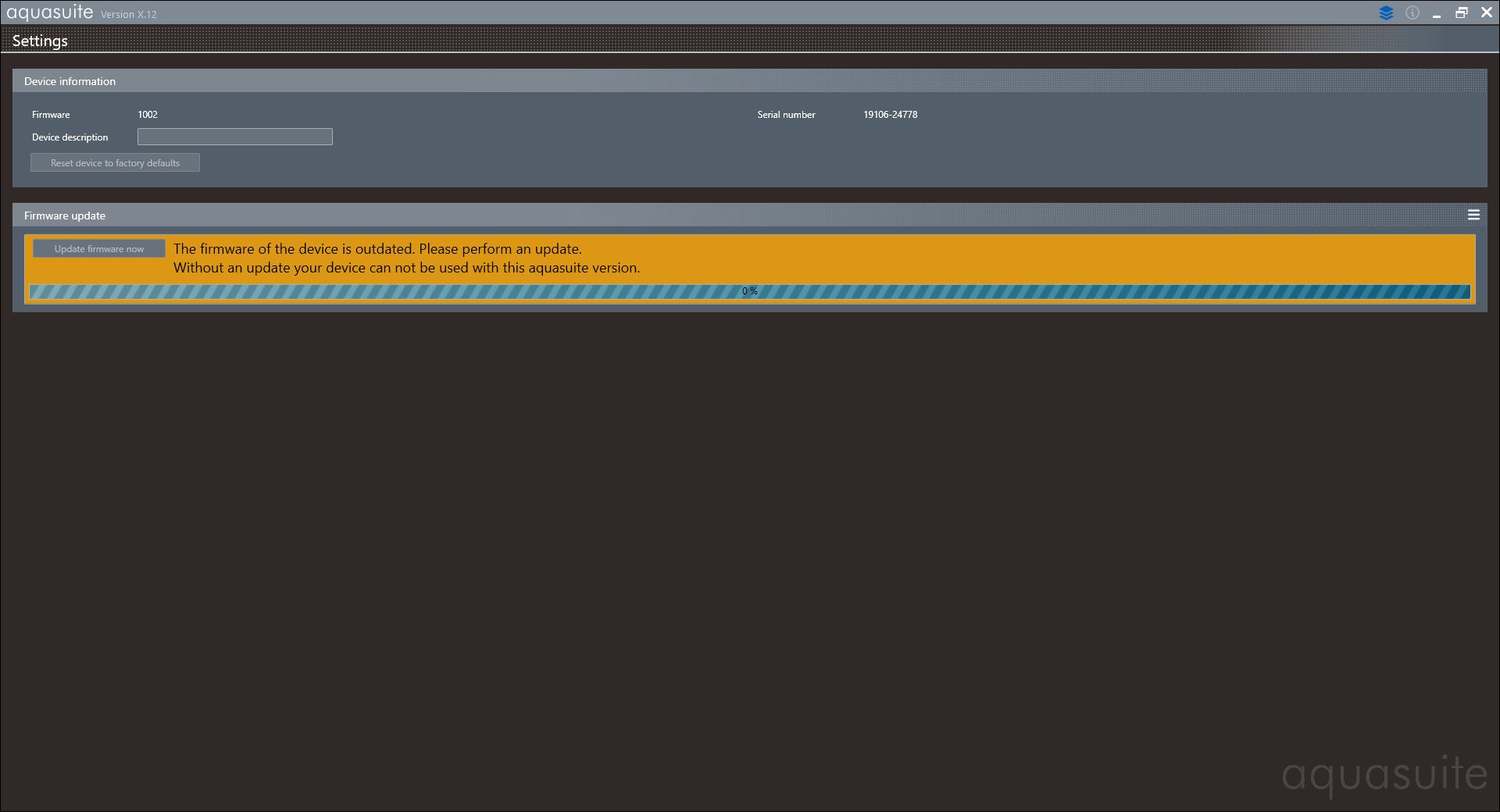

RaNDoM
OCTO doesn't work with X.12
Freitag, 21. Februar 2020, 09:24
After update to X.12 version OCTO fan controller doesn`t work with it. Writes that the firmware is outdated, but the update is not performed.
»RaNDoM« hat folgende Dateien angehängt:
  • Screen1.jpg (131,91 kB - 10 528 mal heruntergeladen - zuletzt: 1. Januar 2026, 19:17)
  • Screen2.jpg (124,9 kB - 10 456 mal heruntergeladen - zuletzt: 2. Januar 2026, 22:43)
Freitag, 21. Februar 2020, 09:26
this looks line an usb issue, connect the octo without any usb hub or other devices to your mainboard and try the update again. Power off your computer before and after the update.
Close all 3rd party Software like aida, hwinfo, afterburner, rtss....
RaNDoM
Freitag, 21. Februar 2020, 09:41
It is directly connected to the USB of the motherboard. The computer was completely turned off. Third-party programs were not launched.

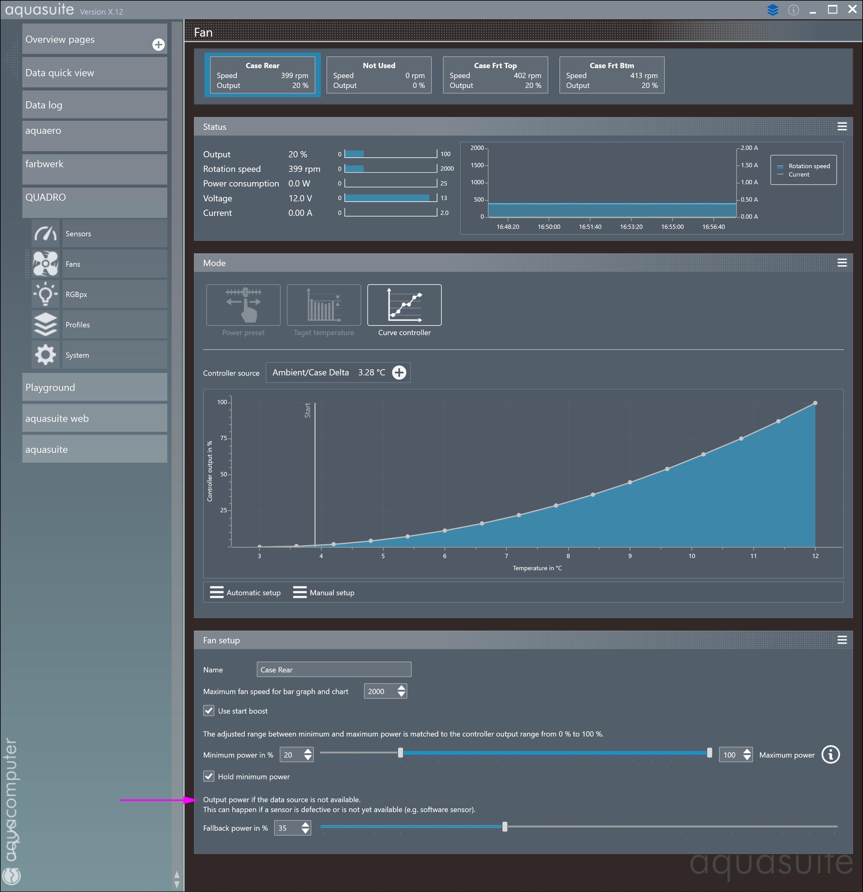

If I follow you correctly, this was addressed on the X.12 QUADRO & OCTO firmware update.
OCTO Firmware 1004: New: Adjustable fall-back power for fan output (e.g. for missing sensor data at system startup)
It looks like this on the QUADRO: fan_fallback.jpg
