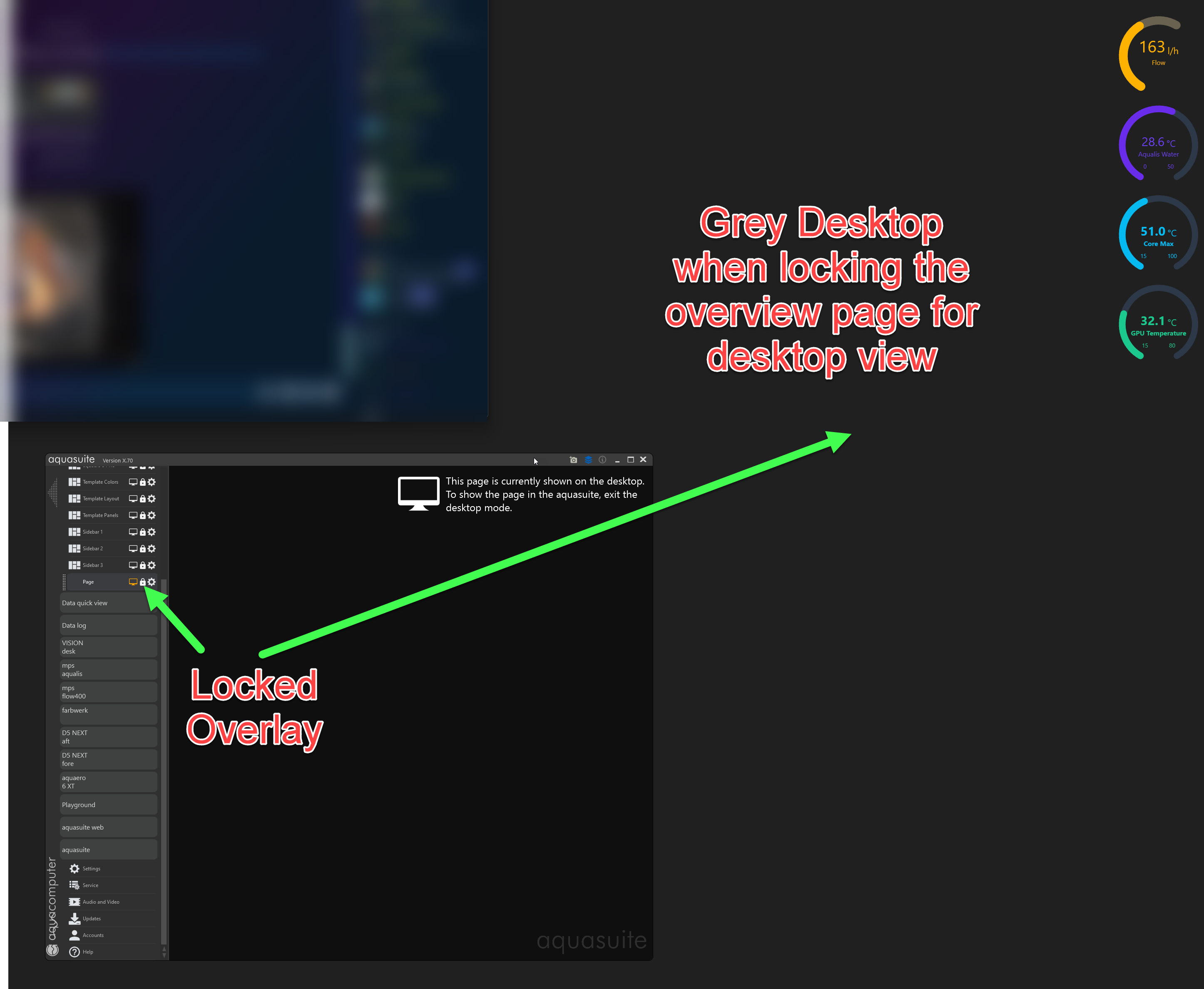

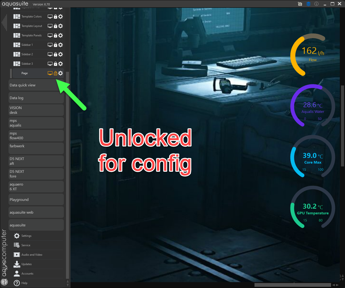

X.70 - Desktop Overlay on Windows 11 Preventing Background from Showing
Sonntag, 13. August 2023, 20:06
Hey guys! I love where the software is going.
When I use my desktop overlays, they work but blanked out both screens' backgrounds to a grey (see screenshots). It also hides the taskbar. Strange. It was working as it should for a few hours but at a random time, my desktop turned grey, and the taskbar disappeared.

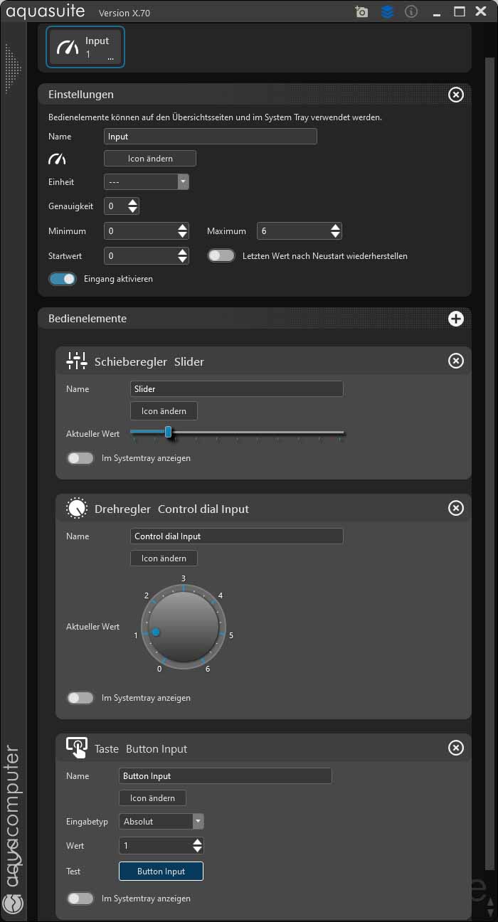

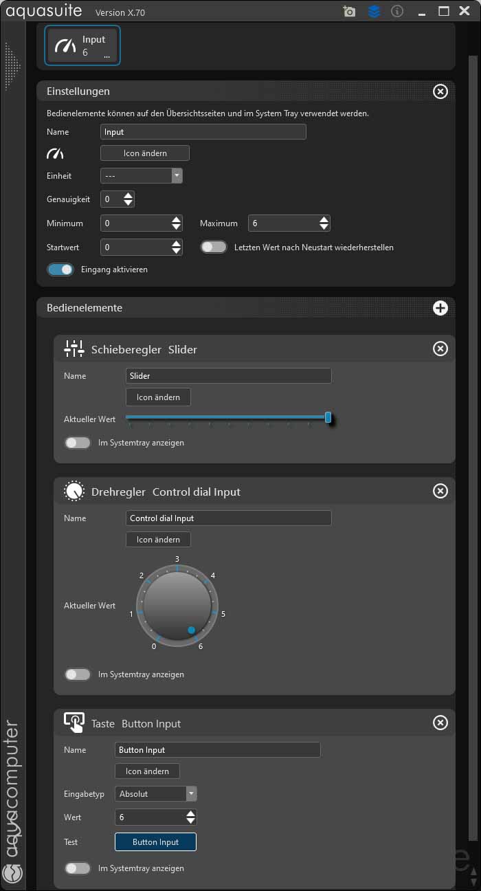

Montag, 14. August 2023, 07:31
OK, Chrome has solved it.
I tried that and I think it works, at least as I understand it.
The button is controlled by the "Value" field, for example if I enter 1 and press the "Button Input" the value changes on the slider and dial, both relative and absolute.
The value at the button changes the value of the slider and the dial by exactly the set value each time the knob is pressed.
If the value is 0 nothing should change according to my understanding.
