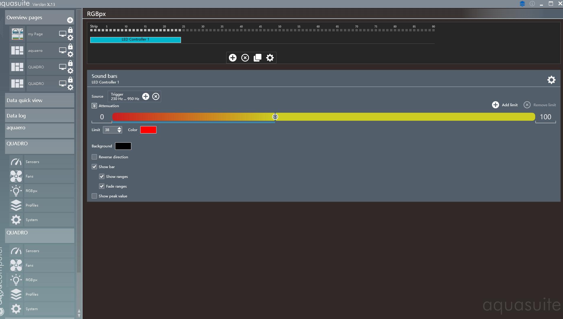

hello,Why my RGBFX sound bars mode doesn't work and the led doesn't respond to tasks,
Other sound modes are normal.
Looking forward to your reply. Thank you
The attachment contains the setup diagram.
