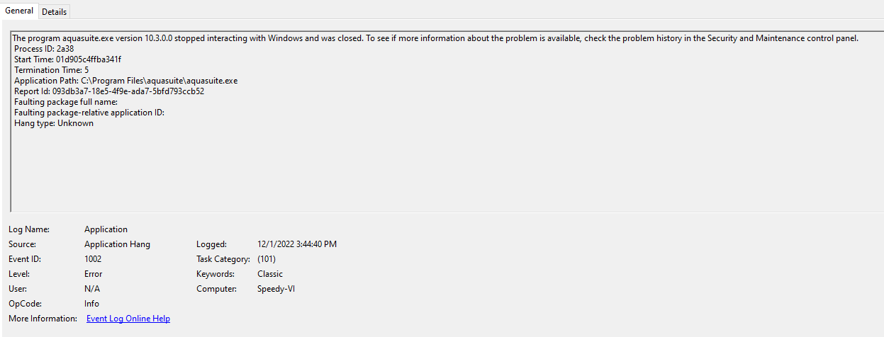

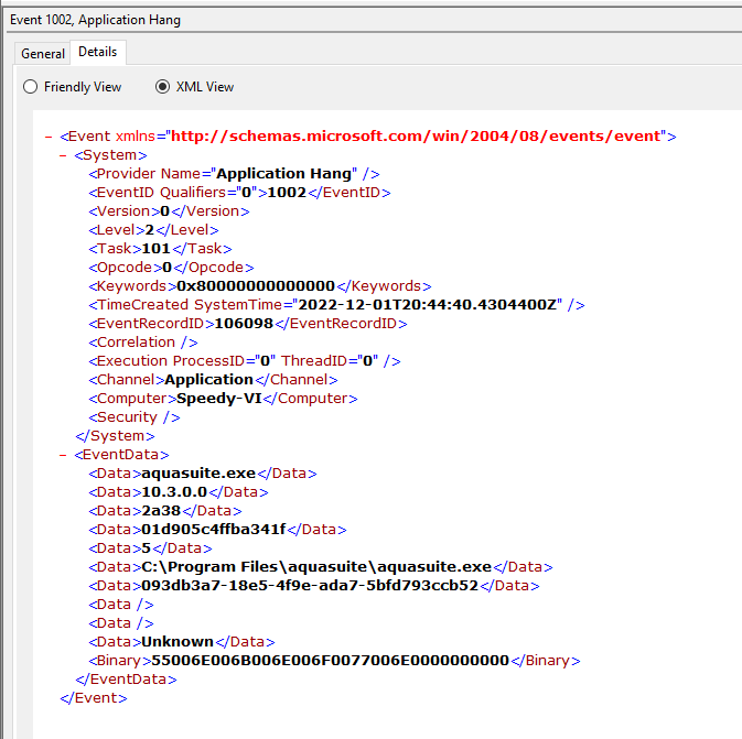

I have been watching the forum for bug reports for AQS X.60 and X.61. Most of them are in the German forum where there is a thread set up specifically to report problems with the new versions of AQS that are using .NET 7. Today I decided to update. Before I did, I backed up all of my Aquacomputer device settings and everything in C:\Program Data\aquasuite-data, then made a Windows Restore Point just in case. I installed .NET 7 then closed AQS X.59 and ran it as Admin, then did the update from within AQS. When the update was finished it said a reboot was required so I rebooted. When I did, AQS opened but froze. The screen basically went white. I could still close the program so I did. I restarted it and it opened normally. I then did another reboot to see if it would freeze again but it didn't. So far, everything seems to be working normally. I have not noticed any problems since updating.
I looked in Event Manager and found Event ID 1002 - Application Hang which was generated when AQS crashed after the first reboot. I have attached screen shots of this error. If the devs would like any additional information, please specify and I will attempt to provide it.

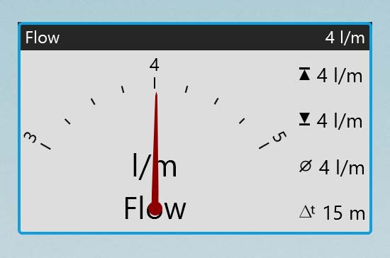

New version of software, the gauge is bonked. Can't set parameters as before as minor tickmarks are on steroids; e.g. set gauge for flow, 0-2gpm. Set labels at 0.1. Set minor tickmarks anywhere.....
Sonntag, 4. Dezember 2022, 03:53
3 to 5, majors at 1,000 & minors at 0,250 (guage.jpg)
mandrix
Sonntag, 4. Dezember 2022, 13:30
3 to 5, majors at 1,000 & minors at 0,250 ([attach]9876[/attach])
Well, not what I said.
Infoseeker, set labels for each of those marks.
Dieser Beitrag wurde bereits 5 mal editiert, zuletzt von »mandrix« (4. Dezember 2022, 13:48)
mandrix
Sonntag, 4. Dezember 2022, 13:55
my image isn't posting for some reason. done with that. lol.
Dieser Beitrag wurde bereits 1 mal editiert, zuletzt von »mandrix« (4. Dezember 2022, 13:56)
Sonntag, 4. Dezember 2022, 18:40
Labeling error CAPTURED
mandrix
Sonntag, 4. Dezember 2022, 20:25
Yep. There it is.
