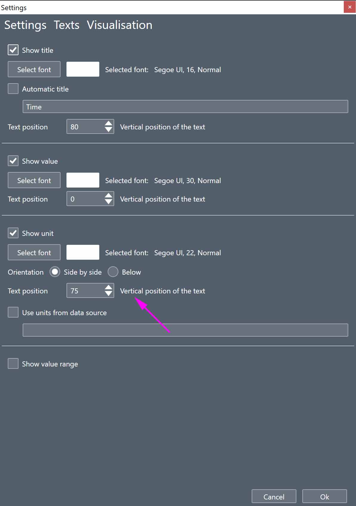

In playing with the new "Gauge" element in X13, it appears there may be a localization error?
Under the 'Text' tab, in the 'Show unit' section, the 'Text position' description shows 'Virtual Vertical position of the text'.
But the value actually appears to affect the horizontal relationship between the 'value' and the 'unit' displayed.
Edit: spellcheck bit me.

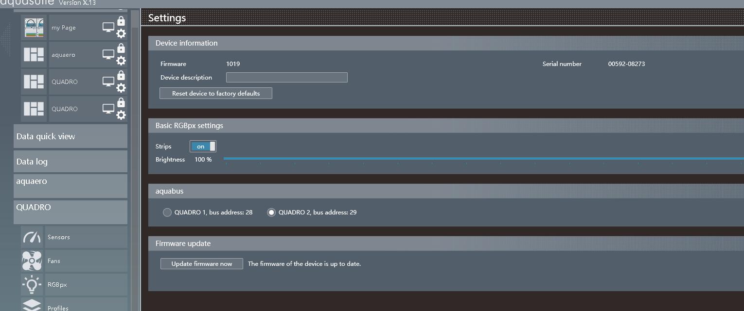

Since 1.2 I've not been able to control the RGBs on my RGBpx LED ring for aqualis 450/880, 15 addressable LEDs which is plugged into my D5 Next.
It shows on the RGBpx page, but with no output.
Same with v1.3.
Freitag, 6. März 2020, 12:57
Switch the Output mode in system tab from aquabus to rgbpx

WelshRambler
Freitag, 6. März 2020, 18:49
Awesome!
Cheers!

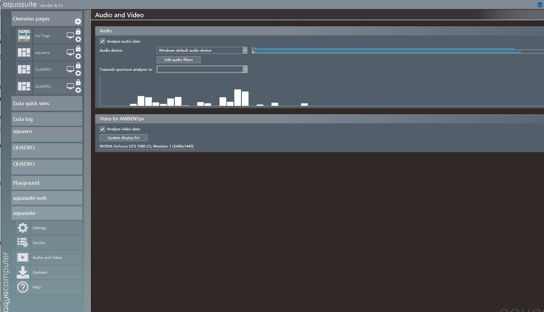

hello,Why my RGBFX sound bars mode doesn't work and the led doesn't respond to tasks,
Other sound modes are normal.
Looking forward to your reply. Thank you
The attachment contains the setup diagram.
