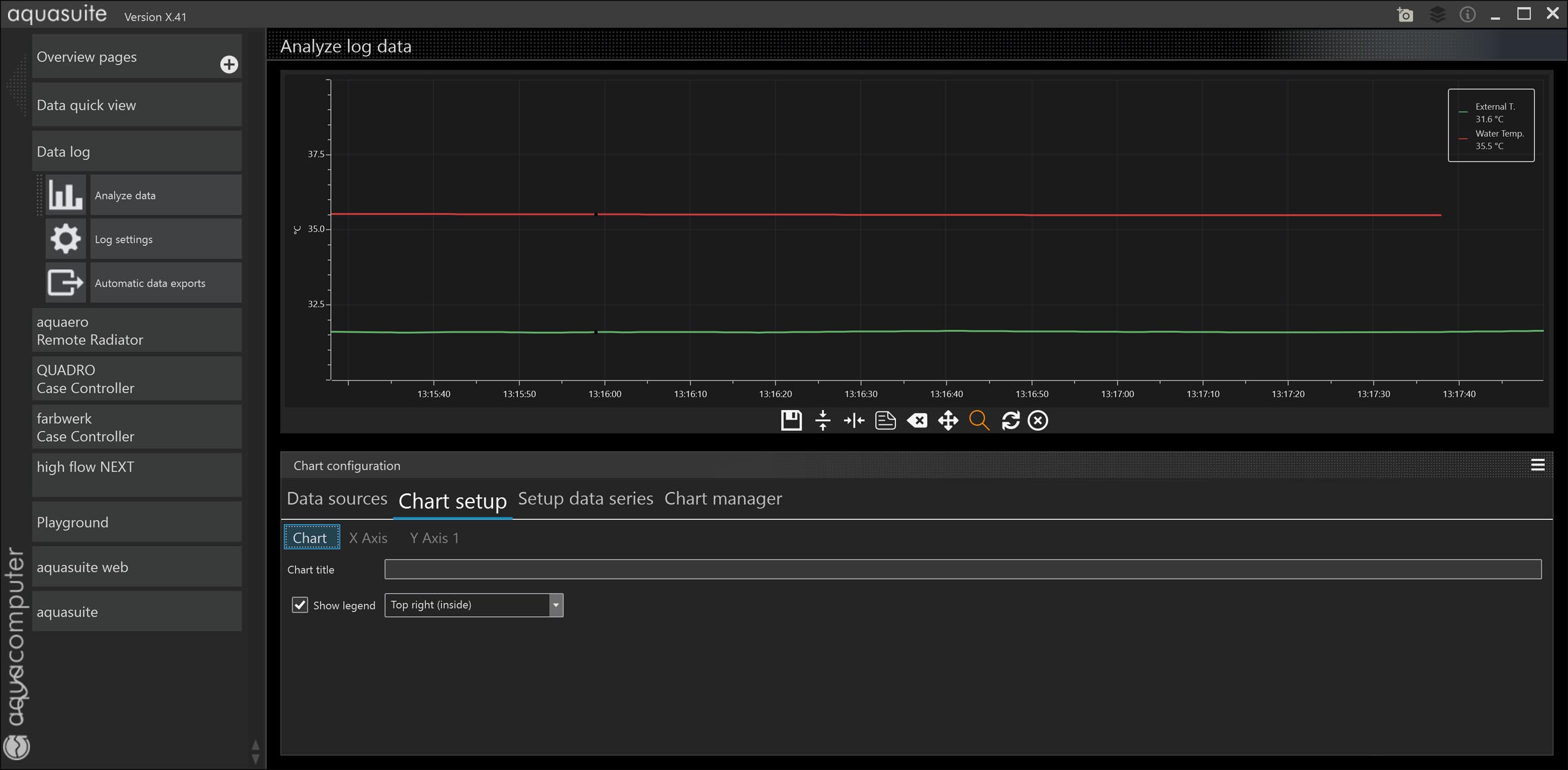

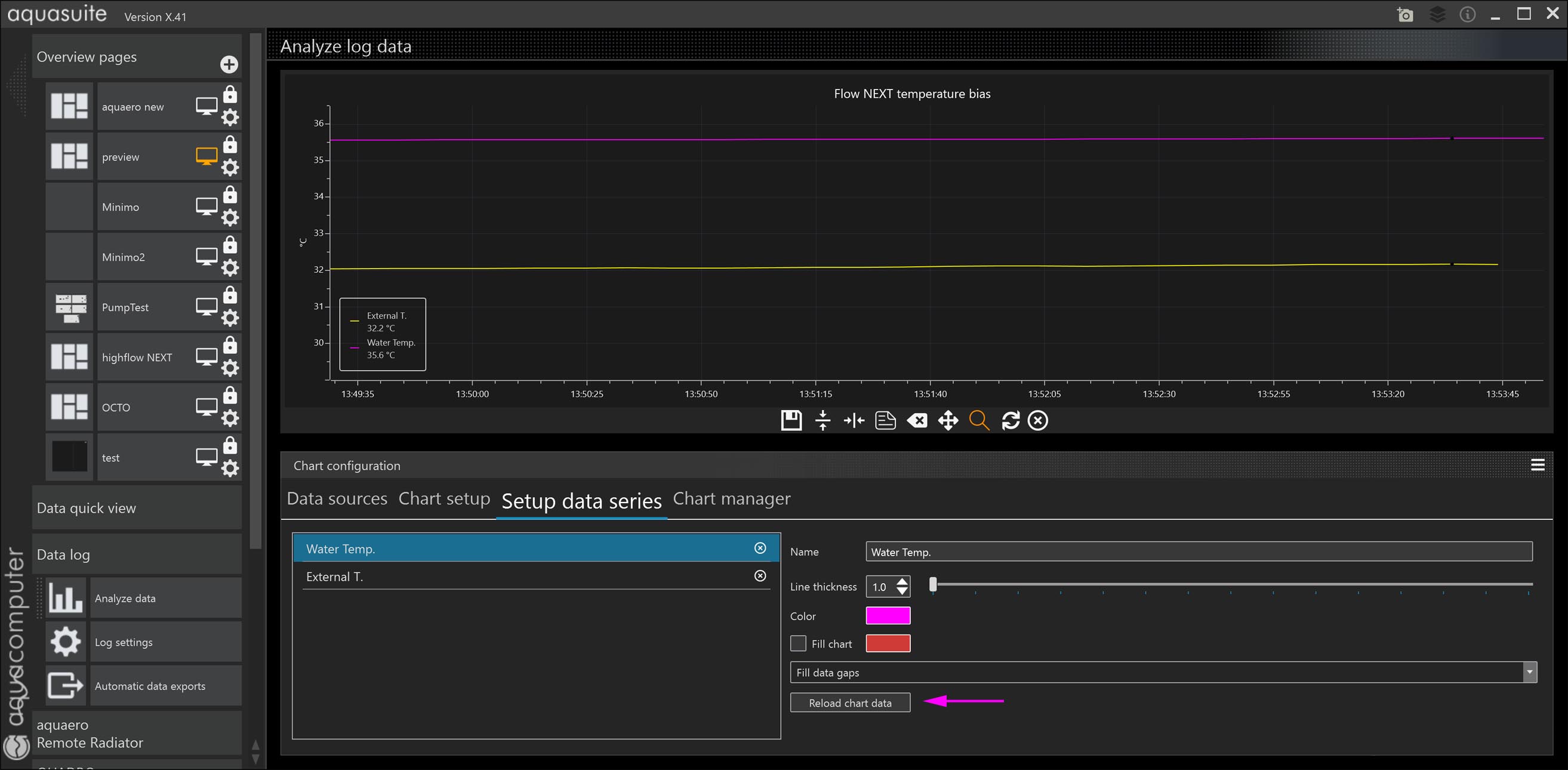

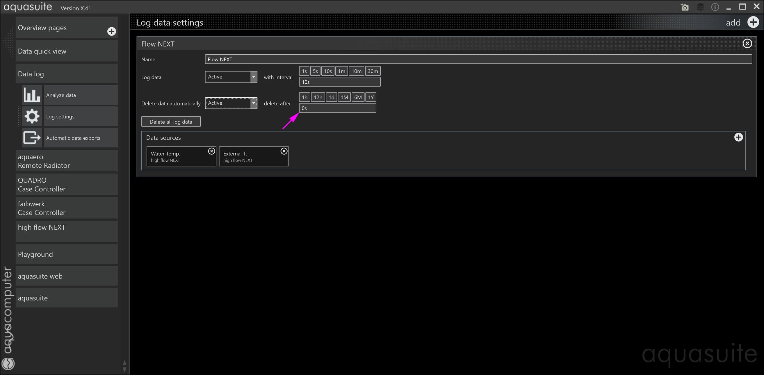

Couple miner issues I noticed using the Logger today
  • in setting up a logger I generally auto delete to keep the data file from growing too large
    If memory serves, the default value used to be 1 hour, but now it is 0 seconds (Log_Delete.jpg)
    took me a few passes to realize why I could not successfully create a chart
    may be useful to default to a positive value... 1 hour seems appropriate
  • in creating a chart, the fields for 'Chart' do not show until either the 'X axis' or 'Y axis' options have been clicked once
    pre-click (Log_Analyze_Init.jpg)
    post-click (Log_Analyze_Clicked.jpg)
Edit: If one clicks the 'Reload chart data' button when the data file is empty (first item above), the aquasuite dies (Log_Analyze_Reload.jpg)
