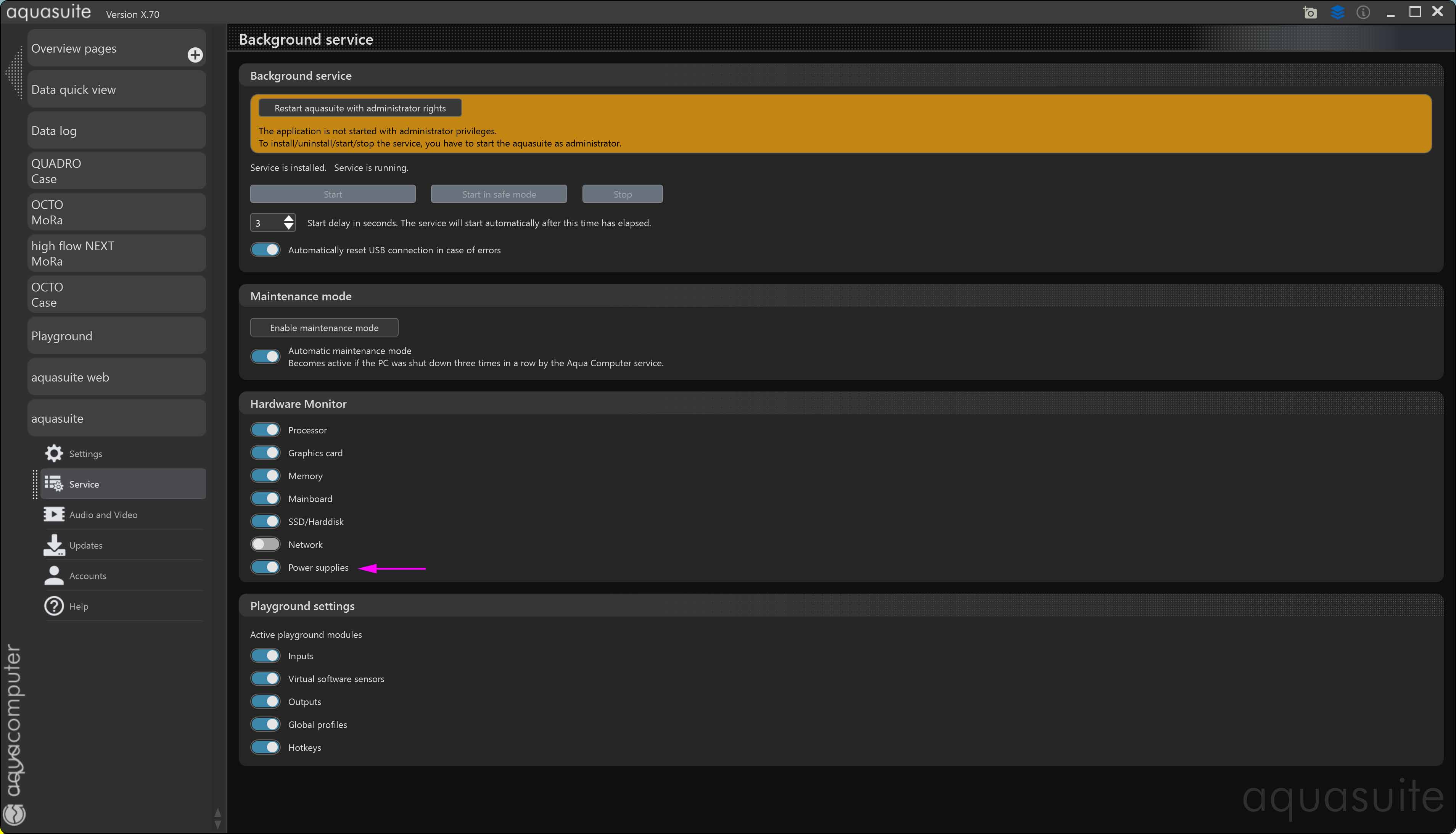

X70 thoughts
Freitag, 11. August 2023, 13:25
Nice graphical improvement.
Appreciate the 'Do not quit Aquasuite only minimize' option.
It would be useful if a right-click on the aquasuite system tray icon offered a quit option.
With the 'power supply' monitoring option activated I see no results.

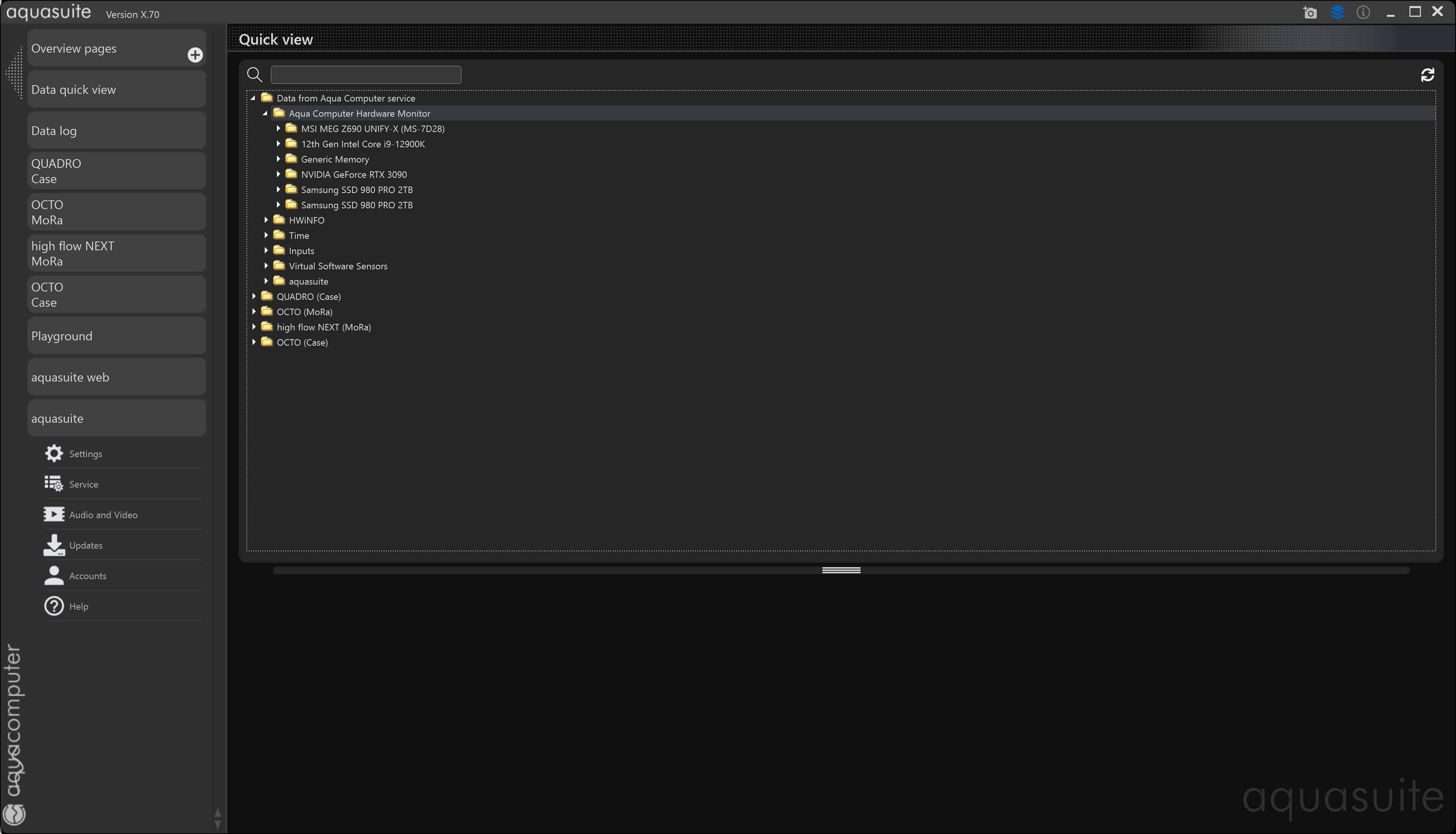

Freitag, 11. August 2023, 15:32
In the last few days, some Net updates have been rolled out.
Make sure that all Windows Update are installed.
Important: Update your GPU drivers.
Everything is up to date. Latest NET. and drivers, still I went back this morning to X69 and aquasuite runs nice...X70 sluggish
Even adjusting range voltage to my fan curve by increments using the up/down arrow I had to go slow, otherwise adding as usually with mouse click would be delayed and if I go try snappier click, it would then skip and jump to high because of the delay to begin with.
Note: I notice that even now as I type there are moments the sluggishness seem to go away and toggling between aquasuite menu is slightly better, but then after sometime goes back to snail speed again.... :!:
I will try is to install aquasuite X70 from scratch and not updating from X69 I doubt that will make a difference, but worth trying.
»Dundys« hat folgendes Bild angehängt:
Dieser Beitrag wurde bereits 8 mal editiert, zuletzt von »Dundys« (11. August 2023, 15:56)

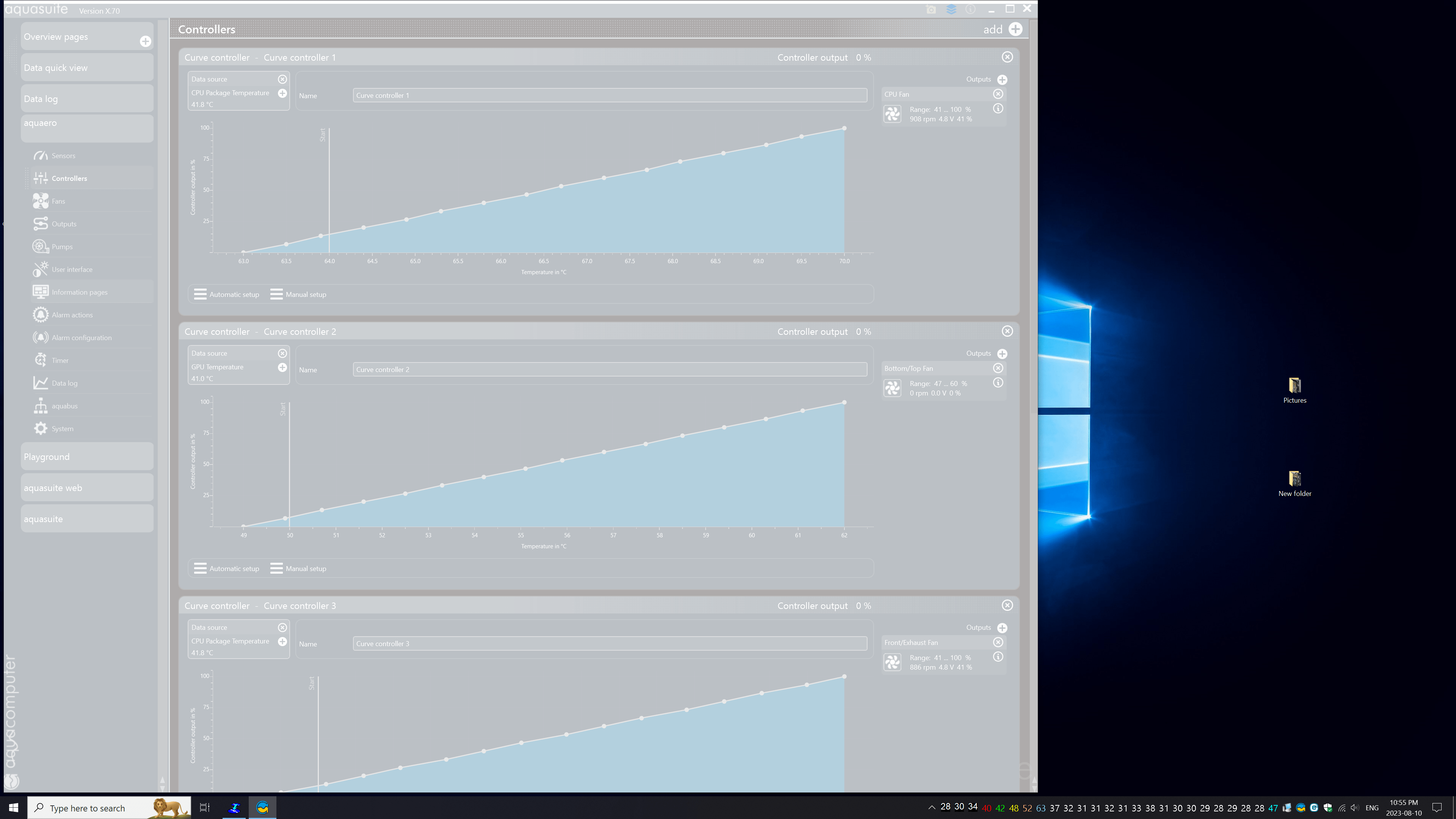

X.70 is sluggish on my system too.
Windows 10 ver 22H2 Build 19045.3324, R9-5950X, RTX 3080 w/ driver v536.99 (latest). I just downloaded and installed windowsdesktop-runtime-7.0.10-win-x64.exe which was released on 08-August.
I am in the Octo Fans tab just switching from port to port. There is a noticeable lag of 2 to 3 seconds, sometimes more. The previously selected port has a blue rectangle around it. The newly selected port has a white rectangle around it. When I click on a different port, there are sometiumes 2 to 3 seconds where the blue rectangle and the white rectangle are both visible. After these few seconds, the blue rectangle disappears and the white rectangle turns blue and the screen switches to the settings for that port. It's kind of hard to describe. Below is a link to a video that shows this. As I move from port to port I am clicking on the new port right away. Ports 7 and 8 are not used. The lag is definitely longer when I select these ports. Switching from port 7 to 8 took almost 5 seconds. Below the video is the list I get when I run dotnet --list-runtimes from a command prompt.
Also, when clicking on a device tab (like an Octo) it is very slow and jerky as the tab opens up. Sometimes its fast but other times its slow. It is not consistent. I can make another video of this if it would be helpful.
LAGGY Video
