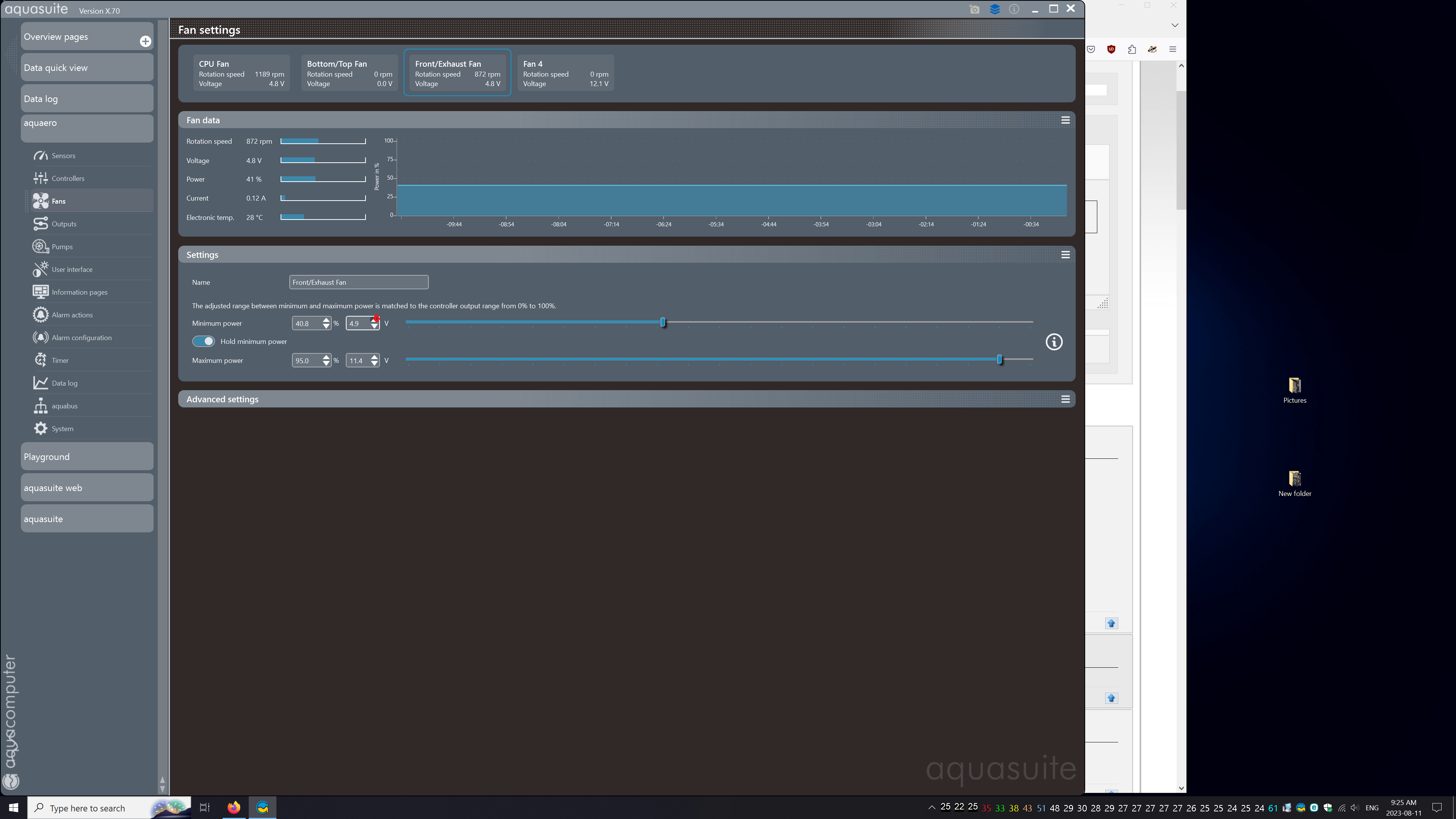

Everything seemed to be working fine until Aquasuite froze on me. I had just opened Data log - Analyze data and added 3 data sources to the graph. Then I clicked on one of my overview pages. At that moment, the program froze. It didn't crash, it just froze. I had to right click the icon in the task bar and close the application. Then I restarted it and everything seems fine again. I don't see anything in Windows event viewer (I am running Windows 10 ver 22H2 Build 19045.3324). Is there an Aquasuite log file that I can check for info on what caused the freeze?
Not only X70 freezes, but it also feels sluggish when toggling. I restarted my system few times and while I was re-encoding 4K video it froze again and this was never issue with X69
Dundys has attached the following image:

Everything is up to date. Latest NET. and drivers, still I went back this morning to X69 and aquasuite runs nice...X70 sluggish
Even adjusting range voltage to my fan curve by increments using the up/down arrow I had to go slow, otherwise adding as usually with mouse click would be delayed and if I go try snappier click, it would then skip and jump to high because of the delay to begin with.
Note: I notice that even now as I type there are moments the sluggishness seem to go away and toggling between aquasuite menu is slightly better, but then after sometime goes back to snail speed again.... :!:
I will try is to install aquasuite X70 from scratch and not updating from X69 I doubt that will make a difference, but worth trying.

There is another weird thing that I just notice. While I'm toggling in "Fan Settings "menu with my mouse between fans , just like Speedy-VI video shows, my fans are ramping up, which was not happening before.
Going back to X69 until X70 is fixed :thumbdown:
