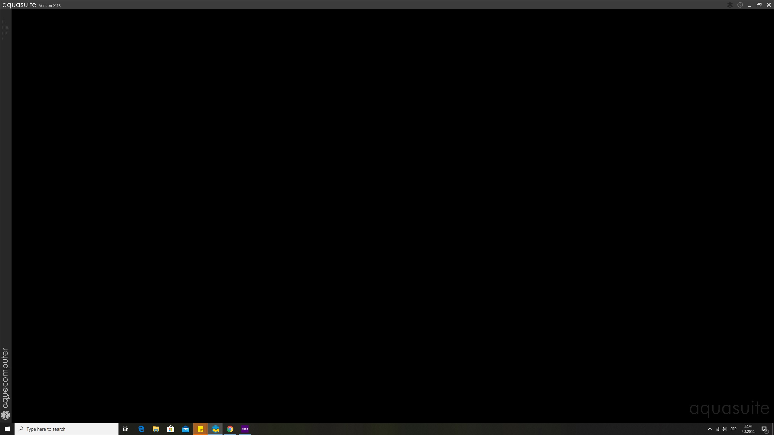

My aquasuite got updated today and I, changed the theme to "Dark" and this is what I get when I open aquasuite. :( Can't use itACupdate.jpg
Maki911
mercredi 4 mars 2020, 23:37
Nevermind my post above, the inability to use aquasuite came from 2k malwares my PC had (after clean up everything was running smoothly). - Admin please delete my two posts here, it's just cluttering the thread.
jeudi 5 mars 2020, 07:21
My aquasuite got updated today and I, changed the theme to "Dark" and this is what I get when I open aquasuite. :( Can't use it[attach]7266[/attach]
you have to click to the left sidebar to open the navigation.
