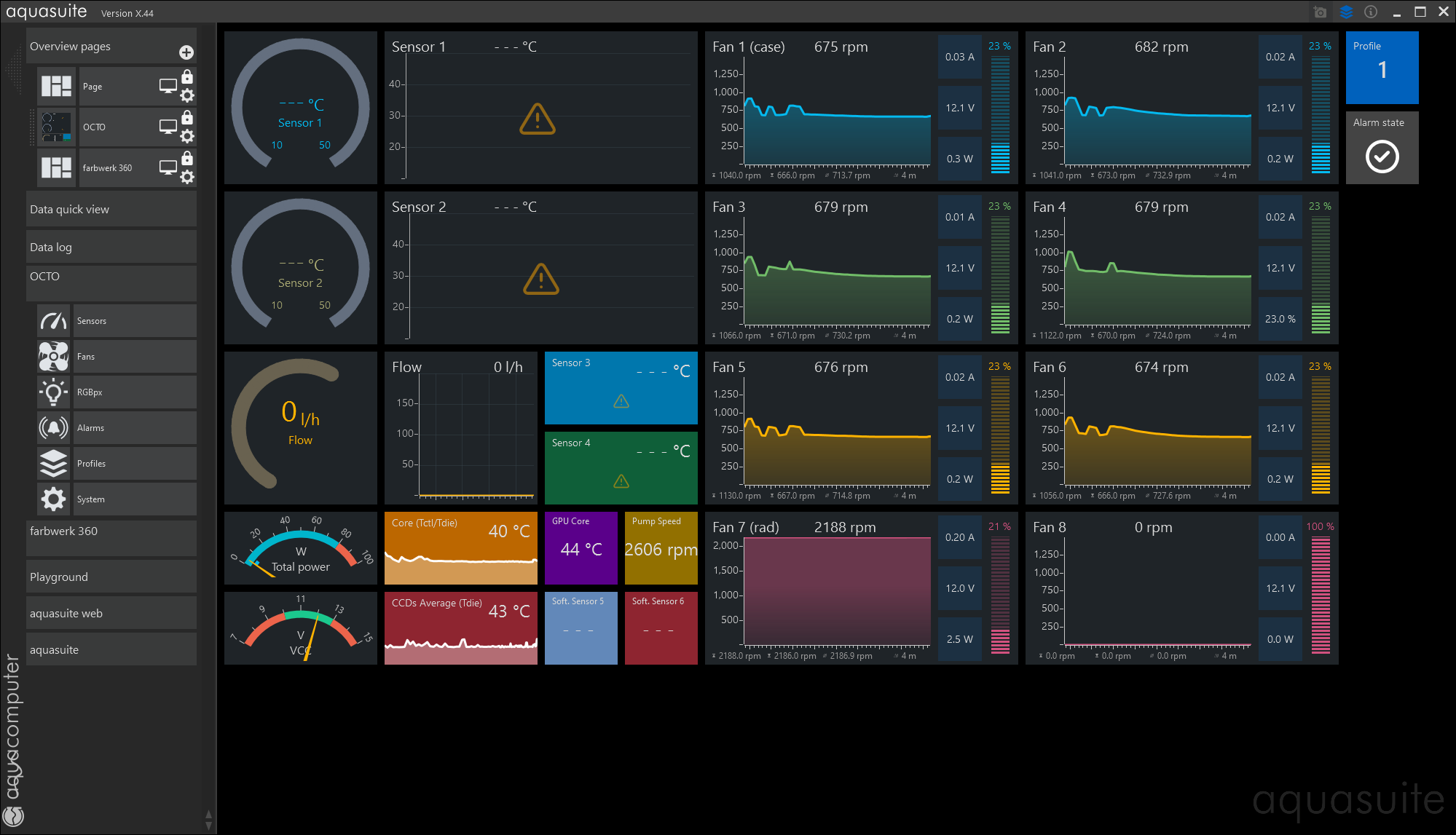

Update seemed to fix my problem with my EK fans running at 100% all the time for a few hours, now they're back to running at 100% all the time again.
Other fans (CoolerMaster) are running fine as they're supposed to: if they're set at 22%, they run at lower RPMs, and follow the curves. It's only the EK fans that randomly decide that they're tired of following the fan curve and just run at 100% anyway.
Seems like somehow they aren't getting the proper voltage fed to them from the OCTO? Here's a screenshot showing what's going wrong from the OCTO control panel in AS. Latest version X.44. The EK fans are Fan7, all the others are CM. All are PWM.
»shrubdog« hat folgendes Bild angehängt:
Remayz
Donnerstag, 2. September 2021, 09:27
on your other screenshots there's something weird.
the fans read 0 RPM in one side, and 2200 on the other. The octo is boosting them to the fall back speed because it doesn't get a speed reading.. but it shows one somewhere else.
Maybe you should try a clean install, seems something is off with Aquasuite

Still on latest version, still having all kinds of problems. I had to move my computer to a different site to do some work, so I carefully loaded it, and carried it a few hundred miles to where I needed to go.
When I set it up again and booted up: the:fans wouldn't spin up on boot. They just twitched a little. Got constant connect/disconnect chimes from Windows, as if the computer couldn't connect to the OCTO. I have changed absolutely nothing, except doing regular Windows updates. (That and it's on a different network.)
I tried unplugging/plugging, rebooting, removing all USB devices-- you name it, I tried it. Still wouldn't start up fans on boot.
And as I was typing this message, suddenly the fans spun up at 100%, and AS nuked all of my settings, mysteriously everything works, and I have no clue why.
This is getting really frustrating.
Is this a defect in OCTO, in AS, my USB bus. or... what?
EDIT: The problem has returned. I suppose I'll try reinstalling AS, but I don't see how that will help get the fans to be recognized on the USB bus at boot-- the computer for some reason isn't recognizing the OCTO anymore at boot, and it's just going into the "trying to connect/failing to connect" loop in Win 10.
EDIT2: As soon as I uninstalled AS, the fans came on.
EDIT3: Well, now it's another day, and the fans won't come on again. I tried uninstalling AS, but now that doesn't get them tp work. I'm at a total loss for what's going on.
Dieser Beitrag wurde bereits 4 mal editiert, zuletzt von »shrubdog« (16. September 2021, 15:18)
