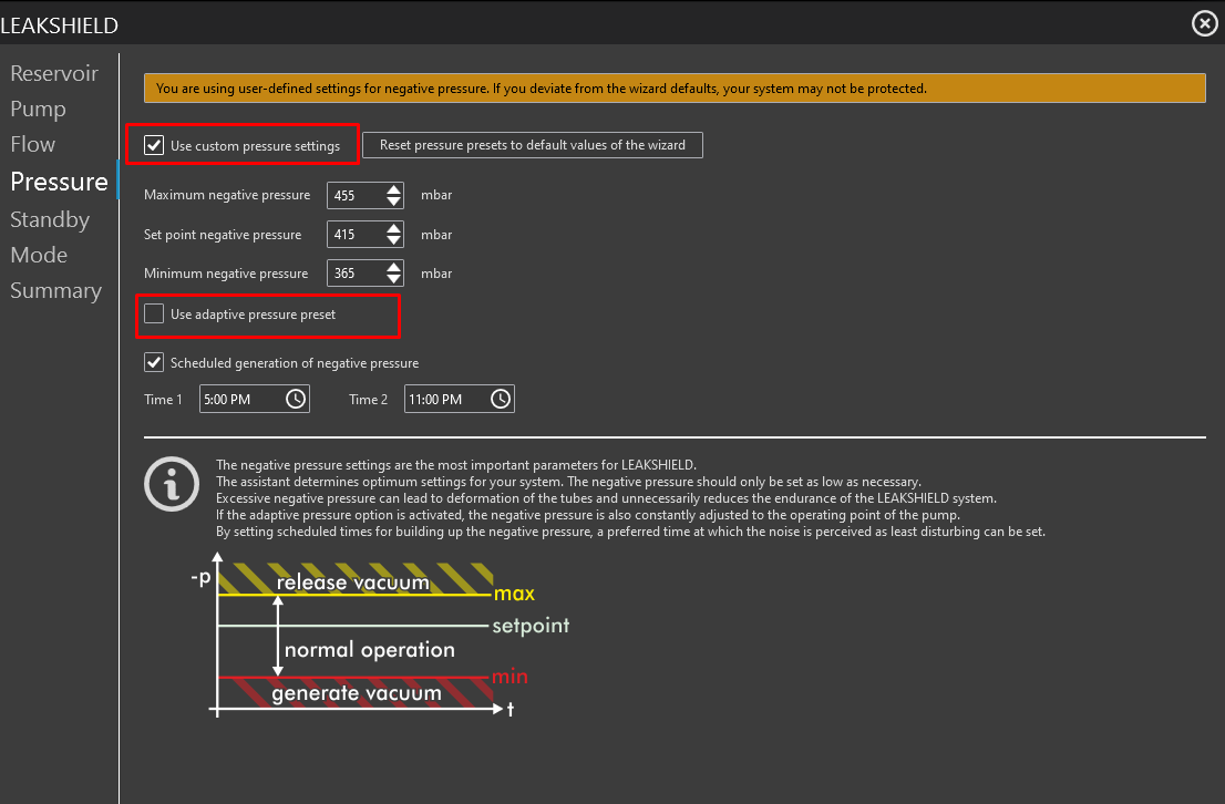

I just updated my Aquasuite to X41 and also upgrade the firmware on Leakshield, seems like the pressure on Shield mode have changed dramatically after the update, right now my Shield have a negative pressure around 160-170 mbar and before was around 400 mbar, is this working as expected in the new update or there is a bug?

DaLiu
Montag, 19. Juli 2021, 17:18
After some more investigation I found out that by default Leakshield use adaptive pressure preset which before the update was keeping my Leakshield pressure around 400 mbar but after the update for some reason it dropped to 170 mbar. I unchecked of use adaptive pressure preset and checked use custom pressure settings and now Shield is using 400 mbar negative pressure again, not sure if good or bad, I am waiting for Aquacomputer stuff to reply on this.
