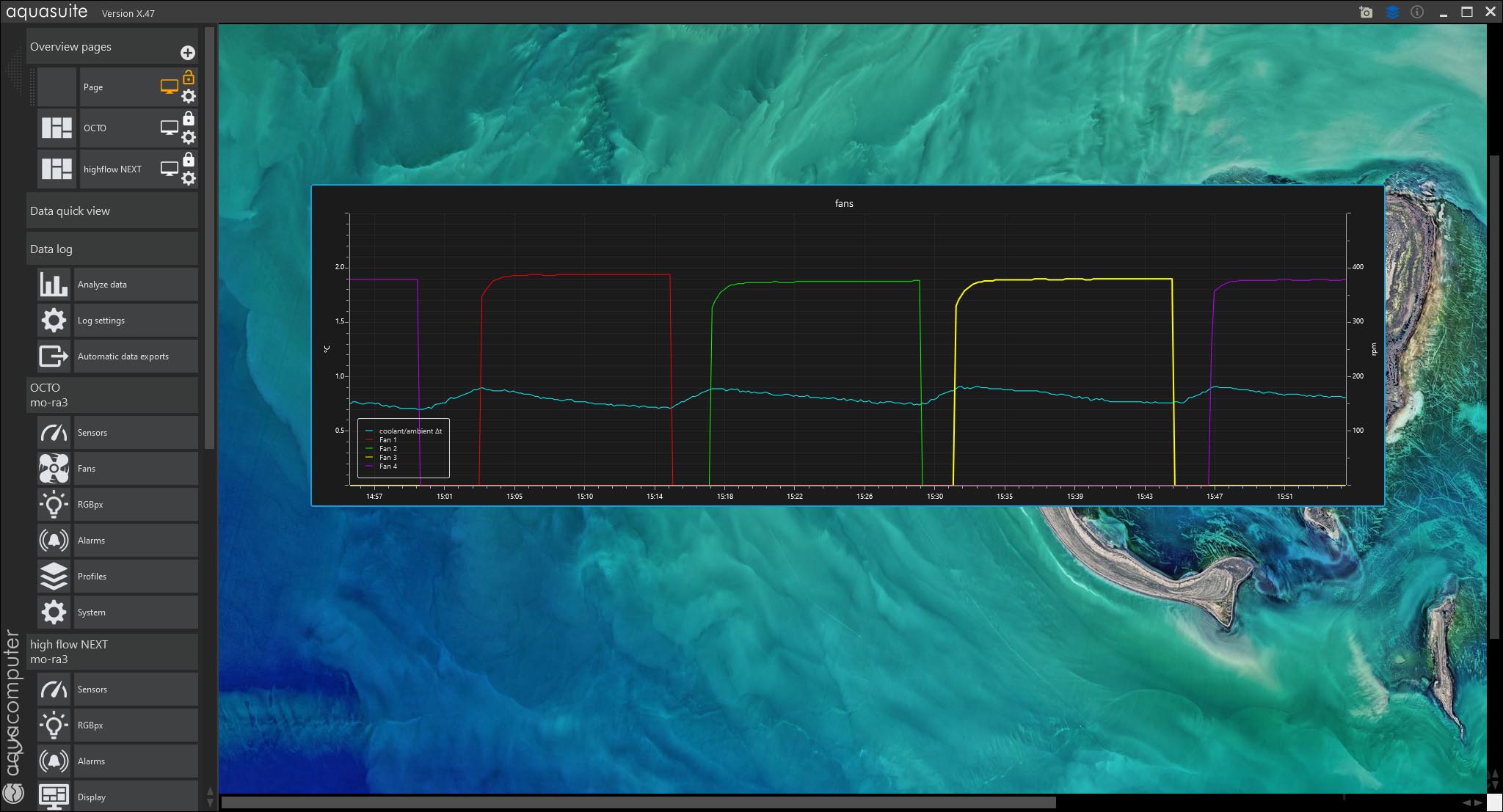

Still occasionally seeing the X-axis of displayed log data charts being wildly off.
  • added 8 data channels to a Data log {[attach]9149[/attach]}
  • added the data to an Analyze data chart (X-axis displays properly) {[attach]9150[/attach]}
  • when added to a display page the X-axis is off by decades {[attach]9151[/attach]}

By occasionally do you mean that sometimes it does this and sometimes it doesn't, or its it repeatable? I have noticed some weird things with axis scales when adding a data chart to an overview page but I dismissed it as being due to me not understanding something. I just tried doing what you did (not exact) then added the log data chart to an overview page. The axis are correct.
I don't quite understand what the Refresh Interval does in the data chart settings in an overview page. I set up 2 identical charts and set one refresh interval for 30 minutes and the other for 2 minutes. I did note that any value input to the refresh interval box less than 2m 0s is rejected and reverts to 2m 0s. AQS does not make the invalid number turn red or otherwise indicate that the refresh interval is invalid. If you enter a value less than 2m 0s and press OK, it appears to accept it but when you re-open the Settings box it is set to 2m 0s again. If you enter a value less than 2m 0s and then press Enter, you can see the value revert to 2m 0s. The Refresh Interval does not appear to change the appearance of the chart or the axis scales. I guess a higher refresh interval could add granularity to the chart? With a minimum 2m 0s refresh interval, it seems like it would not be able to track short transients like GPU temp spikes and is intended for data that has long term (over 2-minutes) trends. You can zoom into a chart in the Data Log section but you can't zoom into a chart in an overview page. I feel like I am missing something here. Sorry if this is off track.
Sometimes it raises it's ugly head, other time not. I have not been able to replicate or force the error. At one time I thought it may have been related to activating the data delete function, but nothing repeatable there either.
I did repeatedly push the chart to the right on the editable display pager, then drag the left border to the left each time, thereby expanding the width of the chart significantly. When the error is present, It appears the start date at the left side of the chart is <=> 1970.01.01
The chart to the right is similar to the failed one I attached previously (same 4 fans but one Δt in place of the four controllers), and it looks normal. {chart_good.jpg}
The refresh value simply dictates the frequency the chart is updated/redrawn. I am not sure why there is a 2 minute refresh limit, but assume it to be related to what, at one time anyway, was considered a heavy process load.
Refresh Interval - I get what it is doing and can see how it affects the chart in the overview page over time. I inserted 2 log data charts of the same data with the maximum difference in refresh intervals (2m 0s and 1d 0m 0s) and can see how over time their x-axis slowly diverge. The chart set to refresh every 1d 0m 0s does seem to update a lot more often than that but the latest time value on the x-axis is older than the latest time value on the x-axis on the chart that is set to update once every 2m 0s. Shouldn't the chart set to update once every 1d 0m 0s only change once per day?
If I export a data log chart from an overview page and import it into a new overview page, the new one seems to update as the same rate as the original (which makes sense) but I did notice that they don't update at the same time. If I stretch a data log chart in an overview page to the far right then back towards the left, making the chart wider then less wide, the latest value on the X-axis appears in the wide chart but then disappears in the less wide sized chart. It seems like the latest time value displayed on the x-axis should always be the same no matter how the data chart is sized. Stretching a log data chart then unstretching it seems to mess up the latest value displayed on the x-axis. The start time/date of the charts was always correct so the bug you have experienced did not happen while I was playing around. If I ever see it do what you have observed, I will try to repeat it. If the bug is not repeatable, it is less likely to be addressed.
I copied my 2 minute update chart and changed the pasted version to daily update. It has been over 5 hours and there has been no update to the chart for me. Is there a chance you closed aquasuite restarted later? The chart will redraw with current data on a start.
The 2nd chart starts at a different time, so the x-axis will display different time.
I don't think you ever see the oldest/newest time on the chart. The chart applies a scaling and fills in values as possible.
Montag, 7. Februar 2022, 23:24
It is possible. I noticed that if I open the data log and click OK without changing anything it will update the chart. If I click Cancel instead it does not update the chart. I was clicking around a lot so may have forced a chart update. I will let it run for a few hours today without touching it.
UPDATE - I was wrong. Opening settings then clicking on Cancel without changing anything does cause the chart to update. I let it run for several hours last night and you are correct. The chart set to update once per day did not update while the chart set to update every 2 minutes did update multiple times. Thank you for helping me to understand this.
That makes sense. I have found that when something does not look right to me in AQS it is usually because I am doing something wrong or misunderstand something. Thanks for your insights.
