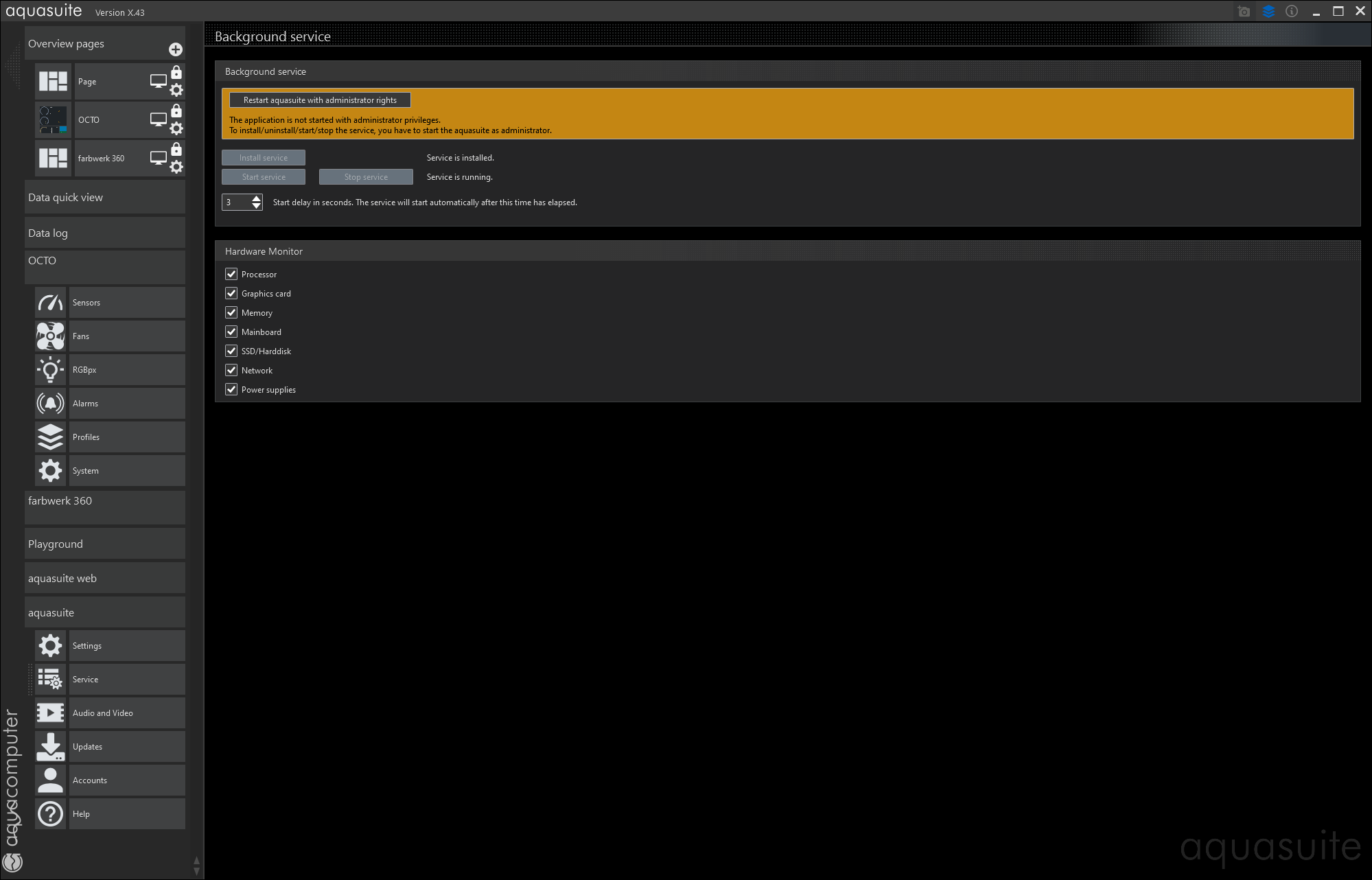

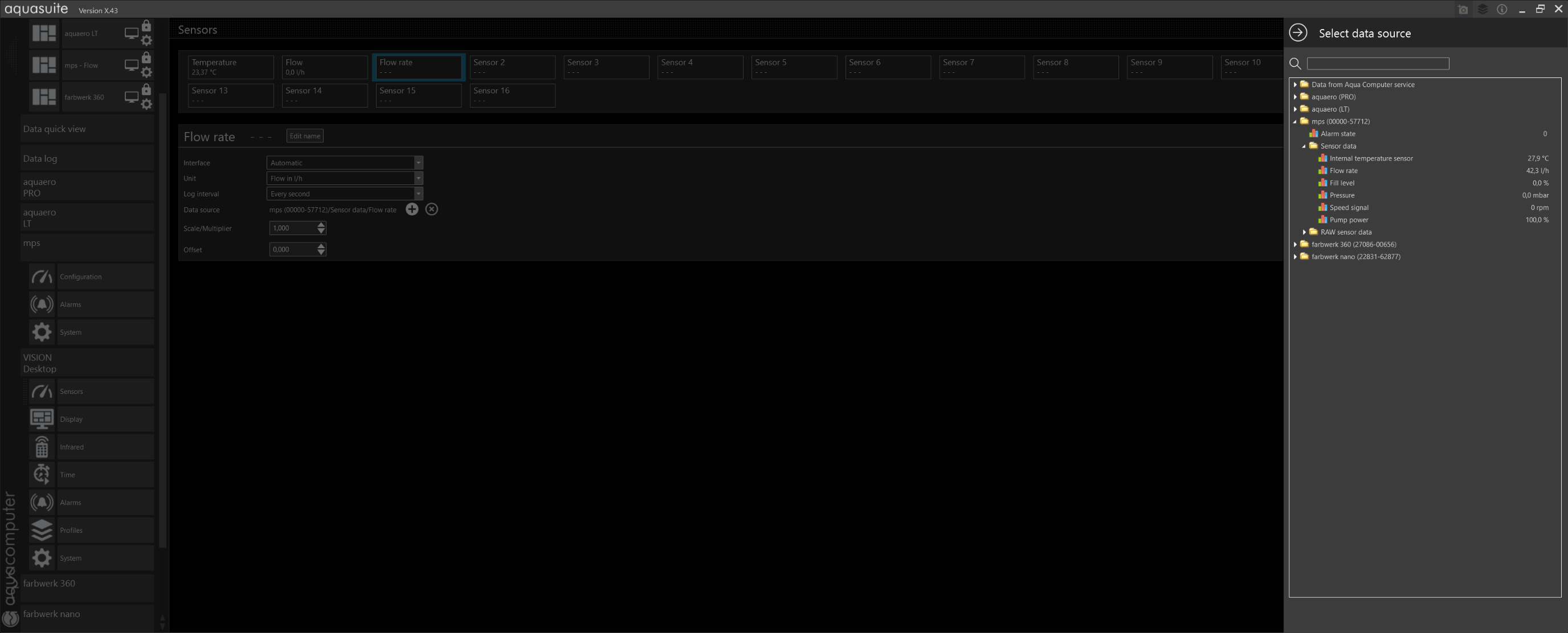

Dear ac,
I have problem with flow sensor . Value does not show on Vision. This problem was in the past too after another update. See pictures below.
Thak you.

woizzz
Friday, August 27th 2021, 8:04pm
Same issue as AE5probigNGslave posted above.
After update to X.43, sensor data from MPS connected via USB doesn't shows in software sensors.

Monday, August 30th 2021, 9:56am
the bugfix release is online.
woizzz
Monday, August 30th 2021, 11:50am
Works great now! Thanks
AE5probigNGslave
Monday, August 30th 2021, 9:12pm
Working...
Extraordinary support as always...
Thank you !!!
