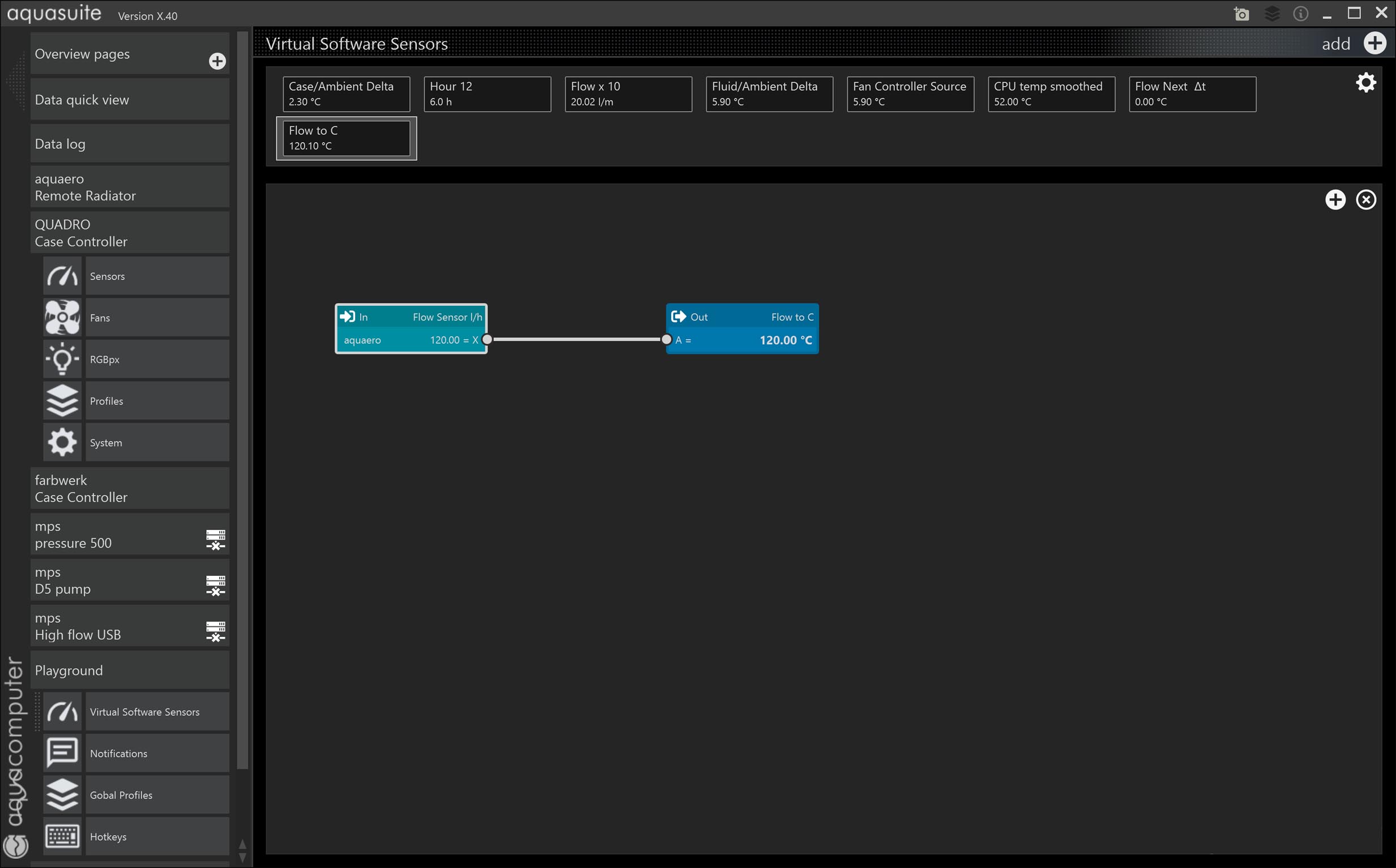

mardi 13 juillet 2021, 14:06
What I was curious to see was if I could adjust the pump RPM based on flow. If I can set a flow amount I want it to hit then let it adjust the pump RPM accordingly.
Not directly.
There is an artificial limitation built-in to aquasuite Curve Controllers that allows only temperature sources to be used to drive the Curve Controller.
This limitation may be spoofed using the Playground and converting Flow into Temperature. (e.g. lpm_2_t_spoof.jpg)
But this would be a bit of a Rube Goldberg solution.
If you want a specific flow rate, use a Power Preset Controller to adjust the pump RPM to yield the desired flow.
