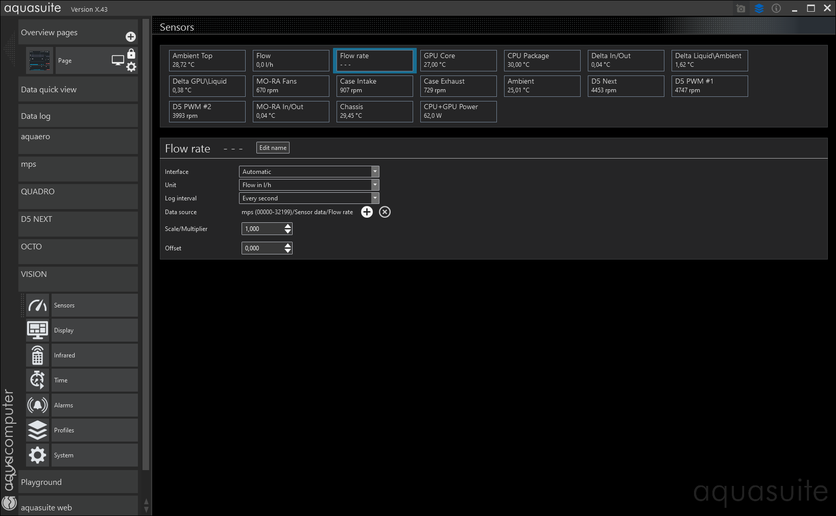

Dear ac,
I have problem with flow sensor . Value does not show on Vision. This problem was in the past too after another update. See pictures below.
Thak you.
AE5probigNGslave a envoyé les images :

woizzz
vendredi 27 août 2021, 20:04
Same issue as AE5probigNGslave posted above.
After update to X.43, sensor data from MPS connected via USB doesn't shows in software sensors.

lundi 30 août 2021, 09:56
the bugfix release is online.
woizzz
lundi 30 août 2021, 11:50
Works great now! Thanks
AE5probigNGslave
lundi 30 août 2021, 21:12
Working...
Extraordinary support as always...
Thank you !!!
