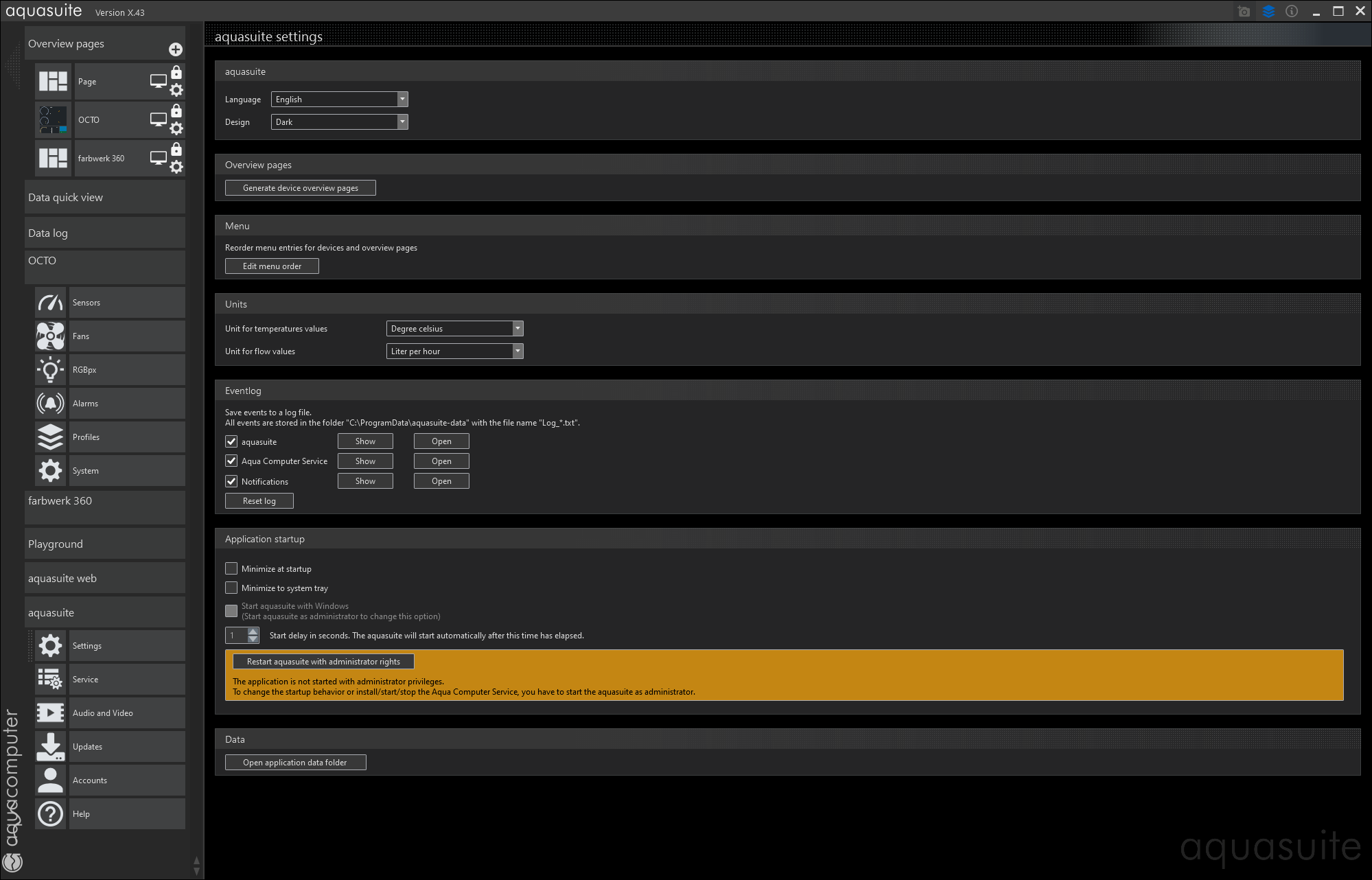

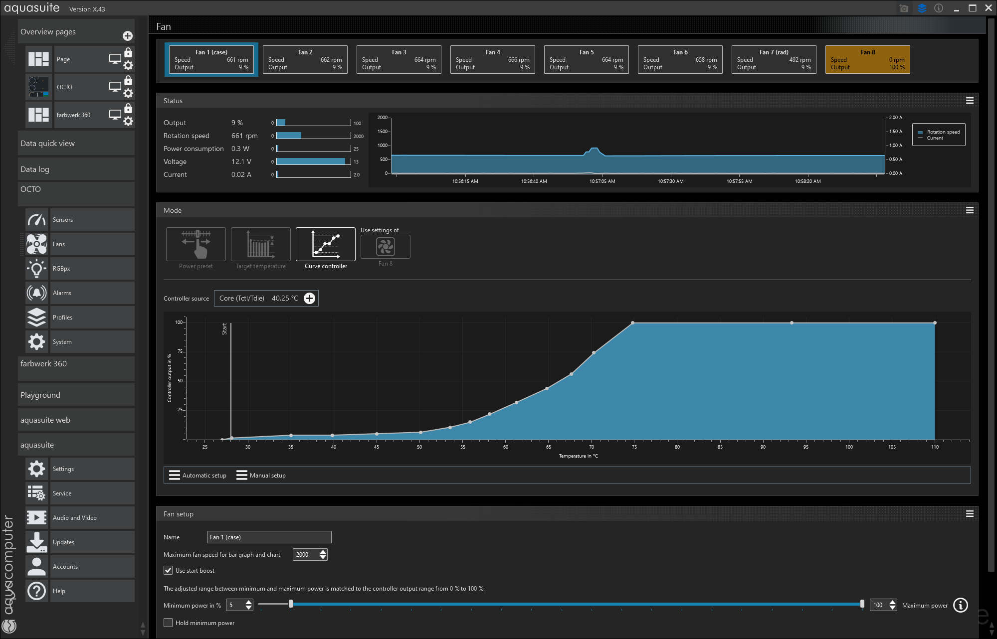

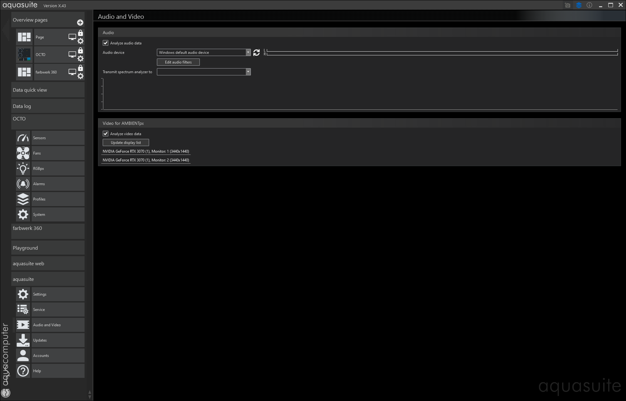

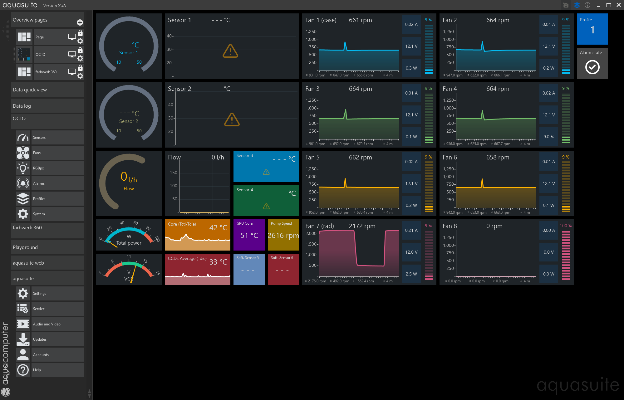

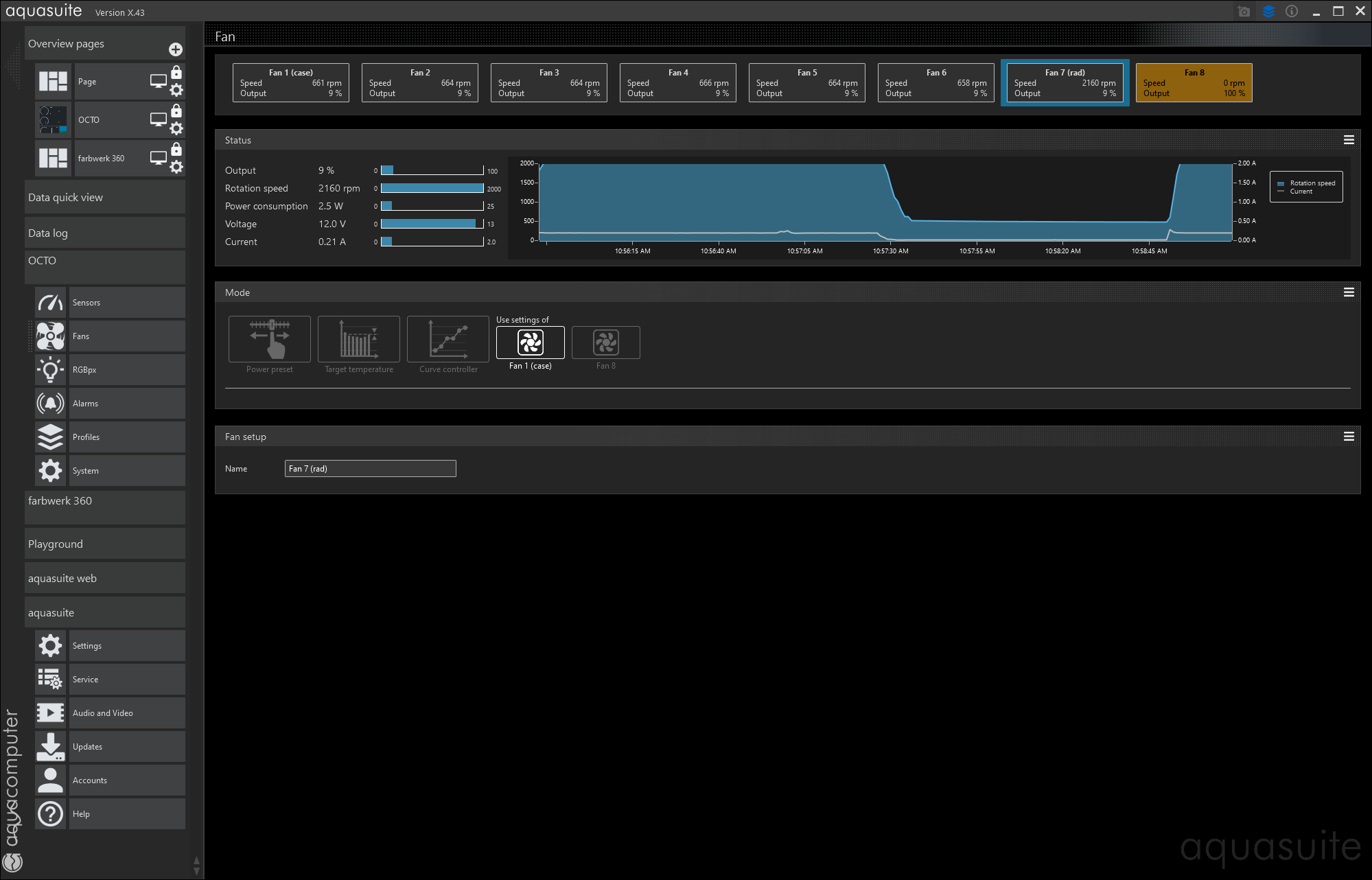

Okay, here are a few screenshots from my settings. Running version .43 now. I have attached them as I don't have image hosting handy.
Fans 1-6 are all Cooler Master case fans, fan group 7 is a set of EK fans that push air over my EK AIO 360 radiator. For some reason they are always spinning up to higher RPMs, even when I put them on the same curve.

I wondering why my Aquasuite looks completely different... Anyway, make sure that the fans are in the correct mode: [url]https://i.imgur.com/bXrlDWP.png[/url]
the EK fans have a zero RPM mode, they should stop below 25% PWM. I don't know how the AIO manages that, or if your fans are connected directly to the Octo, but that could be a clue. your fan curve goes way below that.
try going to "power preset" for speed control and increase slowly the PWM %, and see if at 25 - 26% they suddenly drop to their slowest speed, and then respond normally from there.
If that's the case, you'll have to make a second fan curve for the AIO

shrubdog
Donnerstag, 26. August 2021, 00:33
My EK fans respond all the way down to 1%, so the Zero RPM mode isn't activated on these.
Also, the interface for Fan Setup in my .43 version of Aquasuite doesn't have anything to select fan type, so I'm assuming that the OCTO is auto-detecting. (They're all PWM anyway.)
Of course, the system has been behaving pretty well today since I posted-- it might have been chewing on a Windows update.

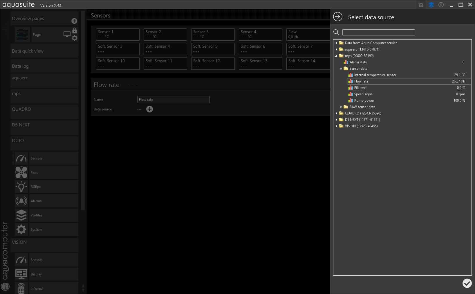

Dear ac,

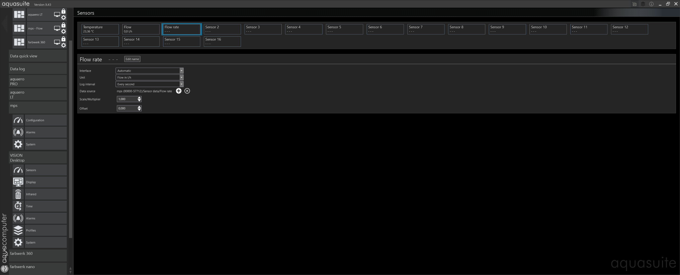

I have problem with flow sensor . Value does not show on Vision. This problem was in the past too after another update. See pictures below.
Thak you.

woizzz
Freitag, 27. August 2021, 20:04

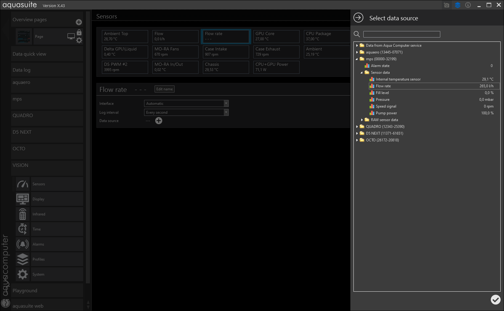

Same issue as AE5probigNGslave posted above.
After update to X.43, sensor data from MPS connected via USB doesn't shows in software sensors.

Montag, 30. August 2021, 09:56
the bugfix release is online.
Works great now! Thanks
Working...
Extraordinary support as always...
Thank you !!!
