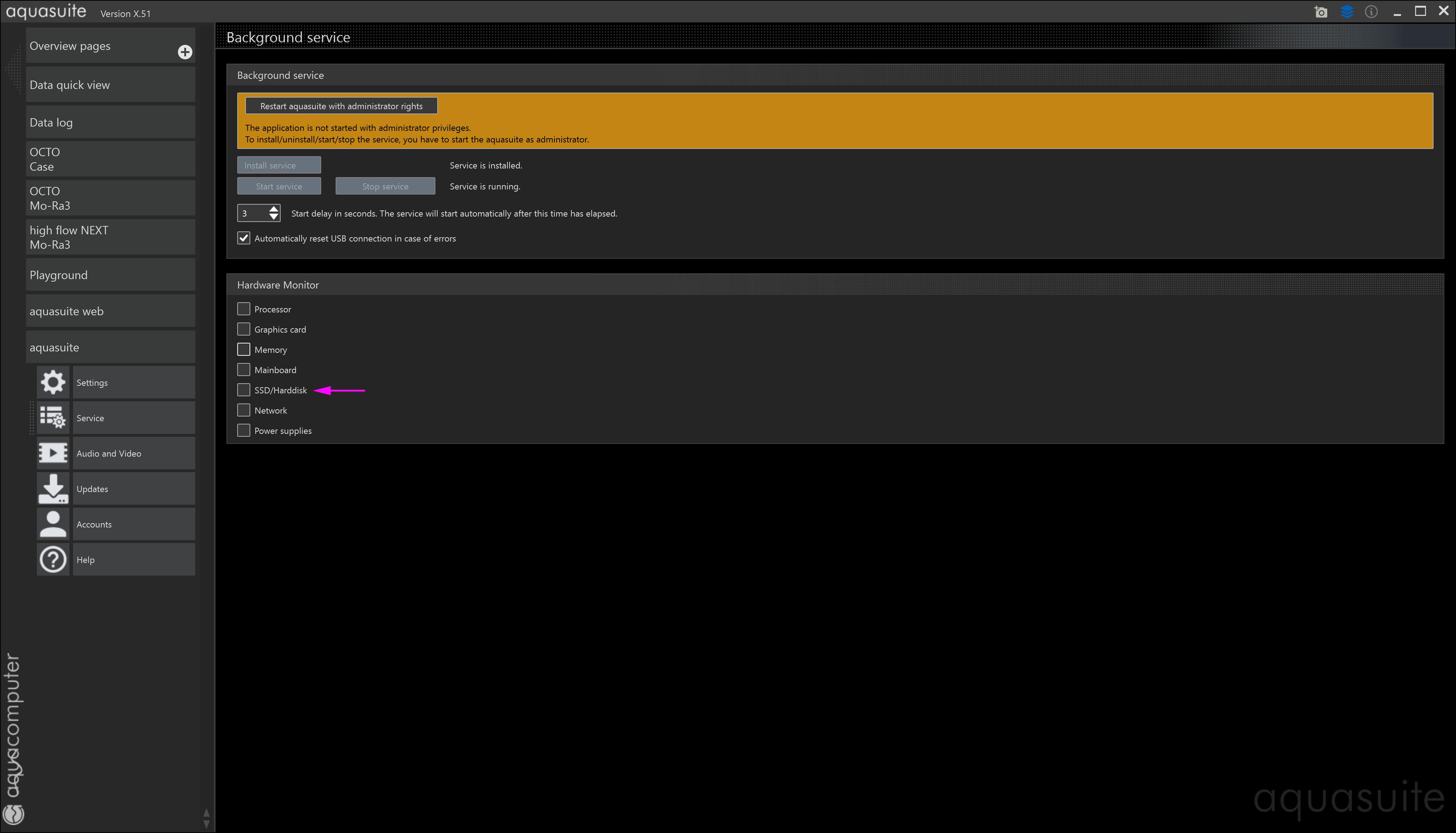

After updating AQS to X.51 temperature readout from my Samsung 980 PRO ssds is not available. On X.47 it was perfect, but on X.51 temp is 0.0*C. I tried restarting aquasuite, the computer aswell. Nothing helped. HWiNFO is showing temperatures, but new version of Aquasuite is not unfortunately...

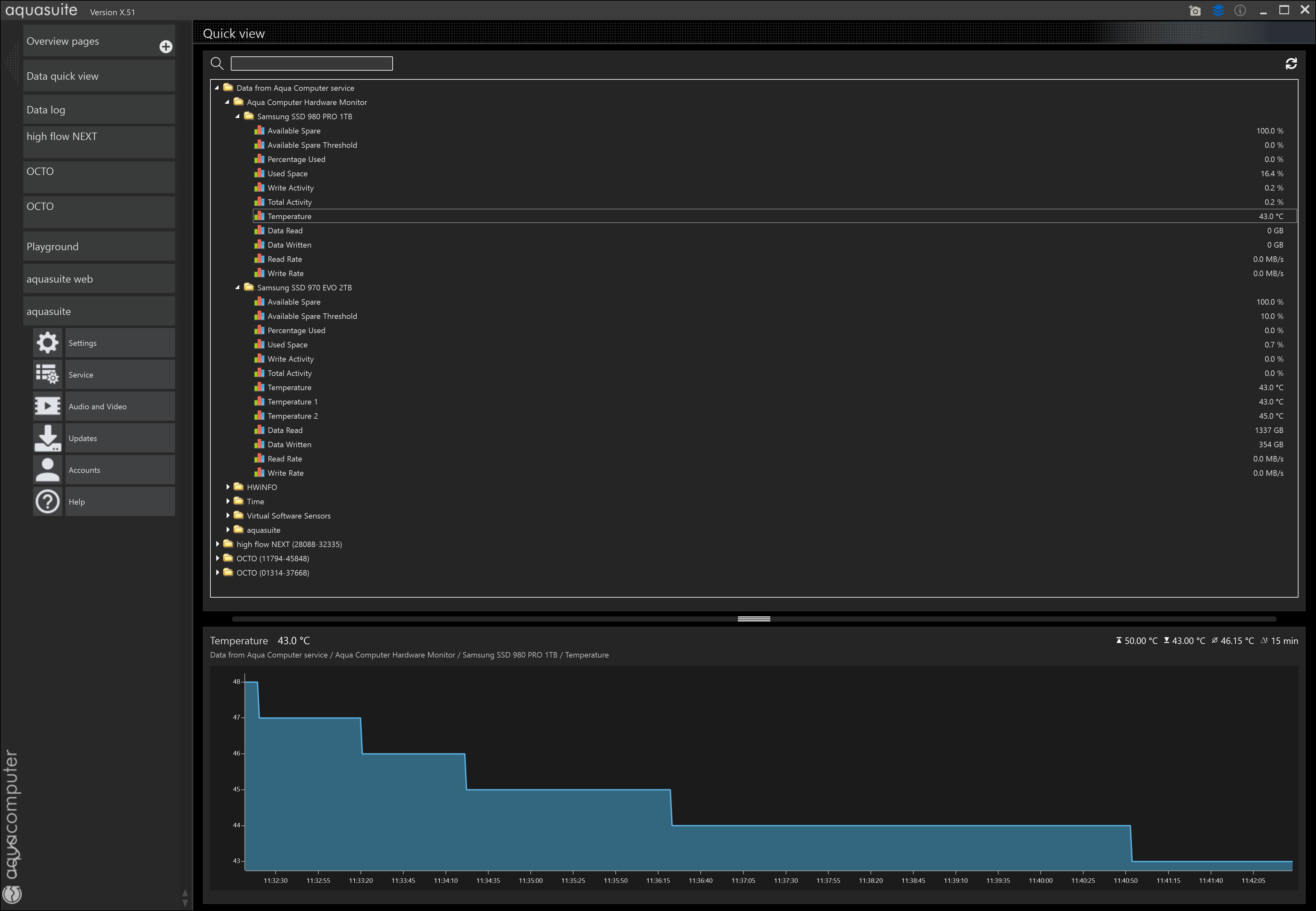

Mittwoch, 16. März 2022, 05:17
One of the items addressed on X51 is the hardware monitoring function. You should post info about your system: mobo, operating system and anything else pertinent.
Edit: assuming you have the SSD/Harddisk option selected (ssd.jpg)

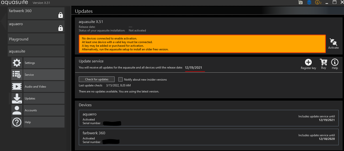

xCROv
Mittwoch, 16. März 2022, 14:45
Why does the setup show me only certain versions for download?
At startup, the setup checks the status of the update service of all devices detected via USB.
If the update service of at least one device includes the latest
aquasuite version, only this version will be offered for download.
If none of the devices has a suitable update service for the latest
aquasuite version, the setup also offers the last or highest version
that is covered by the update service of the devices.
It appears that this functionality is broken or not working as intended. Aquasuite offered an update that none of my devices supported. Not sure what version I was on previously but I had not updated in quite awhile. Started Aquasuite and was prompted to update. Updated, and currently all devices are locked for this version.

Mittwoch, 16. März 2022, 16:09
Edit: assuming you have the SSD/Harddisk option selected ([attach]9303[/attach])
CPU: i7 11700k
MOBO: Z590 Torpedo
OS: Win 10 64bit 21H1
AQS license on OCTO
980 PRO in PCIe #1 slot (PCIe 4.0 speed)
980 PRO in PCIe #2 slot (PCIe 3.0 speed)
both disks shows at 0.0*C
and ofc I do have SSD/Harddisk option selected.
I tried to unselect all except SSD in AQS, still nothing.
Mittwoch, 16. März 2022, 17:49
Setup, not update.
Download the latest installer

CPU: i7 11700k
MOBO: Z590 Torpedo
AQS license on OCTO
The aquasuite picks up my Samsung SSD 980 Pro (980pro.jpg)
CPU: i9-9980XE
MOBO: MSI X299 Gaming Pro Carbon AC
OS: Win 11 64bit 21H2
You may want to contact support directly.

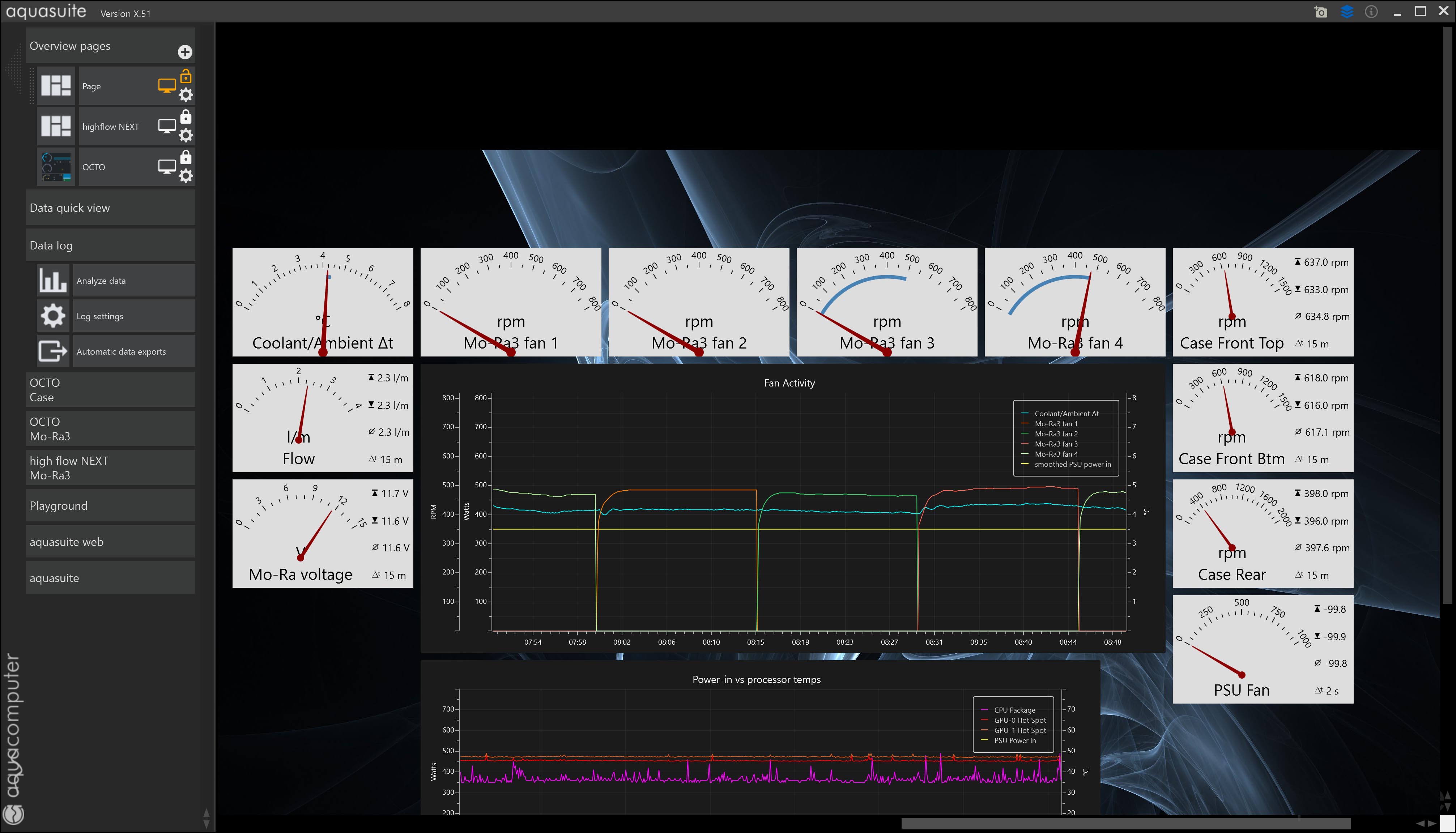

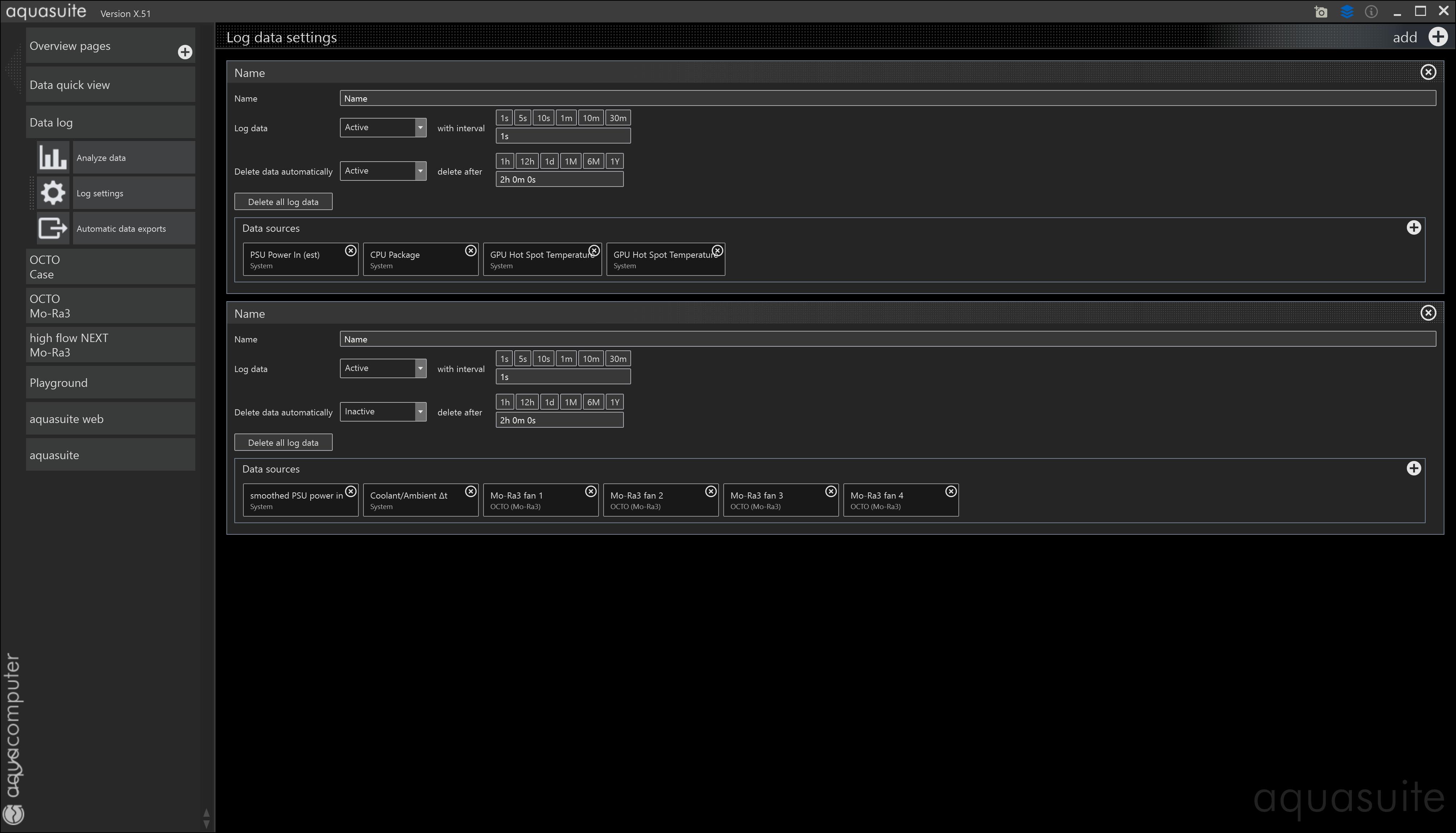

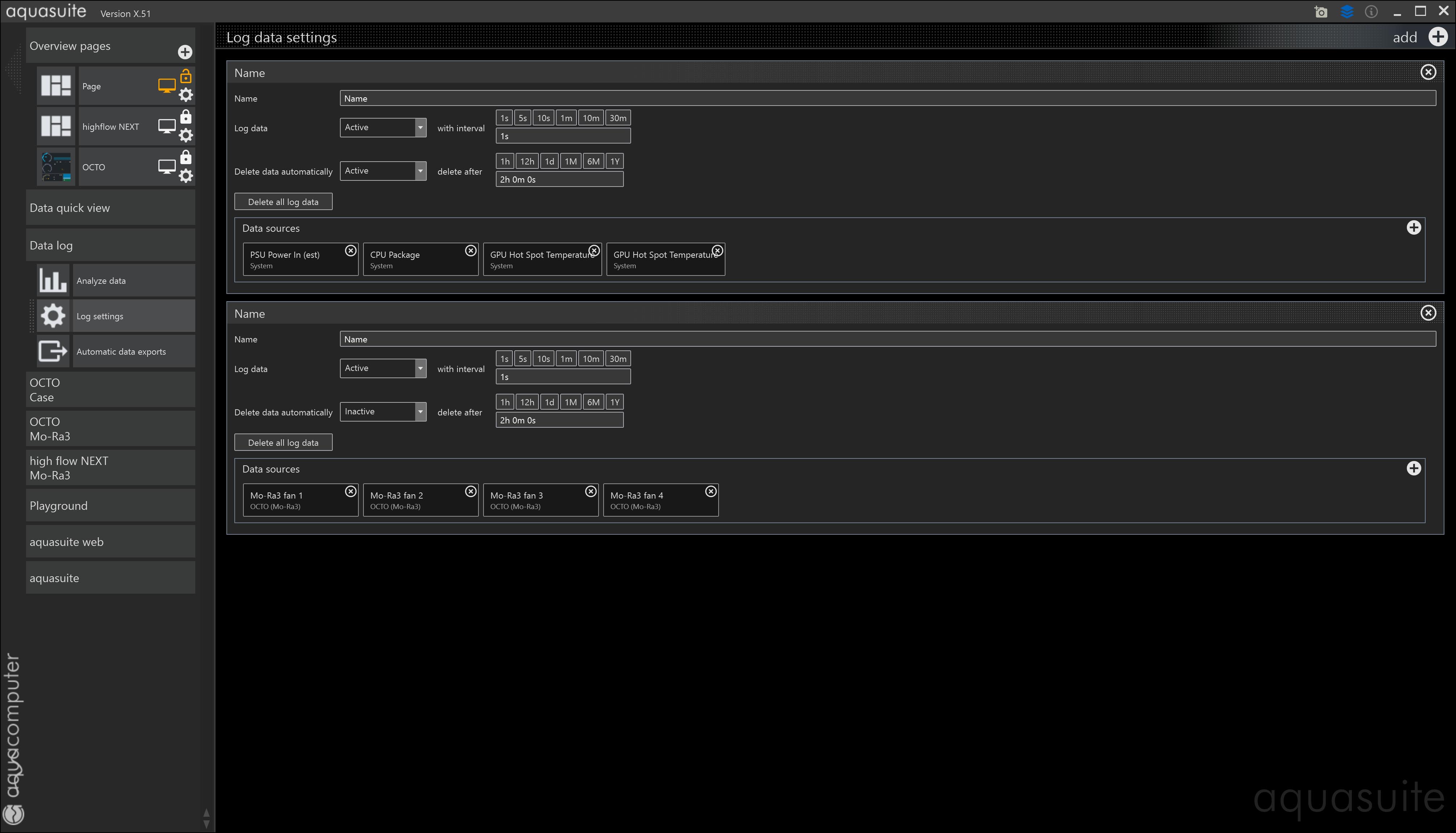

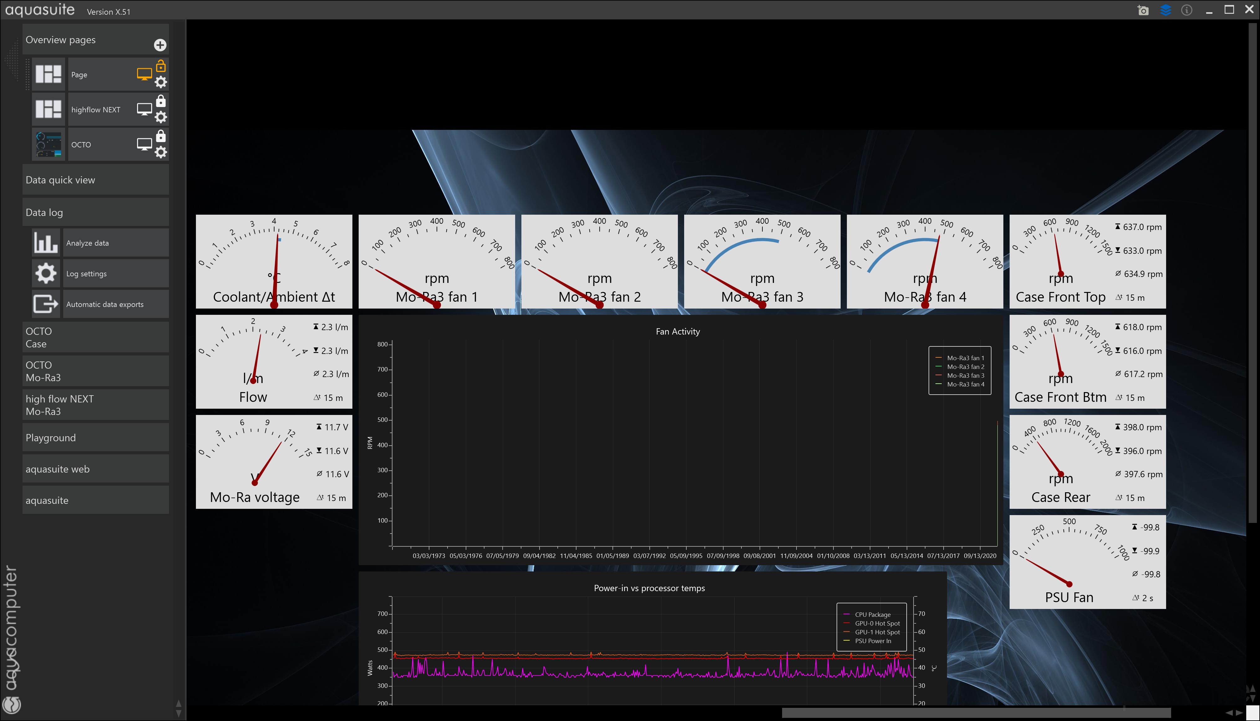

RE: continuing: log data chart issue on display page
Mittwoch, 16. März 2022, 23:23
Perhaps the following can be duplicated on the devs system:
  • existing Data Log settings ([attach]9307[/attach])
  • existing chart on a Display Page ([attach]9308[/attach])
  • deleted 2 sources from the bottom Data Log *[attach]9309[/attach](
  • modified Data Log shown on Display Page has X axis starting January 1973 ([attach]9310[/attach])
I had a Data Log with 6 sources running, and an Analyze Data chart shown on an Overview Page
I deleted 2 sources from the Data Log before removing the chart from the Overview page
I had to reinstall New to recover as it crashed every time it tried to display the overview page, which was default load.
Edit: minor inconvenience, you cannot import a virtual senor or an input until one has been created.
This is interesting. I recall that you have posted several examples of chart axis ranges not being correct when the chart is put into an overview page.
Log Data Chart Display on Desktop Issue
Log Data Chart issue on Display Page
In this example, it was correct initially but become incorrect after removing several data sources. I also saw your later post that said this also caused AQS to crash, and since that overview page was set to auto-load, you had to do a full NEW install to get back in. FYI I think you probably could have fixed this by manually editing the aquasuite.xml file which contains a line of code that says "<autoLoadPage>XX</autoLoadPage>" where XX is the number AQS has assigned to the overview page. This is the line of code that AQS reads when it checks to see which overview page to auto-load. I don't know if deleting that line would stop it from loading but you could change the number which would make it auto-load a different overview page (assuming you have more than one).
There definitely seems to be some buggy code in this area. In the first post you identified that when there are multiple Y-axis, y-axis 1 will display properly in the Analyze Data window and the Overview preview window but is vertically offset in the Overview Page. In your next post you again had a y-axis offset in an Overview Page that stopped being offset after changing the y-axis ranges then changing them back to where they were. This time you found that deleting 2 data sources that were in an Overview Page caused the x-axis time/data range to jump back to March 3, 1973, then crashed when you removed 2 data sources from a chart that was still in an Overview page. These are some strange bugs. The y-axis offset I would classify as minor. The x-axis date range jumping back to 1973 is more serious and somewhat amusing. Crashing and not being able to get back in due to auto-loading an Overview page that has a chart in it that has items in it that are no longer being charted is definitely something that the devs need to look into. Kudos for tracking down these obscure bugs (the devs may feel differently).

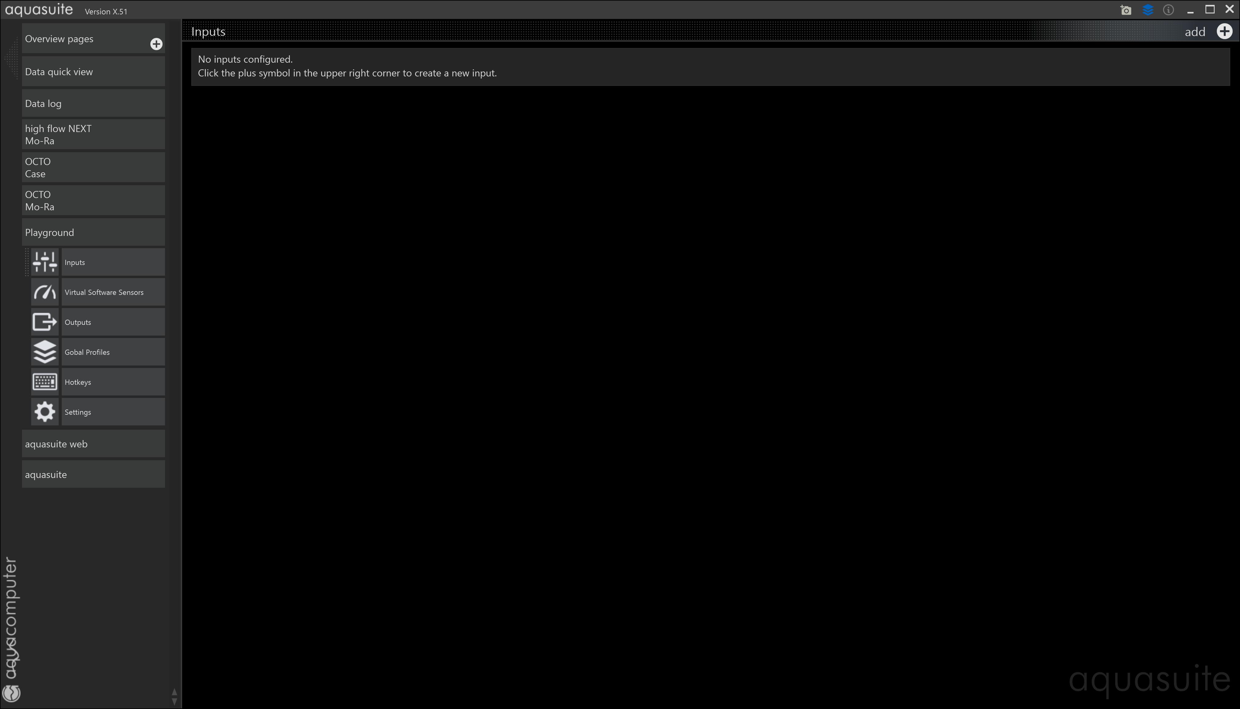

Donnerstag, 17. März 2022, 08:48
this is working in the x51.

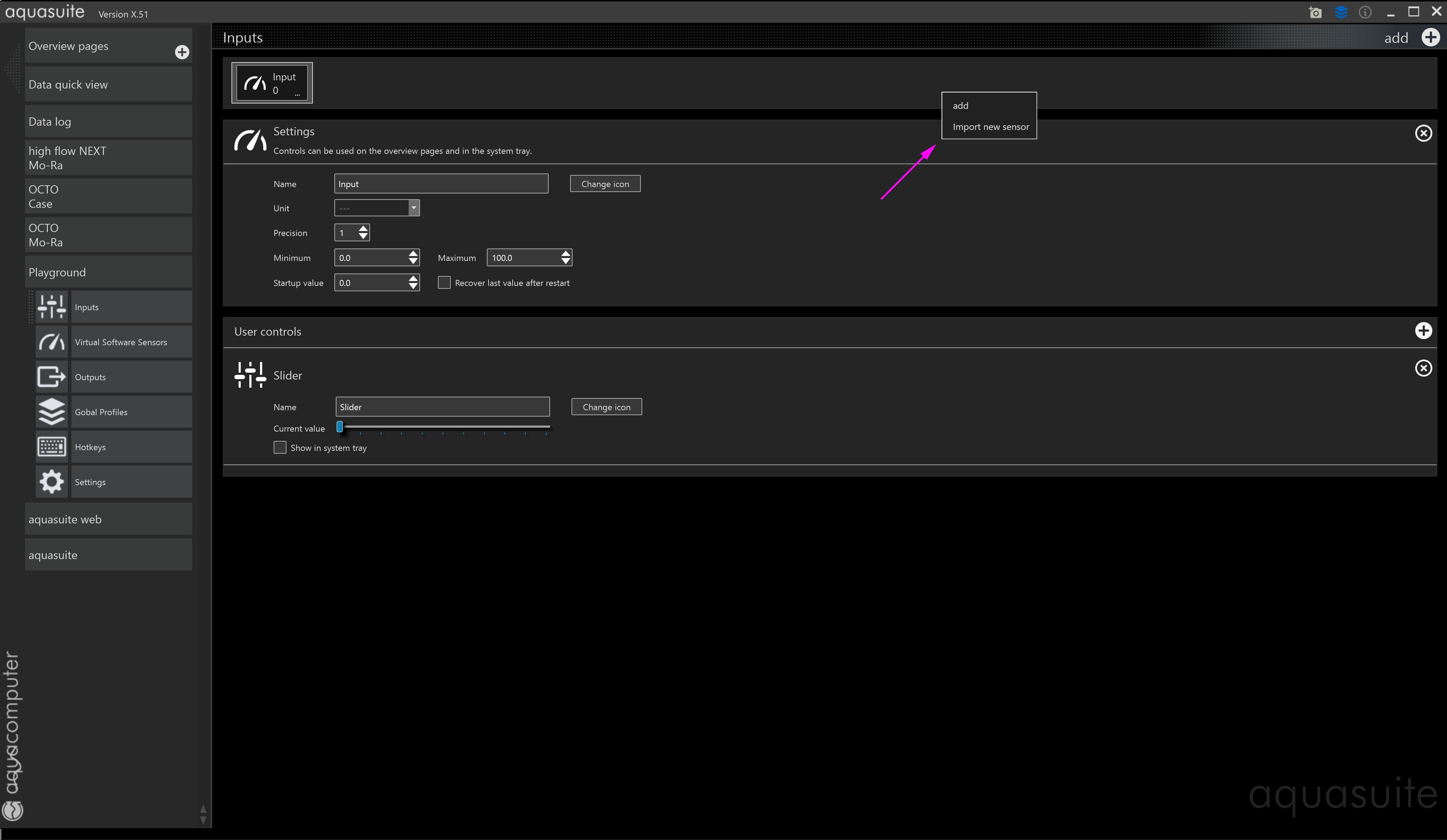

Donnerstag, 17. März 2022, 12:33
How does one initiate the import process?
I use Right-Click on the Input-Sensor Bar, but that is not available if no sensor has yet been created with the Add function.
  • no Input-Sensor, no place to Right-Click to initiate Import (0_input.jpg)
  • once one sensor is added, right click on Sensor-Bar allows import (1_input.jpg)
