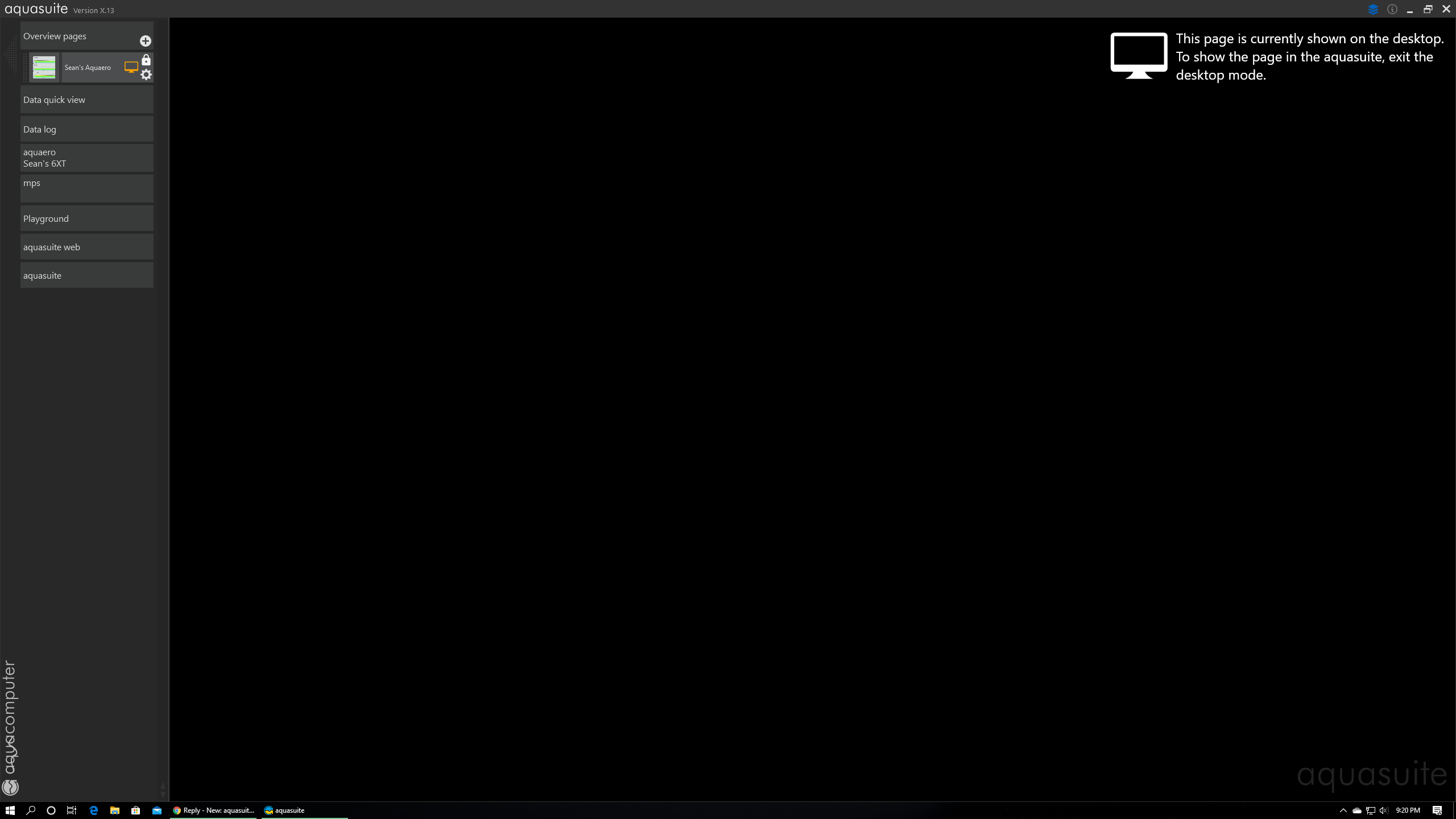

Having something on my system that has changed from X12 to X13.
I run 2 monitors and when I reboot my system and Aquasuite starts I have it set to load my main overview page.
In X12 this worked normal but in X13 it is opening the main page but at the same time it is putting it in desktop mode.
Not really a fan of that behavior and wondered if there is some new setting somewhere to change this? I don't see anything.
Mittwoch, 11. März 2020, 04:41
You mean it is opening in the Desktop editing mode in the aquasuite?
sultan.of.swing
Mittwoch, 11. März 2020, 05:21
No it is opening it in the mode where it pops out your page from aquasuite instead of it having the page in aquasuite itself.
Like this
»sultan.of.swing« hat folgendes Bild angehängt:
Mittwoch, 11. März 2020, 06:07
Apologies, but I am not certain what having the page "IN" aquasuite means.
Let me try two suggestions that hopefully may help.
Assuming you want the display page to open on the desktop when you start aquasuite, make sure the "Load page automatically" option is selected on the Display page's configuration panel.
You may also want to set aquasuite to minimize at startup.
But if what you want is the Display page editing mode to not look like the Desktop (you picture), then deselect the page icon that is orange and make it white for another editing mode.
Sorry if I am not getting your issue.

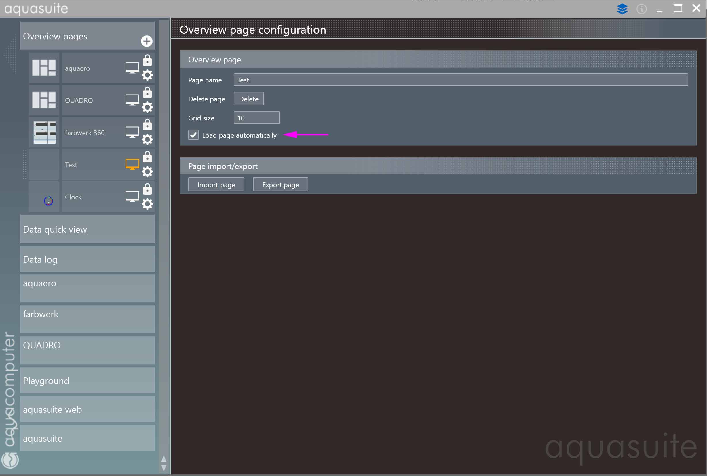

sultan.of.swing
Mittwoch, 11. März 2020, 06:29
[attach]7280[/attach]
You can have the page in the aquasuite software or on the desktop if you click the little orange computer symbol.
The problem is when aquasuite starts up with the X13 version it starts up in "desktop" mode.
Not sure why it's hard to explain but it's not supposed to do this.
X12 opened like the first picture.
X13 opens like the second picture requiring me to have to take it out of "desktop" mode
»sultan.of.swing« hat folgende Bilder angehängt:
Dieser Beitrag wurde bereits 1 mal editiert, zuletzt von »sultan.of.swing« (11. März 2020, 06:30)
Mittwoch, 11. März 2020, 14:37
For me, the aquasuite saves the "Desktop" mode status on exiting aquasuite.
If the Monitor icon is selected (orange) on exiting aquasuite, then that is the state on restart.
Conversely, if the Monitor icon is deselected (white) on exiting aquasuite, then that is the state on restart.
