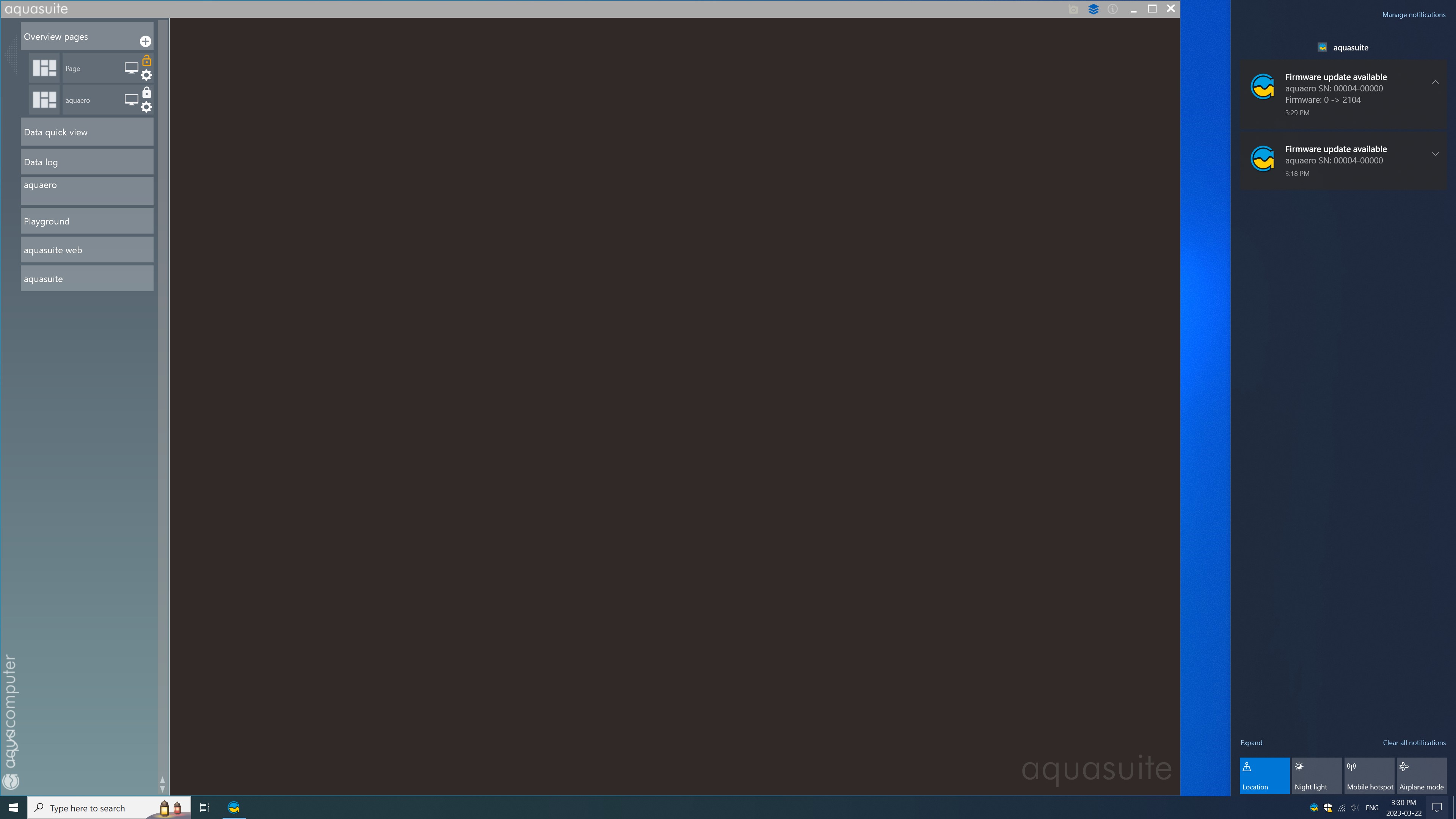

This only started happening after updating to X67. Fresh install of both, windows 10 and aquasuite, reinstalled both windows and aquasuite # of times, but randomly I'm keep getting this msg." Firmware Update Available" but in fact there isn't any Aquaero.jpg
If I put my PC to sleep which I do most times, upon waking up all its works fine, It only happens after turning PC off and then powering back ON.
It shows "service is installed. Service is running", but some of the fans that supposed to be off are spinning, so what I do is as admin I stop and restart services then it works, but again randomly after powering PC off then powering back ON the same thing happens.
For a moment I thought maybe my windows firewall blocking the service so I added aquasuite exe. to exclusion and it seem to work, but only for short time and started again.
Any of you guys experienced this?

Dundys
Mittwoch, 22. März 2023, 23:05
I don't know if that did it, but so far, for now seems that disabling windows fast start up fixed it. Also I left services start delay to default 5 seconds.

Dundys
Freitag, 24. März 2023, 06:04
I guess I spoke to soon, issue reacquired again, but I think I might have found it something else that might be the culprit. Once I am sure I will report back.

Dundys
Freitag, 24. März 2023, 15:02
I am a bit surprised that no one had suggestions, so Its fair to assume that no one is dealing with similar issue, but Its working now. Few additional tests and I found very weird cause of it, but it works now.
Freitag, 24. März 2023, 15:18
What was the cause?

Dundys
Samstag, 25. März 2023, 16:30
What was the cause?
Sorry for late response. As I mentioned, Its weird issue and I cant even pin point which driver(s) or windows services causing it, but here is the fix at least for now. I have 2 identical Win10 Pro installs, but one is on Samsung 860 Pro Sata 3 and the other on FIrecuda 530 2TB.
The 860 is my test windows so I only switch boot via Bios. Firecuda 530 is crazy fast at loading OS, much faster then 860 Pro and after going through # of tries and boots I know this when windows loading unto 860 Pro aquasuite loads first before anything else, but 3-4 seconds later loads ESET, hwifo and everything else. At this point aquasuite services start is delayed to 3 seconds, also my windows fast start up is disabled and with this settings there is no issues all works good every time.
With Firecuda 530 everything loads so fast that even thou aquasuite loads first, everything else loads literally at the same time. With aquasuite services delayed between 3-8 seconds drivers are colliding/crashing and nothing shows in event logs, Its all clear that's why is hard to pin point whether is windows itself, security suite or wherever that is, but setting star delay to 10 seconds, but also disabling windows fast start up making all work as it should, even with windows fast start up enable and 10 seconds services delay something crashes, so fast start up needs to be disabled.
I have # of Firecuda 530's 3x 4TB and 2x 2TB for storage and OS and I was Samsung fanboy for decades, but Firecudas 530s are something else, love them for the speed and the endurance is beyond exceptional. Anyways its weird, but works for now.

Samstag, 25. März 2023, 16:40
Windows fast boot is a suspend to disk and not a new boot, therefore it keeps all the problems you had before shutdown, if fast boot is enabled you can only really reboot the computer by restarting, shutdown leads to suspend to disk.
Dundys
Samstag, 25. März 2023, 16:53
YAh I have tested # of times when with fast start up ON and Off and how and what is loaded. Few times with fast start up ON after shouting windows down then powering back on, some apps didn't close totally and would act strange upon boot, but there where only few times when that happen. I have disabled fast start up long time ago, no need with today's fast drives, but this time, because my 2 win 10 on different drives are on one PC I left it enabled + fast drive, that combination not working as it should with aquasuite unless you tweak it a bit :)
