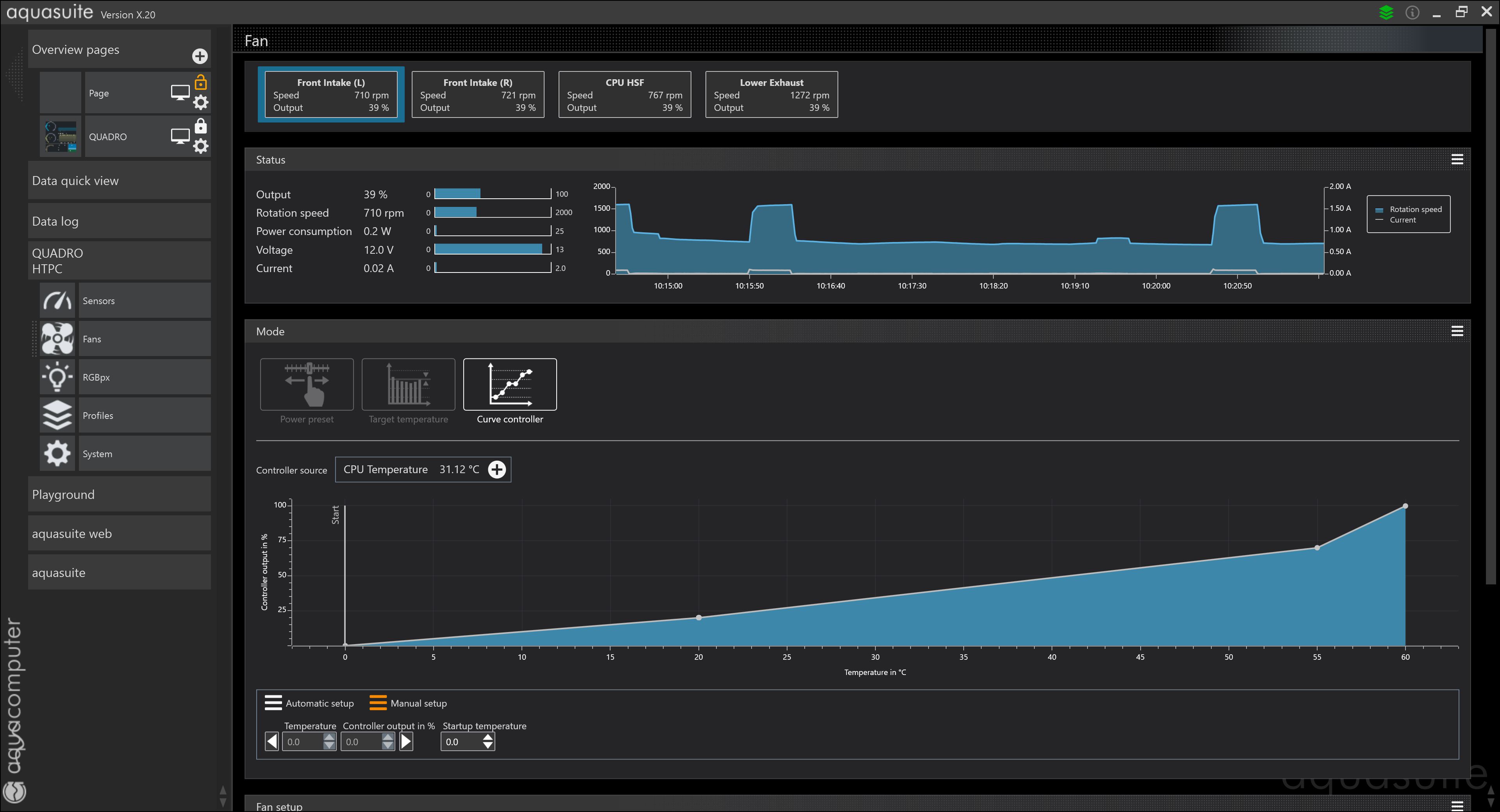

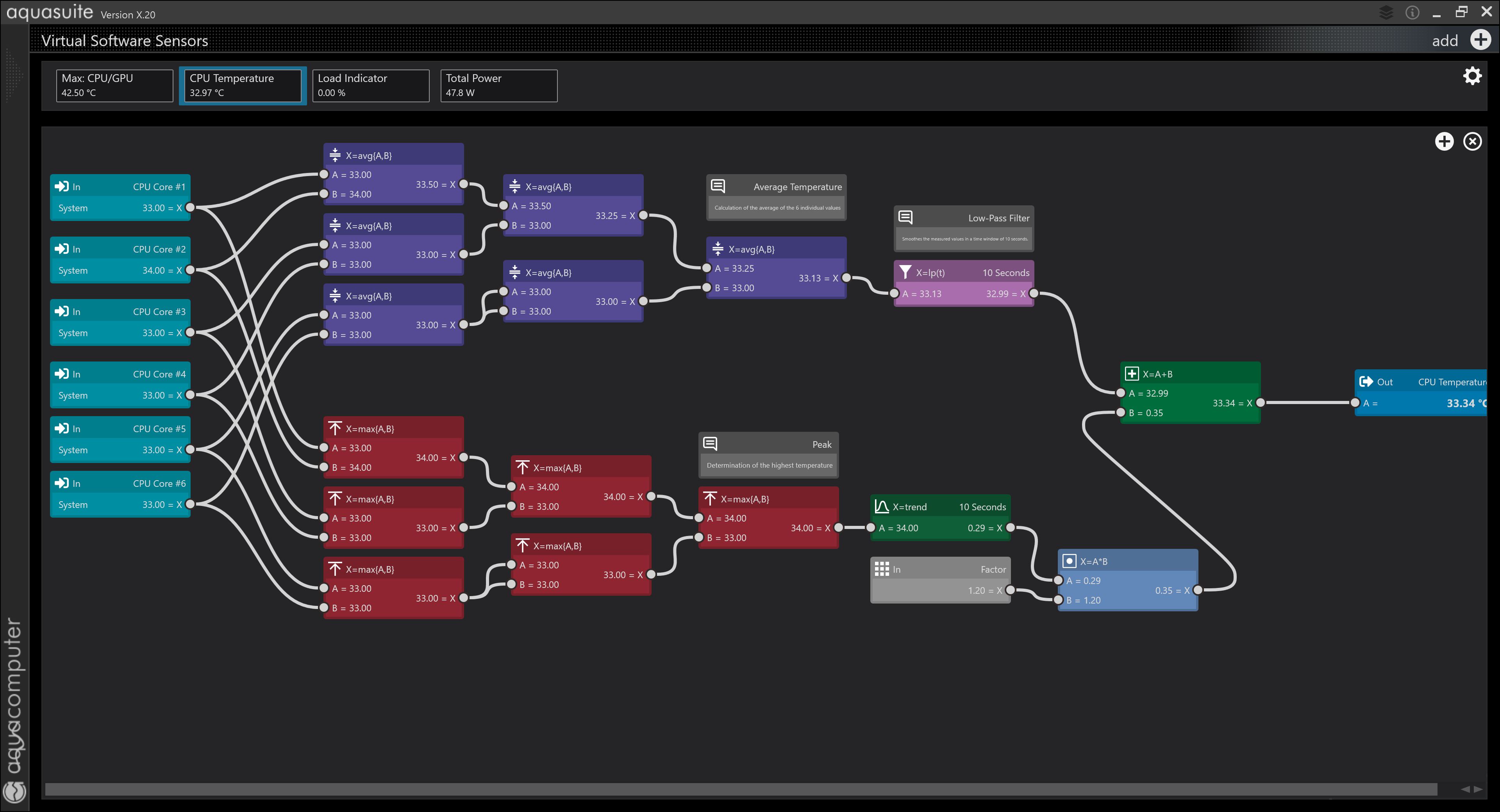

SpinCykle
Samstag, 30. Mai 2020, 22:20
Hello everyone!
I'm trying to figure out if my "problem" is user error or an actual bug in X.20.
My setup is an air cooled build (5 pwm fans total, 2 intake - 2 CPU - 1 Exhaust) and a Quadro controller. The Quadro controller has 1 temperature sensor connected to monitor ambient case temperature.
Aquasite X.20 has 4 global profiles set and my Quadro has 4 profiles (Silent/Standard/Performance/Max). I'm using a "Load Indicator", virtual sensor built in the playground to automatically switch my global profiles.
Here is my problem. Fan curve profiles 2, 3, and 4 on my Quadro are being over written by profile 1 at random. Everything will be running well, switching between profiles and than I'll noticed it's not functioning properly. I'll look at my Quadro profiles and all 4 fan curve profiles are profile number 1.
Does anyone know why this is happnening? Any help would be greatly appreciated.
My profile logic:
Global 1 = Quadro 1 (Silent) when virtual sensor value = 0%
Global 2 = Quadro 2 (Standard) when virtual sensor value = 25%
Global 3 = Quadro 3 (Performance) when virtual sensor value = 50%
Global 4 = Quadro 4 (Max 100%) when virtual sensor value = 75%

Undermoose
I never thought about that, but it looks like you might have a valid point.
Samstag, 6. Juni 2020, 22:48
Hello everyone!
My profile logic:
I snooped around and saw no logs... this is just about the first time I've ever seen a high tech have nothing.
I guess when you make a decent product it's easy to overlook some short comings. I hope they're listening to feature requests!
4 splitty 4's are in place and everything works, no more odd ball wiring faults so far.
8)

k2viper
Dienstag, 23. Juni 2020, 09:57
Finally i had to clear reinstall aquasuite, but perhaps it was not an update problem. One of my newly created Playground sensors caused Aqua Computer service to fail at its startup. Removing this failing Virtual software sensor from Settings_VirtualSoftwareSensor.xml helped, but I had to re-create all other working sensors in Playground.
