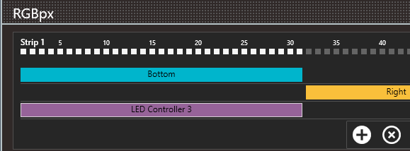

And I wanted to make a feature request: is there a possibility that in the future we'll have an ability to turn off the particular "LED mode" on the strip (attached a picture so you can understand what I mean), so we can have a few sets of effects attached to the same leds and we can switch them based on the mood? I mean right now we can add the new mode to the same LEDs but the effects are not applied.. Seems like an easy-to-implement feature (and rather basic one!)Thanks in advance!
with a farbwerk 360 you can use this, with the profiles.
You need to save the setting to the profile you are using at boot time. Otherwise the aquasuite will overwrite the settings with the stored ones after boot,

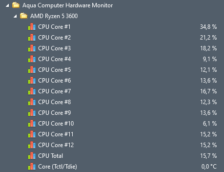

I just got the Quadro for fan control, but I'm facing a problem where it won't pick up the CPU temperature.
Other programs don't seem to have this problem, and only fix is to restart my computer.
CPU: Ryzen 5 3600
Motherboard: B450 TOMAHAWK

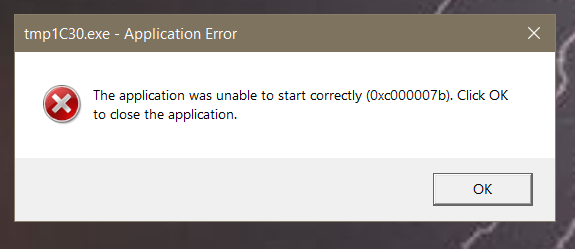

I get this error wem i try to install the software
»SMOKE« hat folgendes Bild angehängt:
Dienstag, 5. Mai 2020, 07:17
Try to close Rivatuner and RTSS.
maybe this is related to this: https://afkgaming.com/articles/esports/B…en-After-Update
try to disable Vanguard
Don't have Vanguard installed, so it can't be that.
