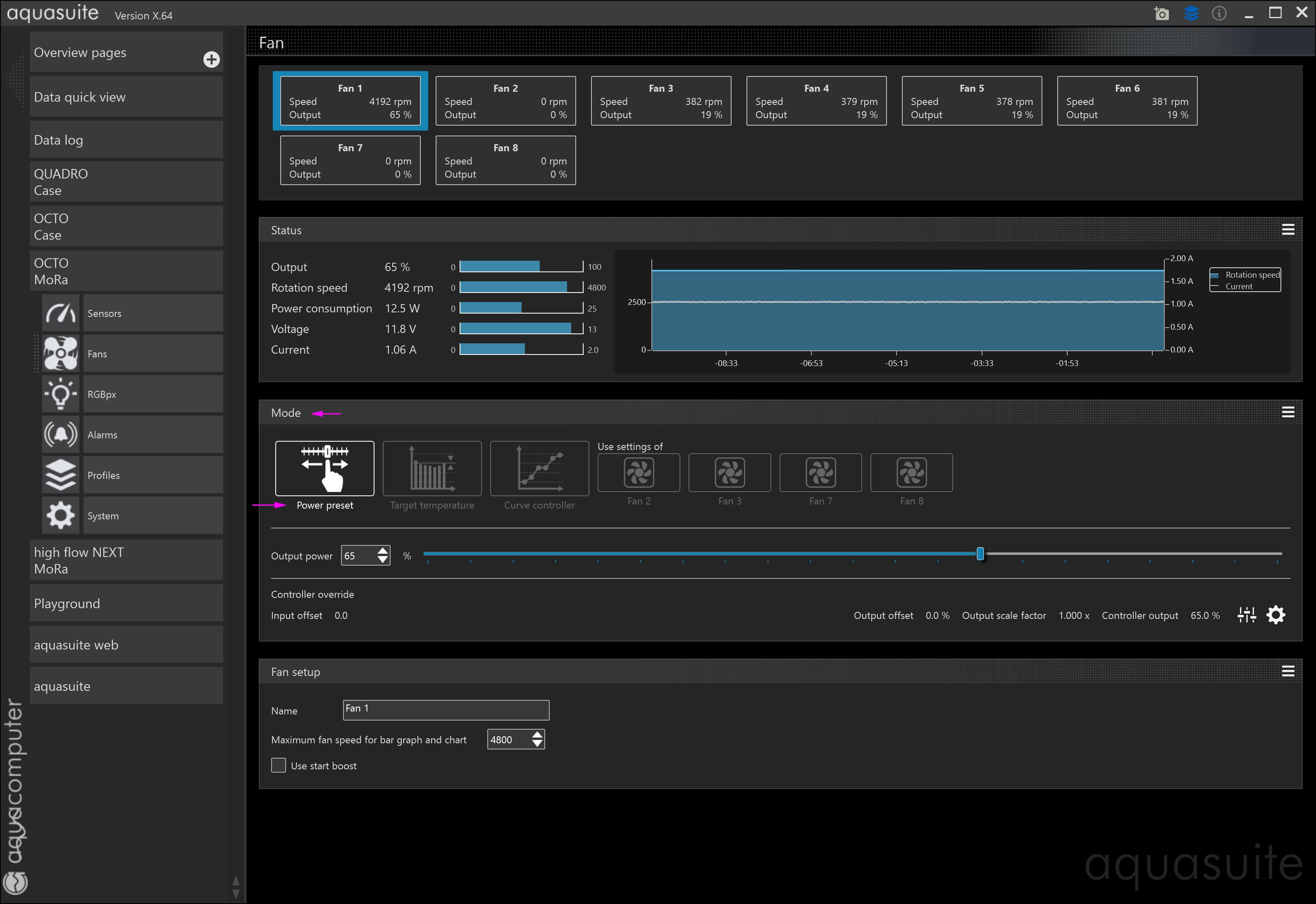

Question. I just started my system and the fans are connected to the AQ6 and running at 100%. I need to bring down the fan speed a bit until I have the time to adjust and setup the system. Can I just set the fans to a fixed speed such as 50% in Aquasuite? Also, can this be done with the pumps, too? The AQ is connected via USB for now. How is this done?
Thanks...Al
Yes, if the aquaero is controlling your fans, select the port, choose 'Power preset', then drag the slider to the output level you want.
You can do that for every port, or you can have other ports follow the a port by selecting 'Use settings of'.
Thanks again. I figured it out. The software was acting bugging and not taking my adjustments. All is good with the fans.
