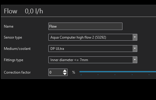

jeudi 9 mars 2023, 16:30
You cant setup calibration values for High Flow Next Sensors.
This is for all sensors that are directly connected to a device like the octo, quadro ....
The new calibration values are selected when you select the type of flow sensor in the Sensor tab of each device.
Remayz
jeudi 9 mars 2023, 17:11
damn, i just gained almost 20L/h. free upgrades lol
the DP Ultra / water drop down list, i wonder what to chose when we use a 3rd party coolant.
Methodical

[attach]10153[/attach]
That is good to know. I have 1 flow sensor connected via Octo. Will I get this option if I have the Octo connected to the AQ via an Aquabus connection.

Methodical
jeudi 9 mars 2023, 23:09
Do you get any other options in the drop down list?

Remayz
vendredi 10 mars 2023, 04:00
Nop, just those two. I don't suspect they'd go to the trouble to fine tune every coolant on the market. I don't even know what that does.. if it slightly changes flow depending on said fluid viscosity or whatever :p
