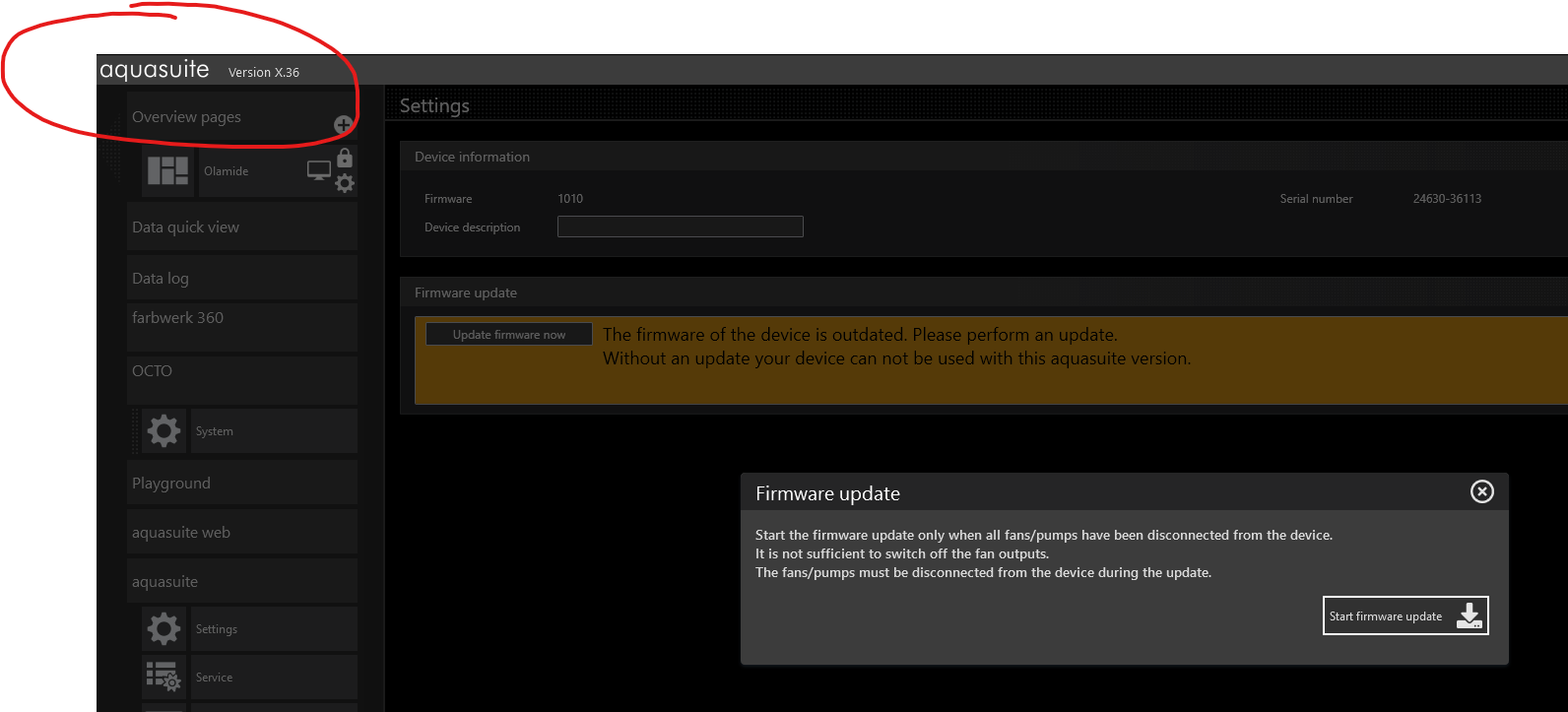

Yea.... that's a fail.

Arf, i'm on X35 if i don the update i will have to do that as well? that sucks! i will need to replug my pump on the mobo header to avoid overheating then

Really need to check why it's still shown.
You can ignore it, try to update anyway. If it doesn't work you can set the fans manual to 0 and try again.

I just updated without issue or having tu unplug, all good

One wonders why "It is not sufficient to switch off the fan outputs"?
Above posted while sebastian was posting, and not valid anymore.
For clarification: for maximum safety, we need to set fans to zero PRIOR to updating the aquasuite, in case a firmware update is required?
I believe not. Fans are fed by 12v power line, when the device itself is 5V powered. 5V stabilty is mandatory during the firmware update, so it is reasonable to disable e.g. RGBpx lights connected to device, but not fans.

Support keeps talking about the fans, maybe it is related to the PWM output?
None-the-less, I will set fan outputs to zero prior to any update to the aquasuite as a caution to prevent possible issues.
It would be helpful if the software engineers placed a reminder to zero fan power at the start of the aquasuite update process, not wait until the update is done, and we are at the firmware update, at which point it is moot.

The update can be done easily.
This message should actually have a different text. I therefore assume an error with the aquasuite update.
@OlamFam
install the software again with the installer from the download area.
It is not necessary to disconnect the fans from the device during the update.
This is valid even if a firmware update will be required after an aquasuite update?
Tuesday, January 26th 2021, 6:12pm
Yes. It's not needed to unplug the fans.
If any problems occur during the update we recommend to try again with only USB + Power connection.

Internally Initiated aquasuite update from X.31, with NO fan prep. Was shown the notice below for quadro update. Completed sans issues.
