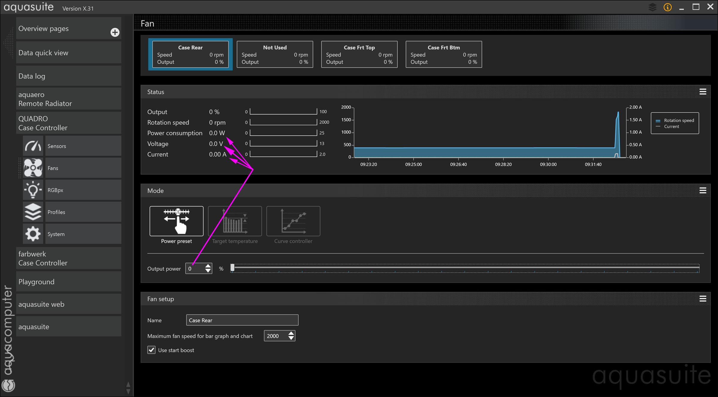

mardi 26 janvier 2021, 16:52
One wonders why "It is not sufficient to switch off the fan outputs"?
Above posted while sebastian was posting, and not valid anymore.
For clarification: for maximum safety, we need to set fans to zero PRIOR to updating the aquasuite, in case a firmware update is required?

k2viper
mardi 26 janvier 2021, 17:04
I believe not. Fans are fed by 12v power line, when the device itself is 5V powered. 5V stabilty is mandatory during the firmware update, so it is reasonable to disable e.g. RGBpx lights connected to device, but not fans.
mardi 26 janvier 2021, 17:18
Support keeps talking about the fans, maybe it is related to the PWM output?
None-the-less, I will set fan outputs to zero prior to any update to the aquasuite as a caution to prevent possible issues.
It would be helpful if the software engineers placed a reminder to zero fan power at the start of the aquasuite update process, not wait until the update is done, and we are at the firmware update, at which point it is moot.
