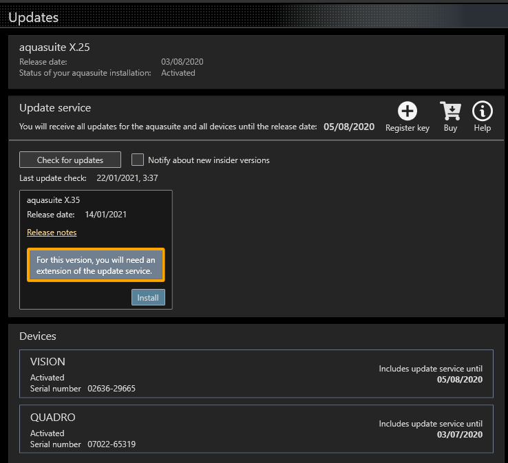

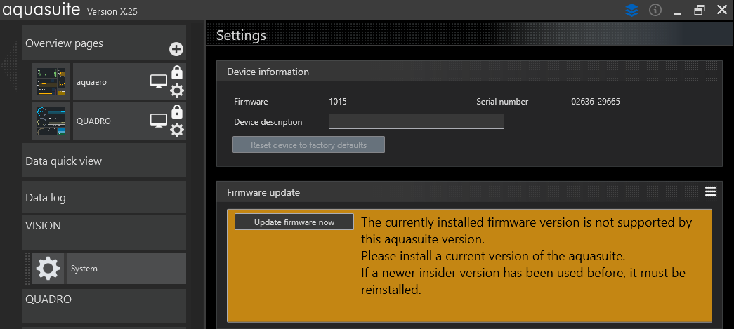

I run X.25 on QUADRO and VISION, I can not update VISION fw - I press update and it does nothing...
(it just offered an update from 22 to 25 I think... then the problem started.
Can you help?

Freitag, 22. Januar 2021, 07:12
You must use the aquasuite version with which the update was made.
The firmware is newer than supported by the aquasuite.
If you bought the device used you have to buy the update service to use the device because the device has already been used with a newer aquasuite.
https://licensing.aquacomputer.de/shop/aquasuite
