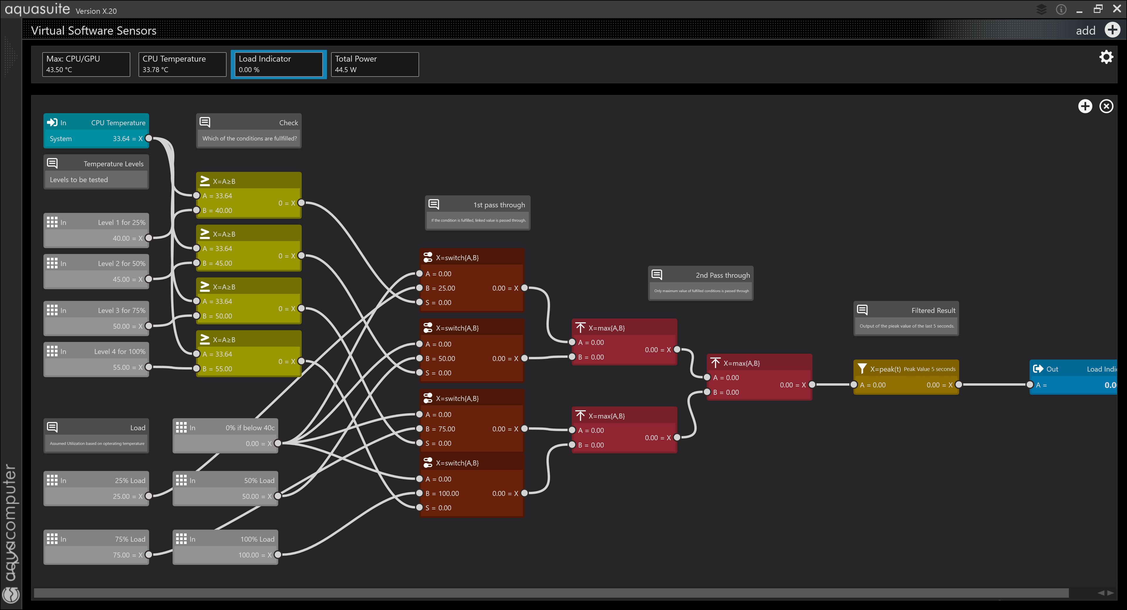

Hello everyone!
I'm trying to figure out if my "problem" is user error or an actual bug in X.20.
My setup is an air cooled build (5 pwm fans total, 2 intake - 2 CPU - 1 Exhaust) and a Quadro controller. The Quadro controller has 1 temperature sensor connected to monitor ambient case temperature.
Aquasite X.20 has 4 global profiles set and my Quadro has 4 profiles (Silent/Standard/Performance/Max). I'm using a "Load Indicator", virtual sensor built in the playground to automatically switch my global profiles.
Here is my problem. Fan curve profiles 2, 3, and 4 on my Quadro are being over written by profile 1 at random. Everything will be running well, switching between profiles and than I'll noticed it's not functioning properly. I'll look at my Quadro profiles and all 4 fan curve profiles are profile number 1.
Does anyone know why this is happnening? Any help would be greatly appreciated.
My profile logic:
Global 1 = Quadro 1 (Silent) when virtual sensor value = 0%
Global 2 = Quadro 2 (Standard) when virtual sensor value = 25%
Global 3 = Quadro 3 (Performance) when virtual sensor value = 50%
Global 4 = Quadro 4 (Max 100%) when virtual sensor value = 75%
»SpinCykle« hat folgende Dateien angehängt:

Undermoose
I never thought about that, but it looks like you might have a valid point.
Samstag, 6. Juni 2020, 22:48
Hello everyone!
My profile logic:
I snooped around and saw no logs... this is just about the first time I've ever seen a high tech have nothing.
I guess when you make a decent product it's easy to overlook some short comings. I hope they're listening to feature requests!
