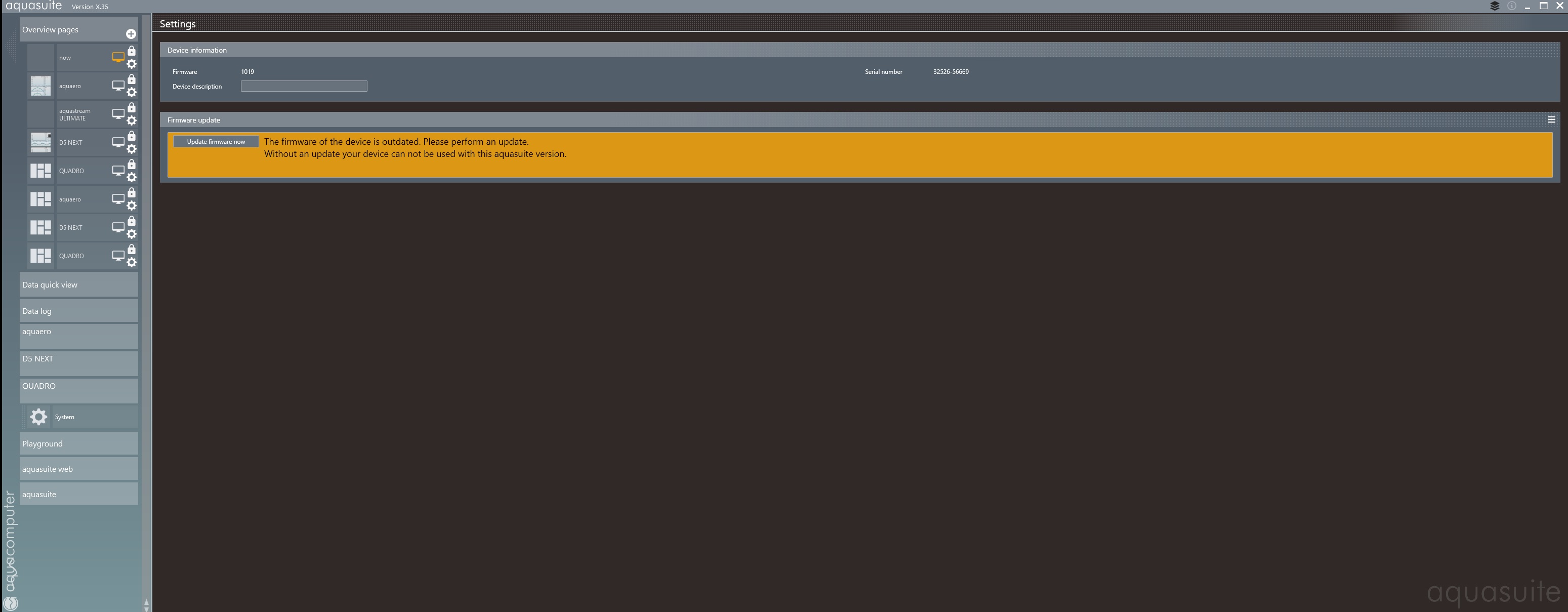

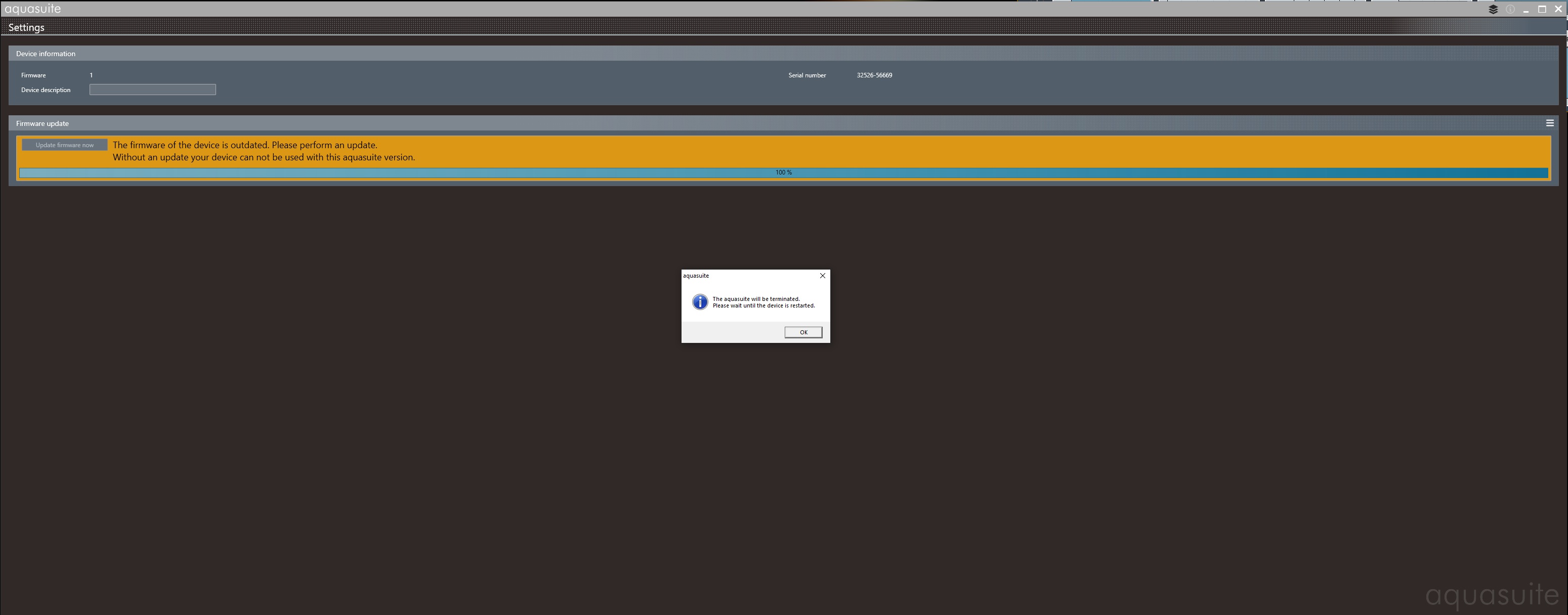

So I dig ot my quadro that will not take the flash. Unplug everything, direct usb connection with zero connected to USB other than the quardo, no fans plugged in to it. Says it flashed, service shuts down. tried rebooting, same outcome, power down and turn off power supply for 30 mins same outcome. it still comes back with the same firm ware saying it has to be updated to use with this version. I have to tell you this is really trying my patience. Id settle for a roll back to like a year ago when everything worked!!
OK figured it out, that was completely unnecessary. No need to disconnect all your other devices from USB but I already had fans disconnected.Will just have to put everything back on aquabus now.
Go to program files, program data and copy/save to different location aquasuite data.
Uninstall aquasuite. Delete old aqausuite settings and folder.
Launch aquasuite installer to new install.
after install is finished reboot
after reboot pull up quadro and install new firmware.
Shut down aquasuite
open program data and delete aquasuite data file and drag over old file saved which has all your hard work done in it.
reboot.
Comes back up and everything is there.
At least I know what I have to go though now when replacement OCTO gets here and Next flow meter.
Worst implementation and hoop jumping Ive seen with any app........EVER!

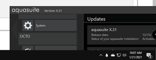

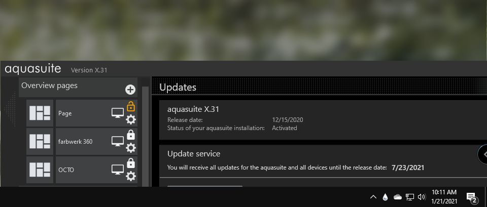

Help! I have had an Octo for about 2 months and just bought the Fabwerk, but I cannot get the Fabwerk to work because it says I need to update the firmware, but I cannot actually update the firmware in Aquasuite x31. I've tried to update my aquasuite to x35 and no matter how many times I download x35 from the site and install it, my aquasuite still shows up as x31 (and my update service for the Octo doesn't expire until 6/20/21). What am I doing wrong?

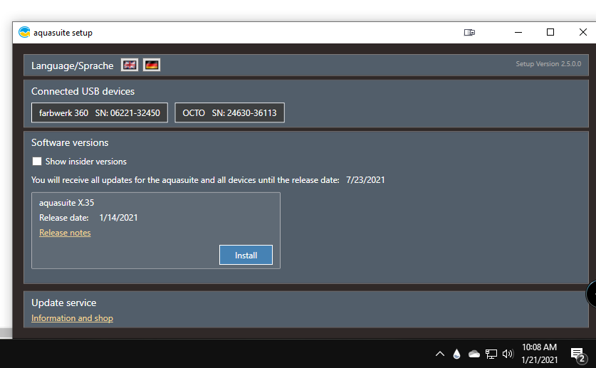

I am downloading the software from the download page. The installer identifies the version as x35, but when after I reboot, x31 is what shows up in the software. I even uninstalled aquasuite from my computer and then installed it using the software page's download, but still x31.
Donnerstag, 21. Januar 2021, 16:03
Tested, download and install is X35
OlamFam
Donnerstag, 21. Januar 2021, 16:14
Let me show exactly what is happening. I am attaching snippets of me downloading and installing the software, with time stamps, so you can see that even after installing from the website and rebooting at the installer prompt, the suite still shows x31.

Donnerstag, 21. Januar 2021, 18:44
Check the path of the link that aquasuite has created, normally it should be this path:
"C:\Program Files\aquasuite".
Uninstall the aquasuite and search everywhere if you have installed the aquasuite in a different path, so just search for "aquasuite.exe".
Delete all old data, including the folder:
"C:\ProgramData\aquasuite-data".
Install the aquasuite again.
