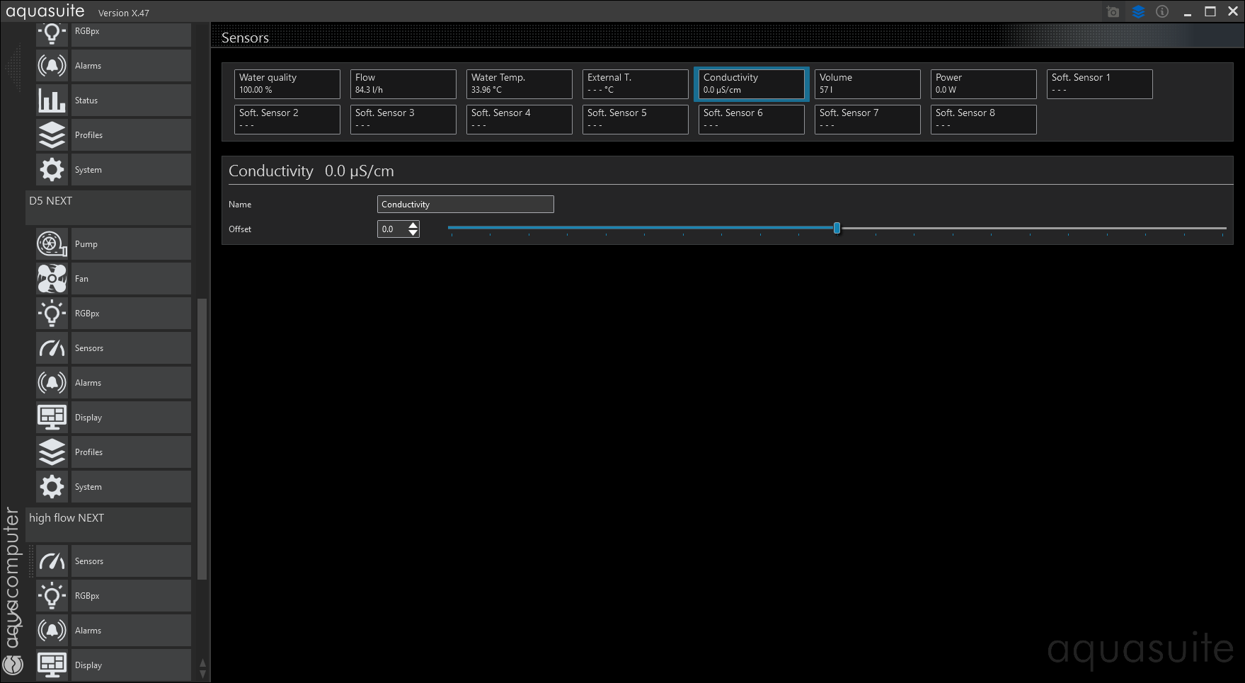

I have an High Flow Next since August 2021 and it showing the conductivity reading 0.0 µS/cm since the beggining, im using DP Ultra clear as coolant, is the High Flow Next broken?
DaLiu has attached the following images:
This post has been edited 3 times, last edit by "DaLiu" (Nov 28th 2021, 4:21pm)
