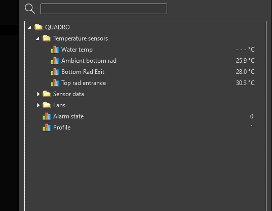

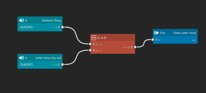

I am using a Quadro with the new X.35 update. The new update removed my previous virtual sensors, which is inconvenient. While trying to recreate my virtual sensors, the Playground is not reporting the values given by the temperature sensors attached to the Quadro. I've attached screenshots, the Quadro is putting out temperature values, but Playground is outputting blank values when I try to have them as Input.
