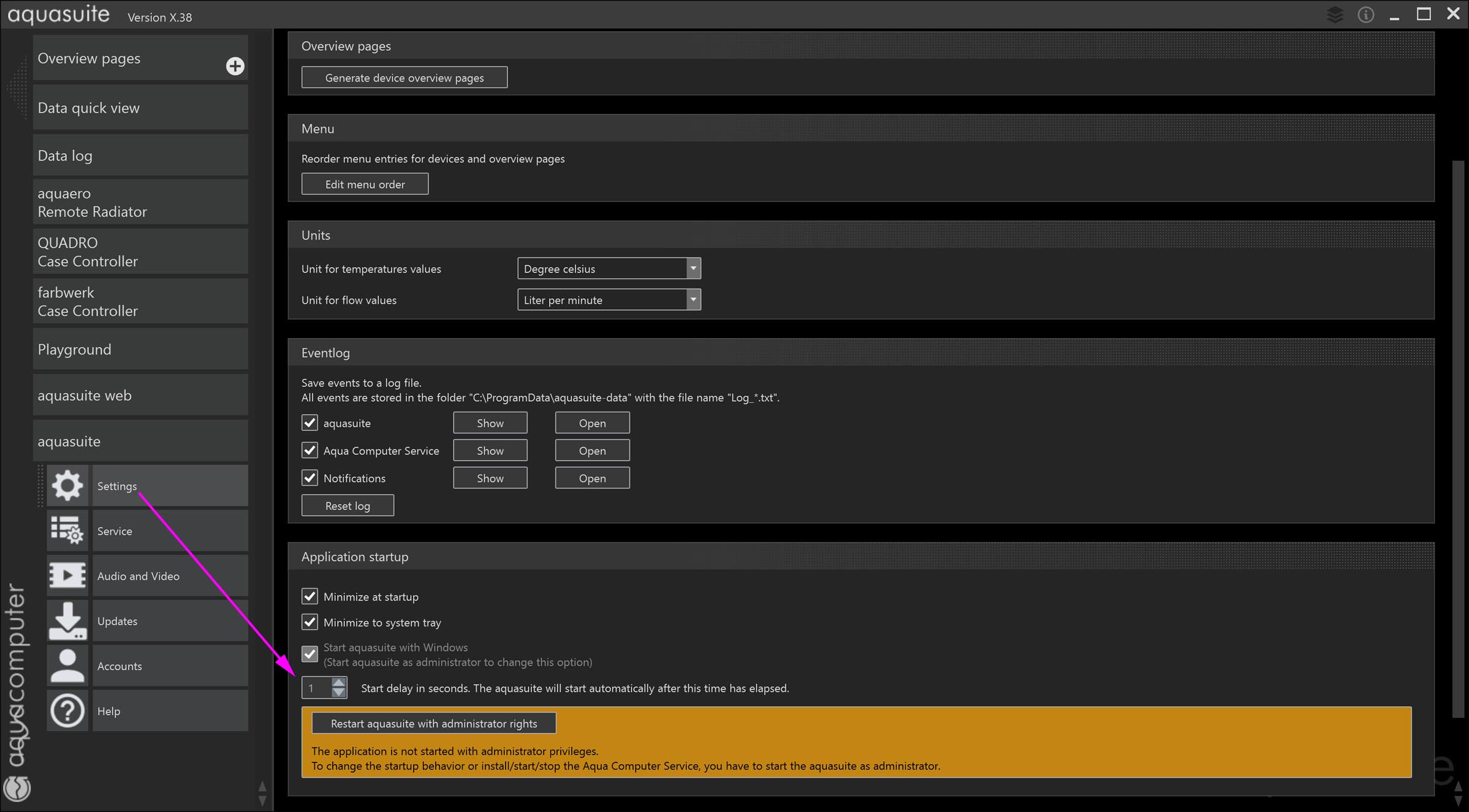

Have you tried increasing the 'Start delay' by a few seconds? start_delay.jpg
Lowbaka
Freitag, 5. März 2021, 14:29
Thanks for this tips but I don't think this will resolve the problem.
It appen on the very begining of the PC boot, before than windows (and the BIOS) start.
The problem come from more the OCTO than aquasuite.

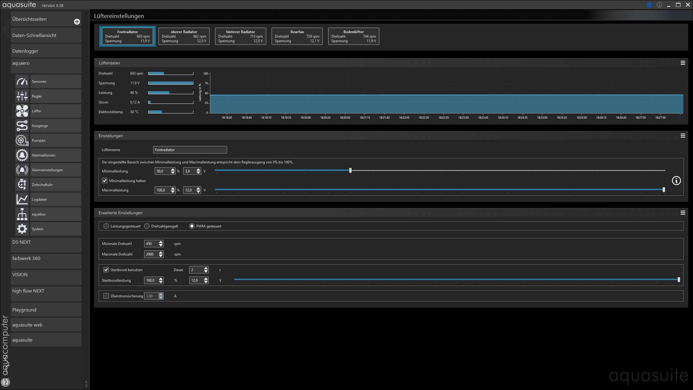

What do your fan settings look like?
A picture could be helpful.

»Dundys« hat folgendes Bild angehängt:
Freitag, 5. März 2021, 18:54
I just turned off the startup boost, unfamiliar silence when booting the computer.
The software can't be the only problem either.
Do you have a HDD or SSD on which you can install a naked Windows to see if the problem then also exists?
There must be a reason somewhere.

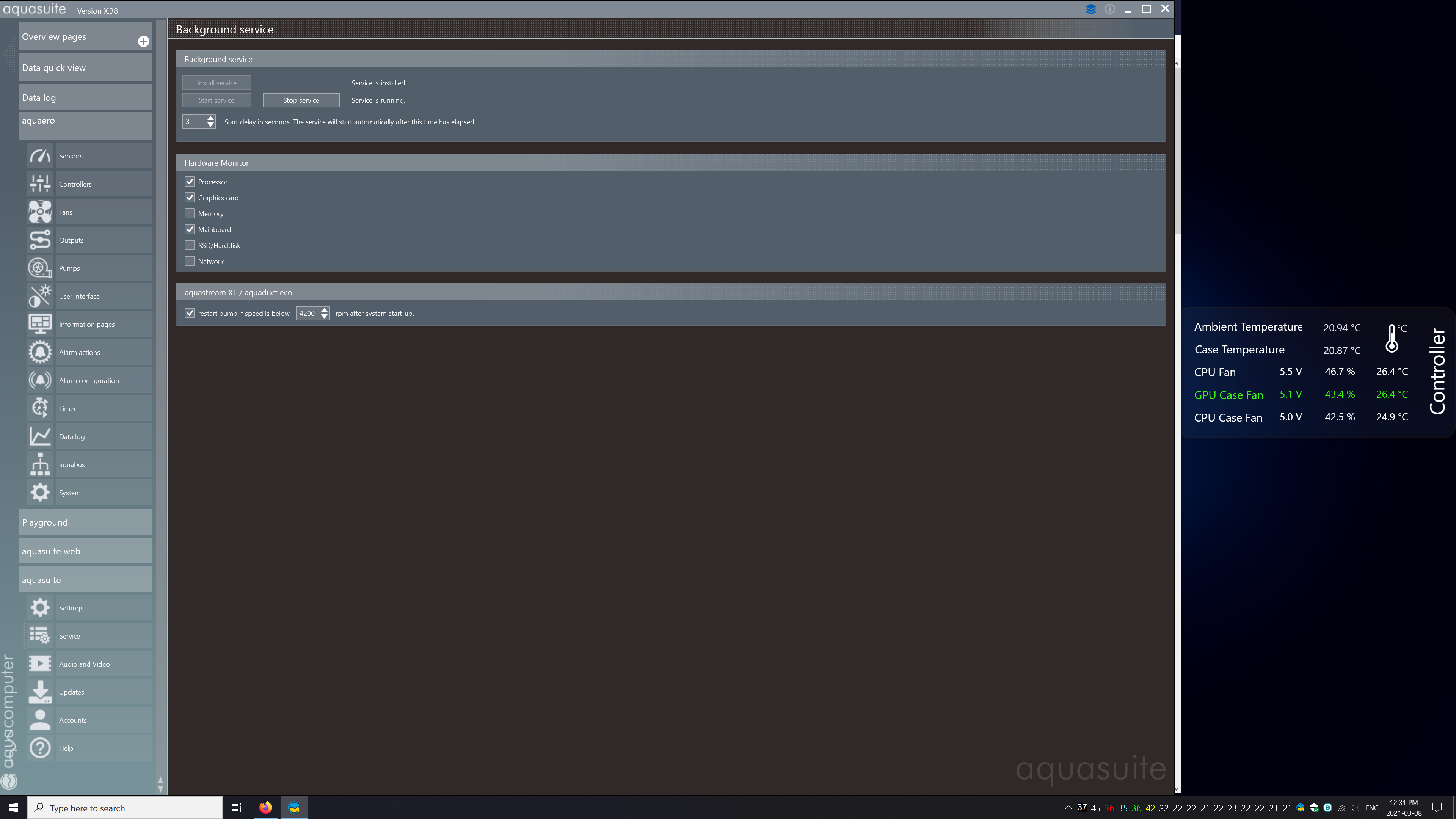

Montag, 8. März 2021, 13:47
Without Aquasuite everything is ok
Disable the aquasuite hardware monitor.

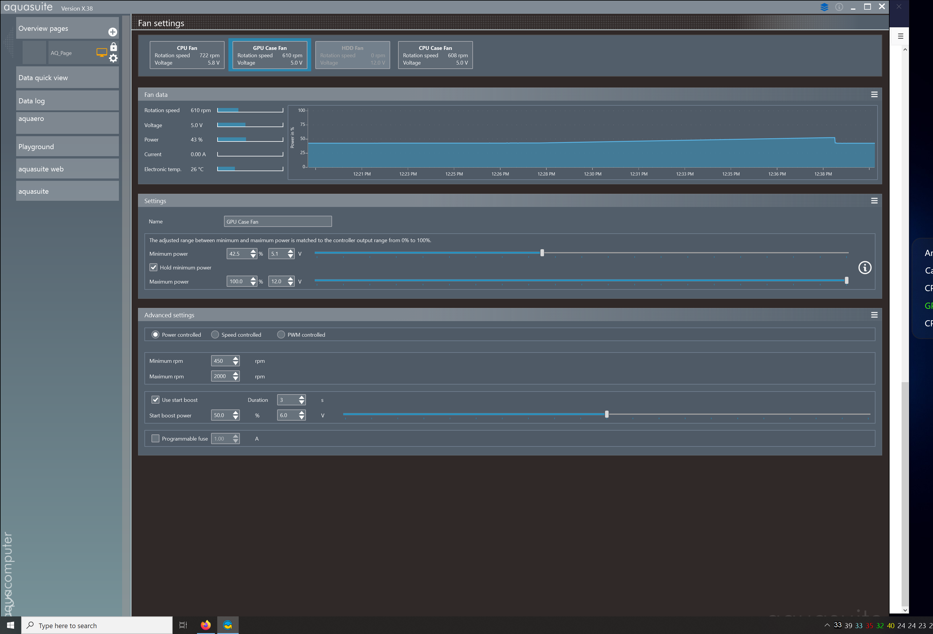

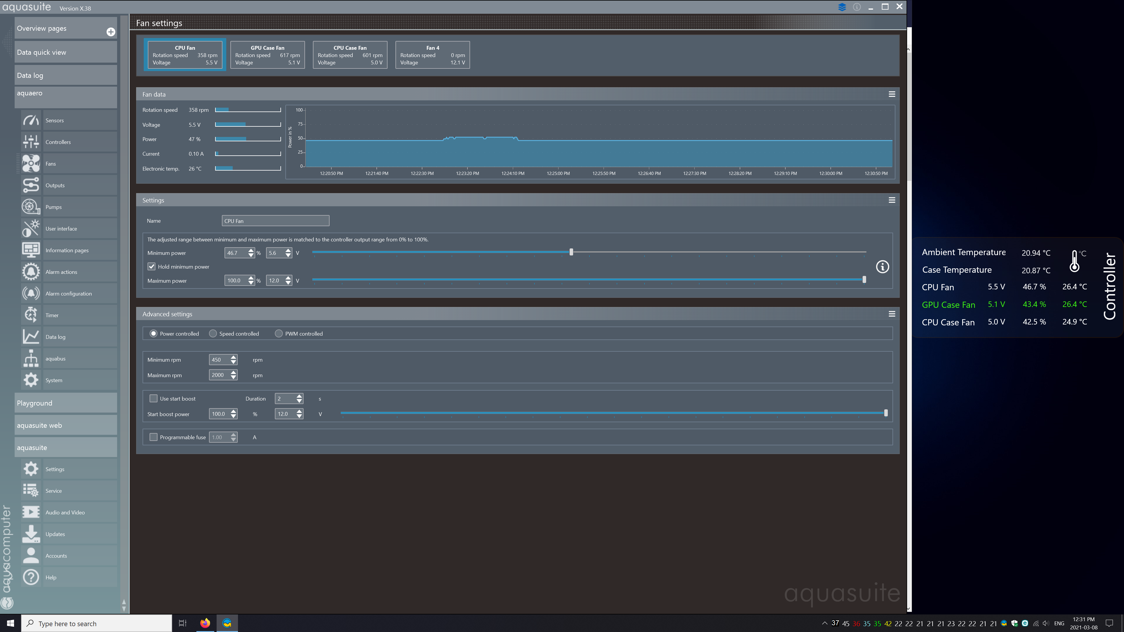

Does any one have any idea what I'm up against?
Here is summary.. Prior to X38, specifically X36 was working virtually trouble free, regardless of whether was updated via aquasuite or clean install. Also it didn't matter whether was installed on clean windows or with updates and all apps installed.Now! X38... Services are delayed 3 sec. "start boost" off and while I will put my stem in sleep mode and bring it back within 4-5 min all working as it should, but pass 5 minutes and especially CPU fans are going up 100% for about 10-15 seconds.
X36 didn't behaved that way, but no answer from aquacomputer so what is happening, It can't be my hardware obviously because X36 worked just fine!
