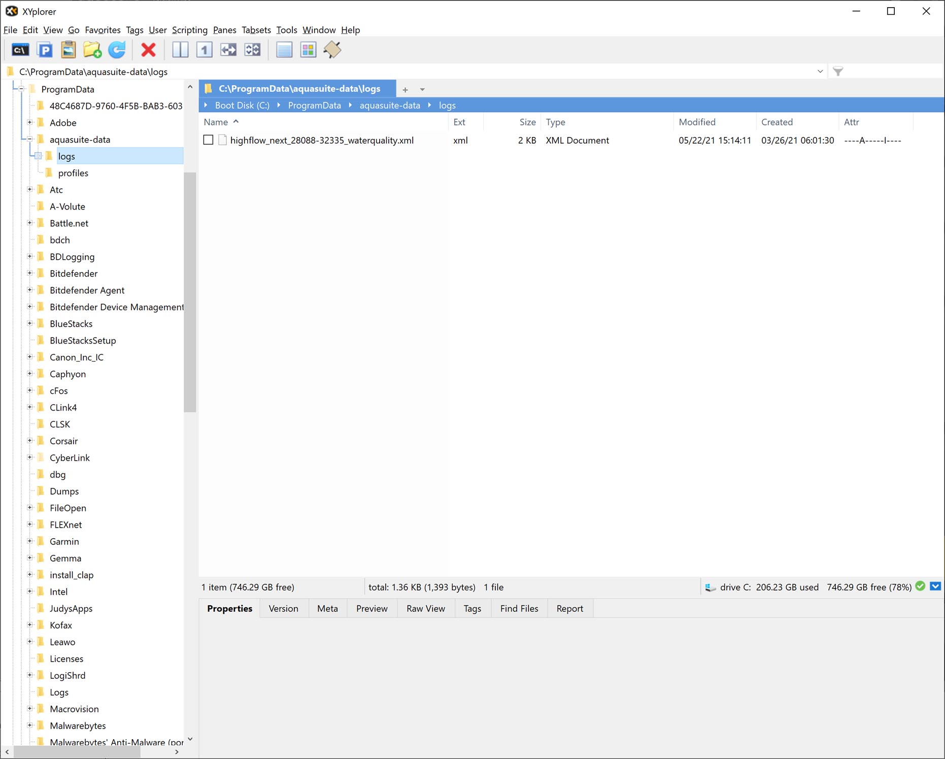

I accidentally updated to X39 yesterday and am also seeing auto-shutdowns throughout the day.
aquasuite logging activated (a-suite_set.jpg)
but nothing in folder (a-suite_logs.jpg)
Windows event log attached:

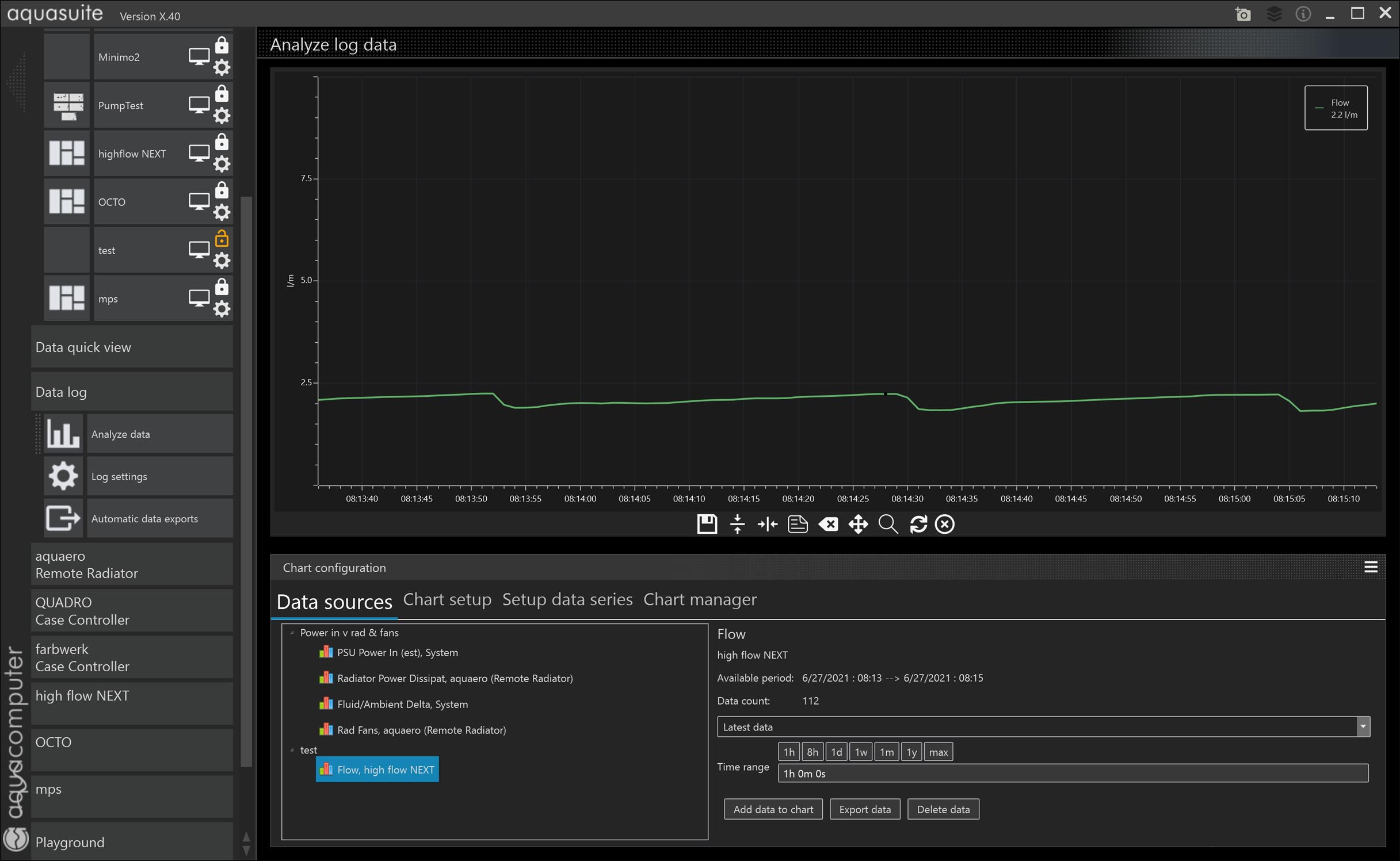

Sonntag, 27. Juni 2021, 15:43
X.40 crash:
  • create a data log that includes a High Flow NEXT sensor with flow rate value in l/m (log_data.jpg)
  • analyze data to create chart (analyze_data.jpg)
  • add Log data chart in overview page, and select the Analyze data chart containing Flow @ l/m (display_data.jpg)
  • boom
If the flow rate unit is set to l/h, the aquasuite does NOT crash.
I did not test with gallons, nor with other flow sensors.
EDIT: I tested with a High Flow USB flow sensor and the results were the same as with the High Flow Next flow sensor.
Dieser Beitrag wurde bereits 1 mal editiert, zuletzt von »InfoSeeker« (28. Juni 2021, 01:18)
