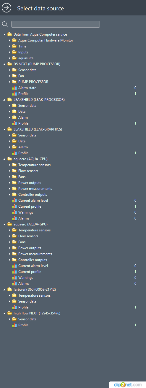

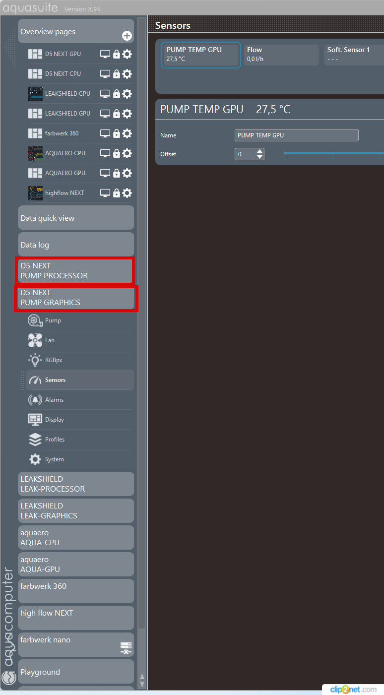

After updating to aquasuite X.94, the second pump entry, PUMP GRAPHICS, stopped appearing in the data source list. The pump itself is still shown in the device list and can be monitored and controlled normally.
I noticed the problem when I tried to add a virtual/software temperature sensor. Before updating to X.94, both pump entries were displayed correctly and everything worked as expected.
Maybe someone has a solution to the problem?

Mittwoch, 29. Juli 2026, 09:17
That happens when a specific part of the USB communication crashes. The pump itself is still accessible but software sensors and some other things will not work anymore. A power cycle will very likely fix that.
